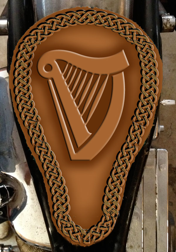

I have the seat pan ready to cover, here's a photoshop mockup of the design
I've re-drawn it, cleaned it up and have the pattern ready to tool up on some leather when it arrives (going with 8/9oz so I can cut it deep and have it hold up) I have a design for toolbag drawn up, working on saddlebag designs too.
