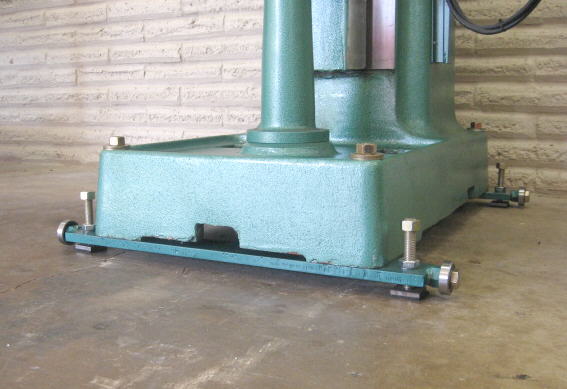

    use standard non locking casters and install 1/2 or bigger long bolts in legs , when in space you want unscrew bolt to raise bench off casters . nice the way you can use the bolts to level the bench Click image for larger version.

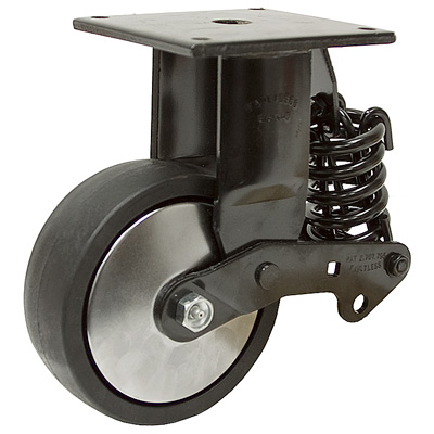

    those casters are a little lite duty for a big welding table , https://www.surpluscenter.com/item.a...catname=wheelsClick image for larger version.

ID:	6852 also nice welding cart caster 1.99 each . i just orders 24 of them https://www.surpluscenter.com/Item.asp?item=1-3191Click image for larger version.

    those casters with the shock absorber are nice...1200 lb capacity each. The ones I have are only 330 lb cap. each....equates to 1320 lbs total load, on my small table. I guess depends on what one expects the table to have to support. If very heavy duty, all materials, casters and up, will have to be beefed up. Maybe a 3/8" top instead of 1/4". Things to consider, along with the budget.
    Thank you for sending the surplus center links. I'll have to wander the site to see what they have.
    ken
