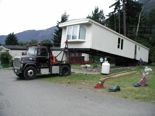

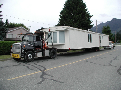

    Interesting project. I guess I never really thought about the suspension requirements on a mobile home.
    - Dr. AR Dykes
    Need to build a mobile home DolleyClick image for larger version.

    Lol!!! If I did that then I would not have the welding business! For some reason all the manufacturers build different tongues with different mounting locations. You would think they would all go to some type of industry standard to lower their cost.
