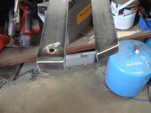

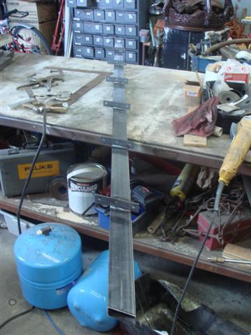

    Here is a ladder for an extra tall bunk bed. I wanted something that is a cross between stairs and a ladder, something like what the Navy calls ladders in ships. I also want it to be able to swing up out of the way when not needed. For comfort with bare feet a lil carpet on the treads, too.

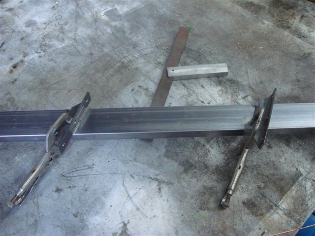

    Cut up some 1" angle, drill some holes and chamfer the corners so they line up with the 1x2 tubing. Clamp and tack at 22.5°.
ID:	6758   Click image for larger version.
ID:	6759   Click image for larger version.

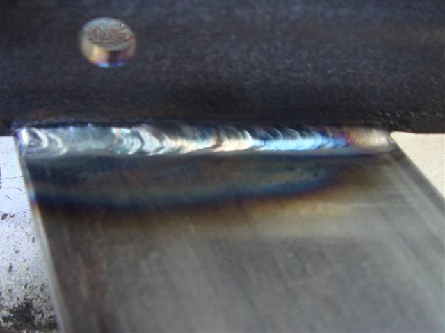

    Ok, then weld everything up.
ID:	6761 Click image for larger version.

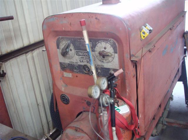

    Now I got the hang of it.
    Rockin' it old skool with a Lincoln Pipeliner and a scratch start TIG setup.

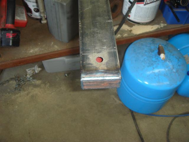

    Cap up the ends.
ID:	6764 Click image for larger version.

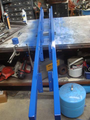

    Lightbulb
    Paint them up.

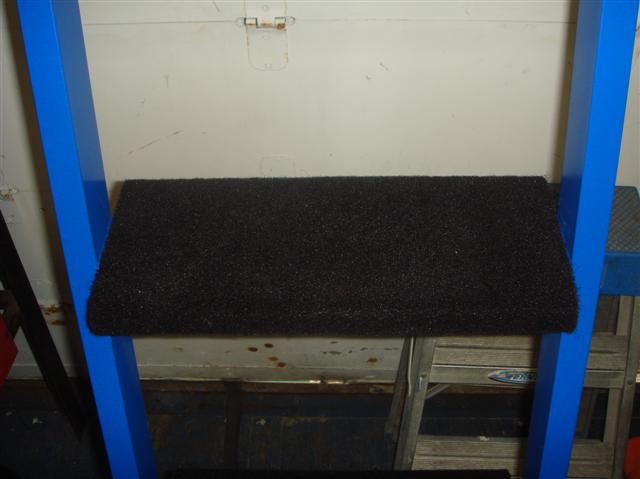

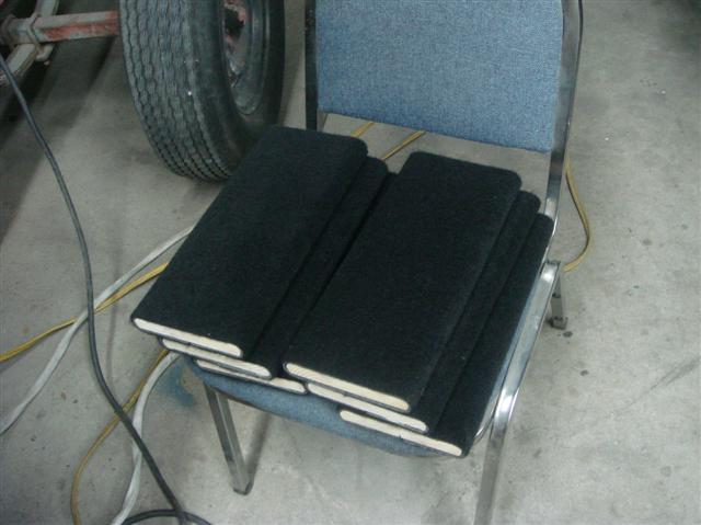

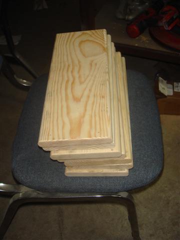

    Cut some wooden treads, round the edges and drill pilot holes, glue some carpet on, and melt screw holes so the screws won't wind up threads and pull a run in the carpet.
ID:	6797 Click image for larger version.

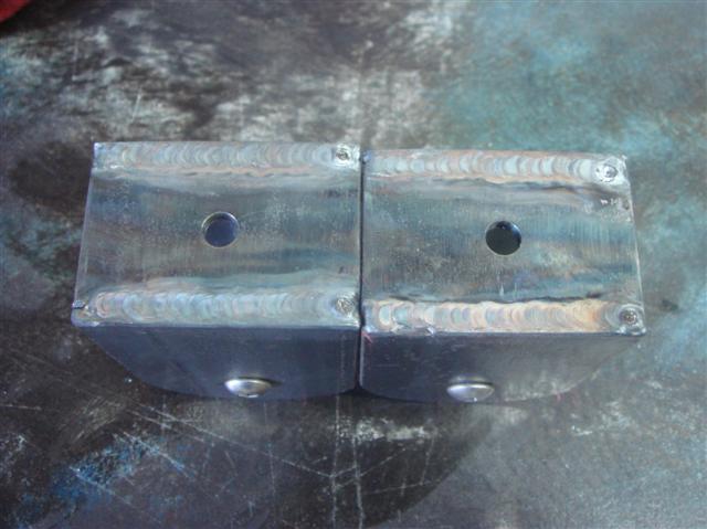

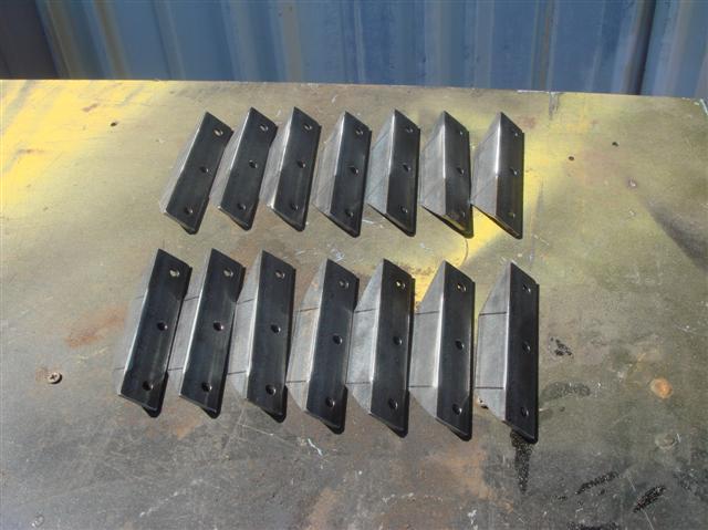

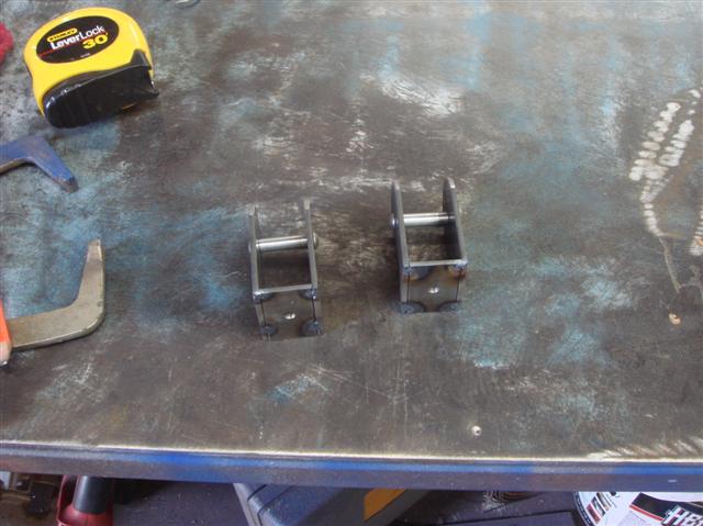

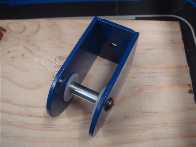

    Make up the parts for the hinges, tack them up and weld them.
ID:	6799 Click image for larger version.
ID:	6800 Click image for larger version.

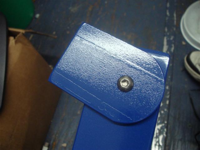

    Paint them up and install them with some nylon washers.
ID:	6802 Click image for larger version.

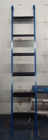

    There it as all finished and ready to install.
ID:	6804 Click image for larger version.

    Nice job. I'm digging the old school TIG setup.
    - Dr. AR Dykes
    What year SA200 is that? Why are the really older ones so popular today?
    It's a 1979 model. Still running strong.
    The solid copper windings make for a very smooth arc. S/F.....Ken M
