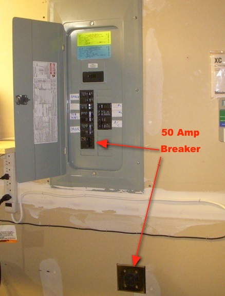

    I found a electrician that was able to do this set up for $70.00 including material and 50 amp breaker . It took him only 15 minute to do this...

    The only thing is pending is the Argon tank and this is what I found out.
    I went to Airgas, they ask me for 70 dollar for a year lease and the amount of the gas inside the tank. This include any size of tank I decide to take.
    It sound about right to me, that way I can decide which size is more convenience for my used. Until they want me to fill some type of application where the ask for so many things that I decide not to go there since look like I'm asking for a personal loan. I ask the guy and he say that yes they check your credit.
    Hummmmmm!!!! Having them checking your credit just to rent a Argon tank and you only need a credit card and a driver license to rent a car? It doesn't sound right.
    Tomorrow I'm going to make some calls to find out more...

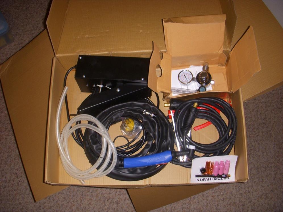

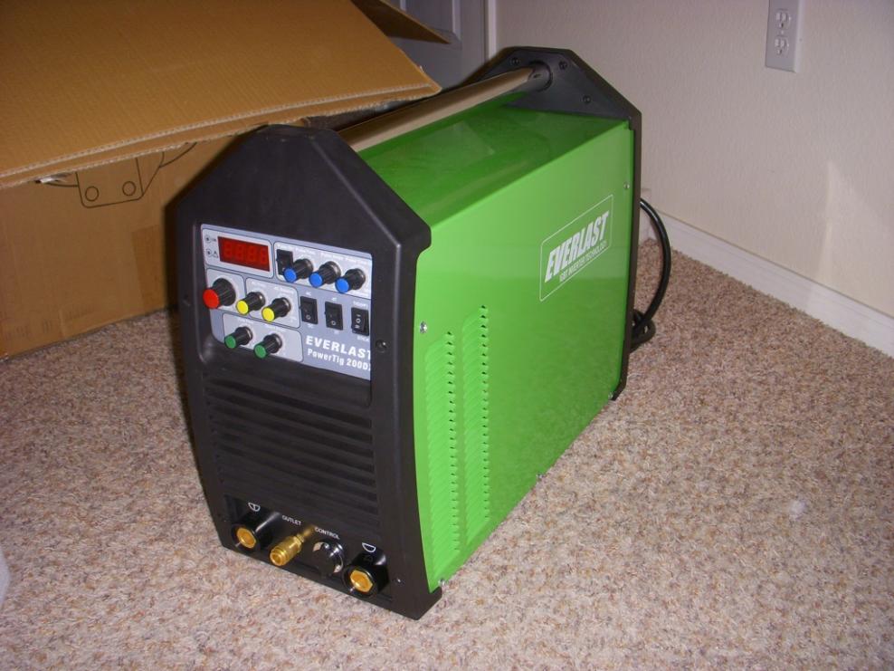

    Some more news.
    I receive today my new Power Tig 200DX. Below are some picture.
    Also I got an account with Airgas after reading Mike R. Post. So finally I think I have everything to begin burning metal around the house. LOL LOL LOL LOL
    Everything look good so far. The Gas regulator is on Liter per minutes so 20CFM converted to Liter per minutes is in between 5 and 6 L/M.
    I'm very happy, I'm guessing that tomorrow I'll will give it a try...

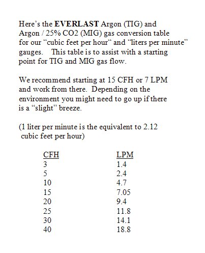

    Aspen,
    Do not convert from liters per minute to CFM. It should be converted to CFH. But 5-7 lpm is about right.

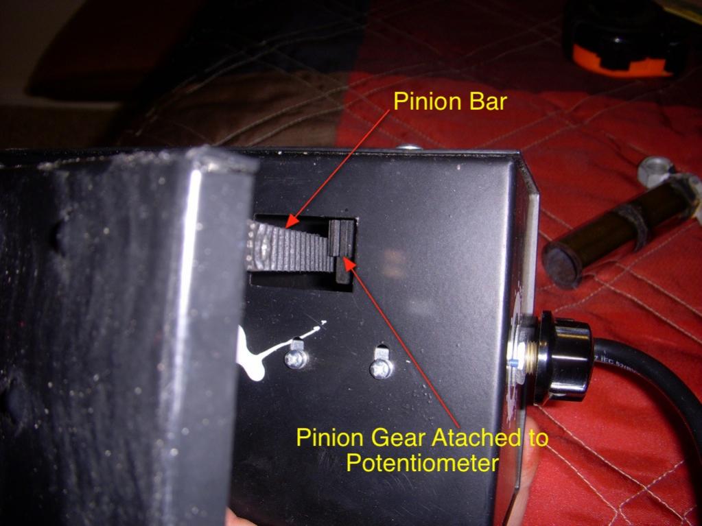

  11. Default La cosa (the thing)

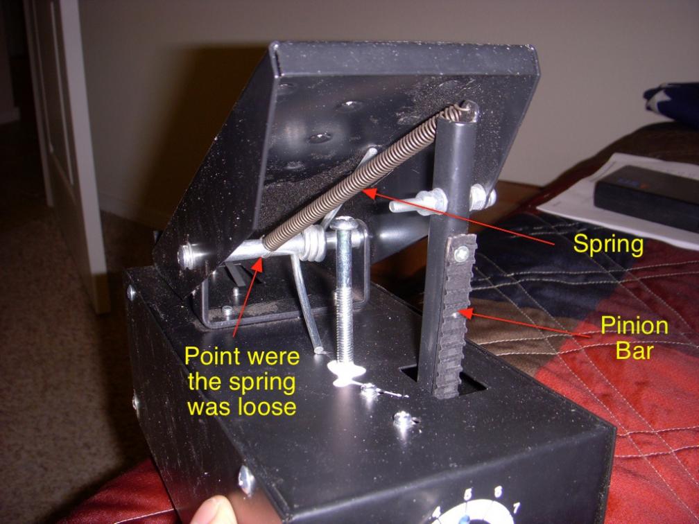

    Bad and Good news.
    The good news is that I finally try my Welder.
    The bad news is that I try it on Steel and on aluminum using the control pedal and found that for some reason no mater how far down I press the control pedal, the power or I should say the intensity doesn't change.
    I keep reading and trying, and trying with different setting and NOTHING.
    The control Pedal won't work. Yes I know that I'm new but the control pedal doesn't change anything at all wile I'm trying to weld. I said trying to weld because I just burn most of the scrap aluminum I have found around the house. I try on Steel, different setting with almost the same result.
    Well after 2 1/2 hour of going back and forward to the printed copy of the User Manual from Everlast web site. I decide to take a close look to the Pedal. I notice there was a spring hanging and I have no clue were that Sprint goes.
    You can see the spring on the picture bellow.
    I was getting frustrated and even that the machine was 24 hours new I took the chance of looking inside of the pedal control box and Walaaaaaaaa!!!!!!
    I understand what happens; the spring pull some sort of pinion gear bar against a pinion gear that is attached to a potentiometer that rotate, controlling the Power or the intensity that you select by pushing on your foot pedal. I went and attached the spring to the only hole I found and YESSSSSSS..
    A totally different machine.

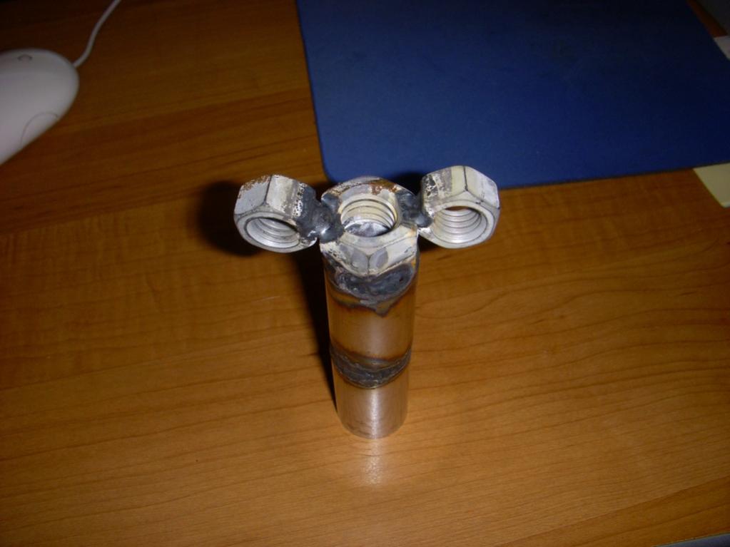

    Here is my first project, but Please don't laugh LOL LOL LOL
    I called LA COSA (THE THING)
    This is nicer that what I though. Simple, easy and I liked...
    I need more practice I know but if I did it anyone can do it.

    Aspen,
    That is the perfect paper weight. The first thing I ever tried to weld was when I was about 9 years old. It was the olympic rings from pieces of sawed off pipe. I hung it on a old live oak tree in my front yard, and many years later, when I was in college, I returned there and it was still hanging on the tree. Its gone now, but it still was something that I was proud of.
    The foot pedals are tempermental, there's no denying that. They work incredibly well, but usually in shipping parts get pressed together in the box and dislodge either the springs or bends the actual rack that goes down on the pinion gear, so that they may need to be bent back or resprung. We are looking for a better foot pedal, but none seem to give the resolution of control that this pedal gives. So, as I said, they work well, but the issue is that the parts are somewhat fragile.

    Glad to see you are welding! I know your frustration. Nothing worse than getting a new welder and having problems. Your welds don't look all that bad and remember have fun.
    "The foot pedals are tempermental, there's no denying that. They work incredibly well, but usually in shipping parts get pressed together in the box and dislodge either the springs or bends the actual rack that goes down on the pinion gear, so that they may need to be bent back or resprung. We are looking for a better foot pedal, but none seem to give the resolution of control that this pedal gives. So, as I said, they work well, but the issue is that the parts are somewhat fragile. "

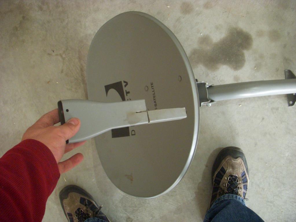

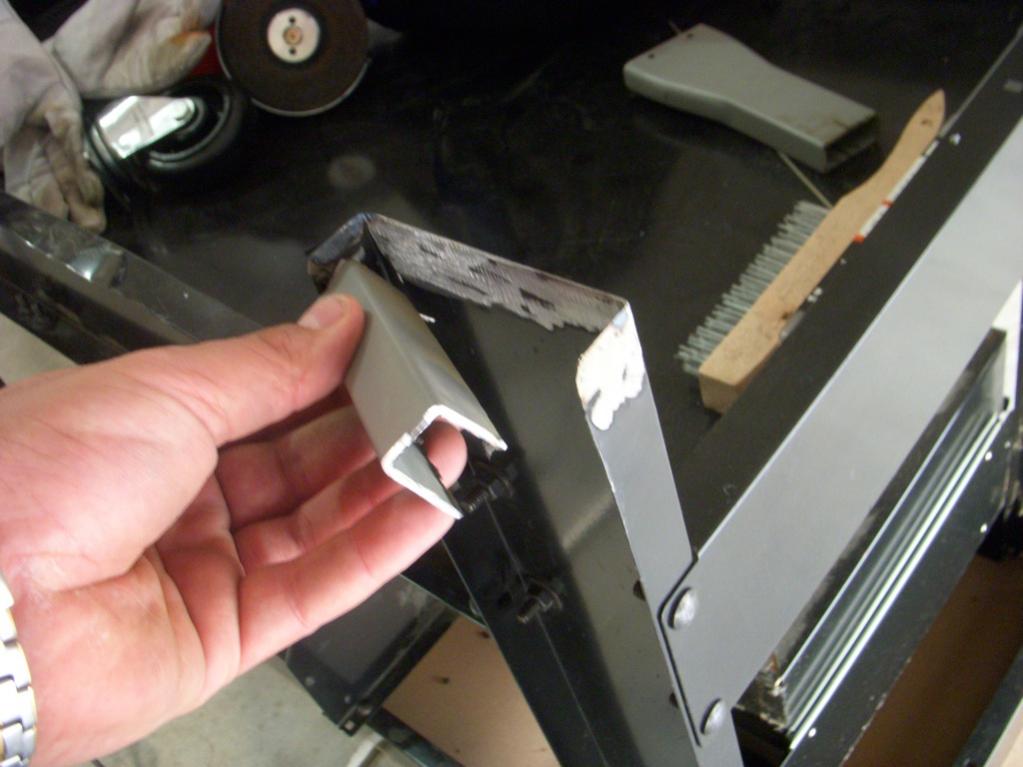

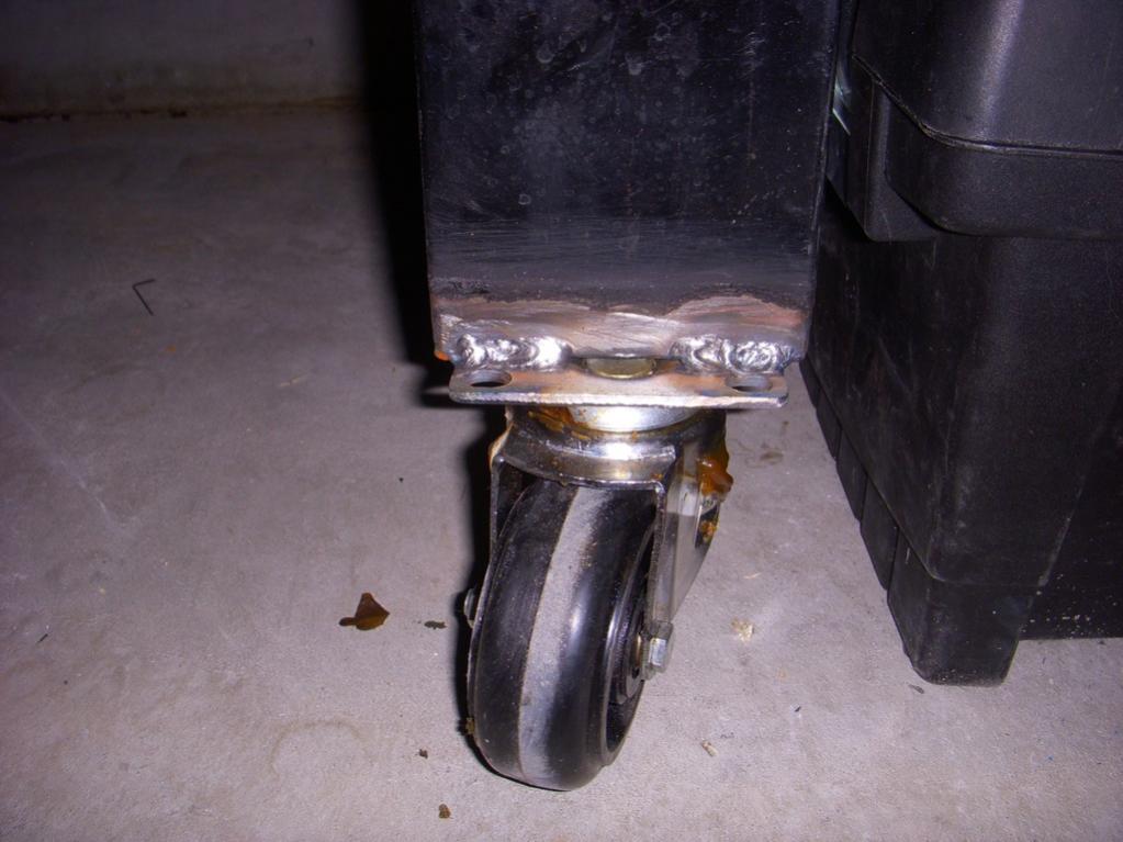

  15. Default Practicing on a work bench I have in my garage.
    I decide to ad some wheel to my work bench. But I notice the legs are kind of a Channel shape and very thing, sooooooo!
    I have and old dish antenna that my wife want me to throw away, but instead I hide it on the attic. Look what I did with the Dish antenna and the Work Bench.
    Tire hold 330lbs each and cost me $3.99 and you know where!!!!!!!
    Now I just need to buy a 1/8" or 3/16" plate to remove the wood top and weld the new metal top to make my new Welding Table.....
    Yesssss!!!!!
    I love it.
    This machine is perfect for what I need ...
    Very easy and the instruction on the web site are very simple to fallow.
    There is few things using the Pedal and the control knob, on the panel and the knob on the pedal. Kind of confusing but I think I will figure out soon...

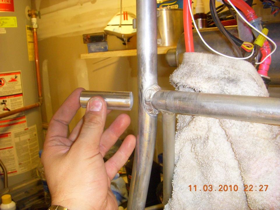

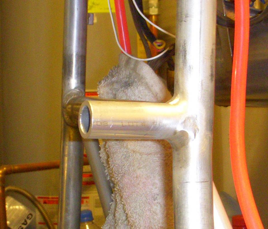

    I'm back...
    Here is some example of how I'm doing welding aluminum.
    I just love it.

    Aspen,
    Your welds are really shaping up. I am glad to hear from you.
    Default chart for gas
    here is a conversion chart for argon

    A word of caution on buying casters, I made a stand for my granite block and other measuring tools, used small plastic casters and a year later they are flat, plastic will settle out under load over time, pretty funny when you pull on the stand and it won't move, makes you think you forgot to eat a hearty breakfast. Solution is to have quick adjustable legs that hold the casters/stand above the floor until you need to move it. Pull the pins and the stand drops onto the castors,
