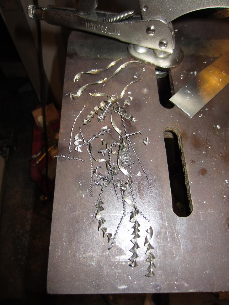

    "Curlies" like these, Dave?

    I'm guessing you were noticing chips when going into steel (and probably had the drill bit chattering as well) during the beginning of the drilling operation, before the lands of your drill bit were engaged with the work.
    (The lands are the widest part of the drill bit by the way.)
    Before the lands are engaged, the drill bit can chatter (move around sideways as it rotates) and this causes the initial chips. This can happen because the drill bit only has two cutting edges touching the workpiece, and they can dance around sideways as they rotate. Also I'll bet you would would hear it, and if you stopped drilling while it was doing it and looked at the hole, it would not look conical, or round. I wish I knew what it was called, but can't find it right now. But if you're familiar with rotary (wankel) engines, it's a similar idea to how a three-lobed rotor fits into and rotates inside a four-lobed "hole" (that is not a circle.) Except with a drill bit you have a two-lobed rotor (the drill bit with two cutting flutes) fitting into for example, a three-lobed hole.
    Once the lands engage, they can begin stabilizing this chatter. Once the chatter is gone, continuous chips (curlies as you call them) can be shaved off. I'm guessing that is what you noticed.

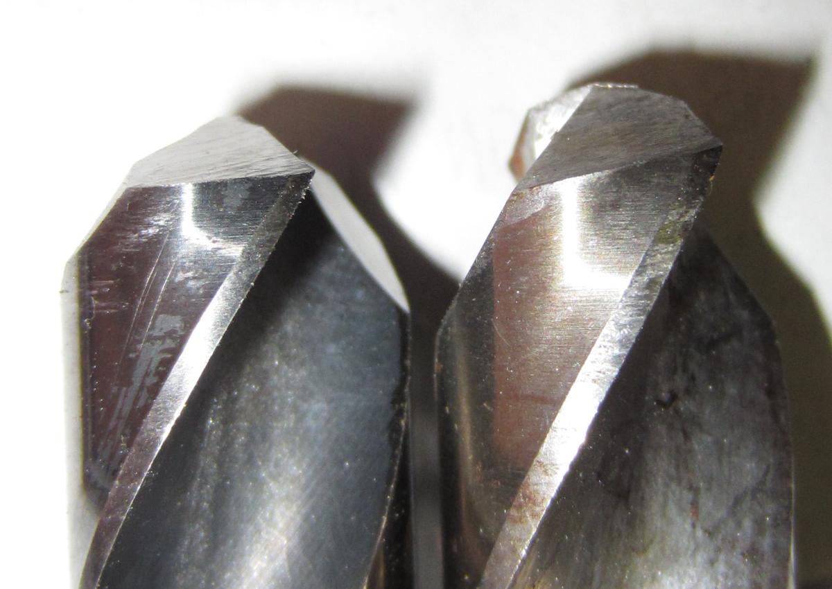

    Some more things that may reduce chatter (something I hope to experiment with more) - reduce the relief angle to the minimum necessary. It will keep the bit from trying to "bite" as aggressively. For hard metals, with large bit diameters, as low as 5-8 degrees is recommended. I am experimenting with this on my bit grinds. Supposedly the smaller the diameter of the bit, the more relief angle you need, which makes sense. The larger diameter the lesser the relief angle. It seems to me that reducing this to the minimum that you want would tend to reduce chatter. It does seem to make some difference. I've noticed that a lot of bits are factory sharpened with what seems like a pretty aggressive relief angle - perhaps more aggressive than is necessary. Having a lower relief angle also means more metal behind the cutting edge, supporting it better and making it last longer (less likely to chip off, etc.)
    Check out the "typical factory grind" on the right (relatively aggressive relief angle) and my custom/experimental grind (relatively less relief angle) on the left.
    Both of these are cobalt 1/2" diameter bits, by the way, both with 135 degree point angles.
    Is it just me, or does it seem a little bit crazy how much relief angle they are typically grinding into these bits? It's enough relief angle to shave 1/8"-1/4" wide shaving. Is this much relief angle really good for something?
