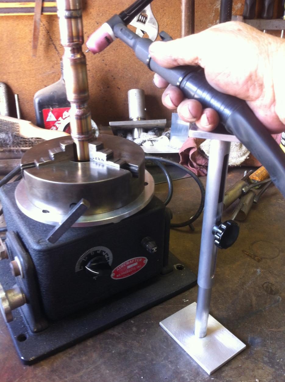

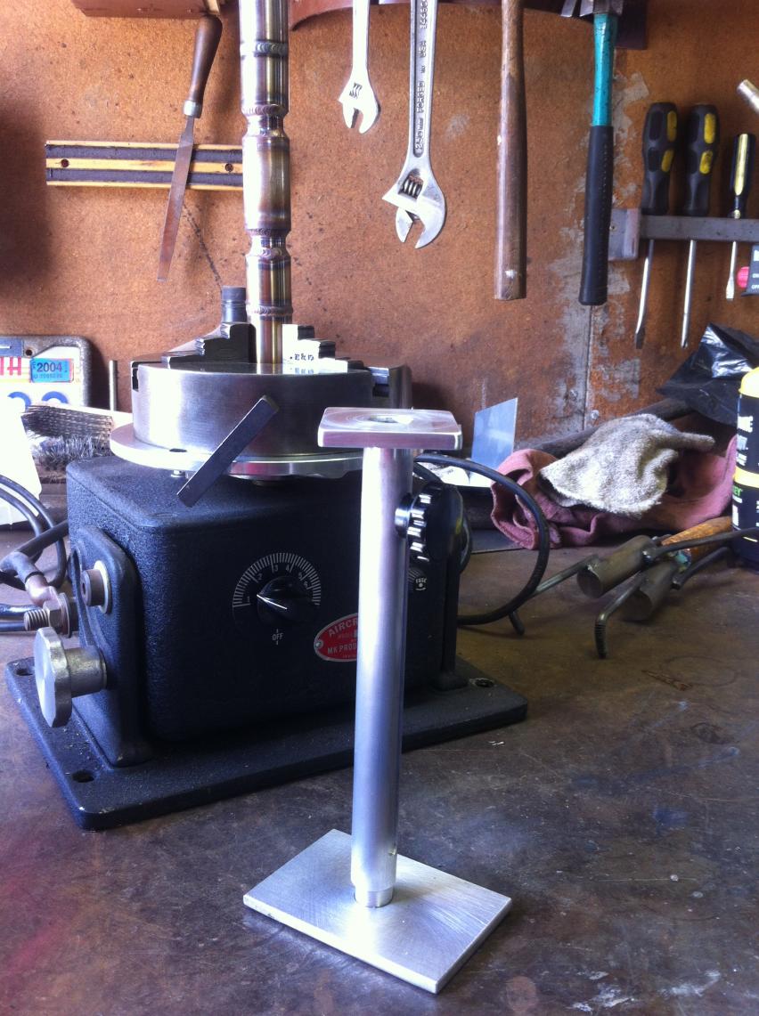

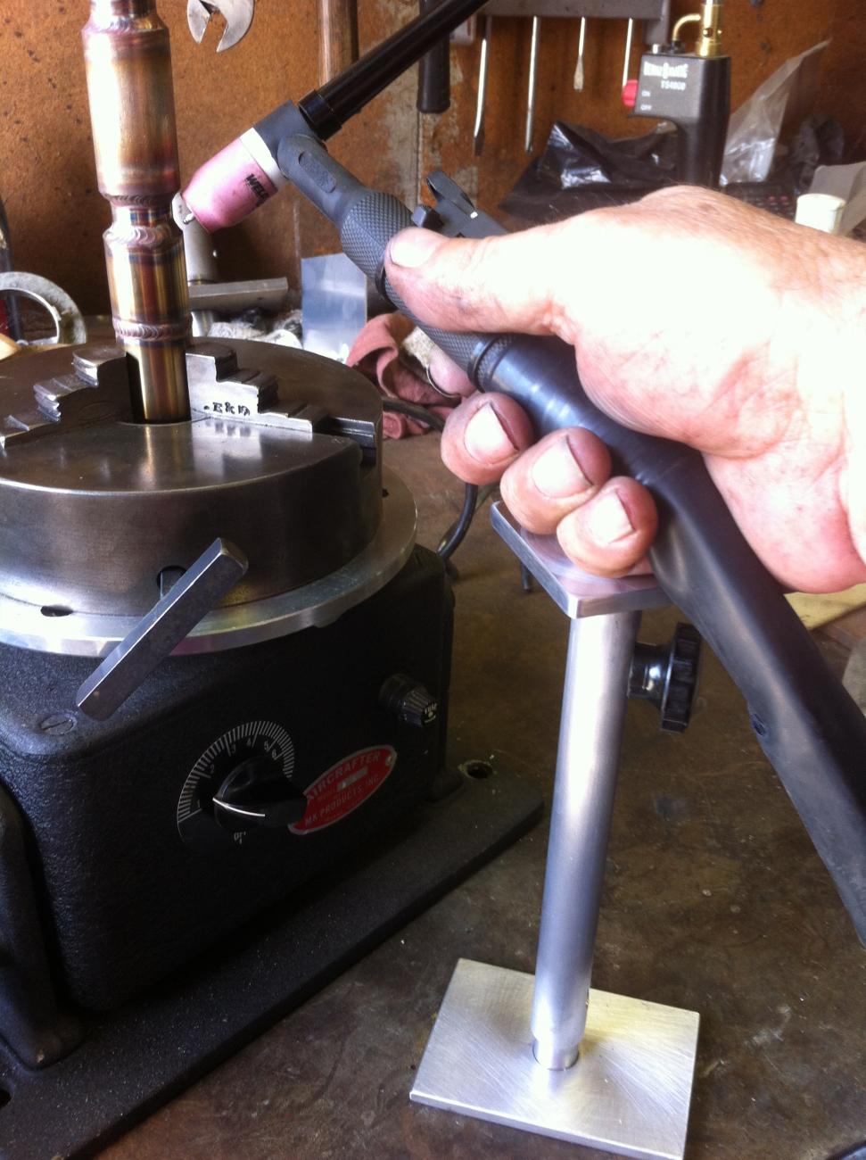

    For all you young guys with a steady hand, don't bother reading this.
    This is for all of us older not-so-steady welders.
    I built this height adjustable steady rest so my welds don't look like I did them while I was attached to a concrete vibrator.

    I really like this idea. By extension, maybe have something that can slide horizontally (but not too easily, of course) as an addition?

    Just thinking of an variation on 7FC_Driver's great idea of the "adjustable steady rest". Made me think of something like a ball bearing drawer glide moving in parallel to the bead you want to lay for the times you want to a straight weld.

    thinking the same like a slider
