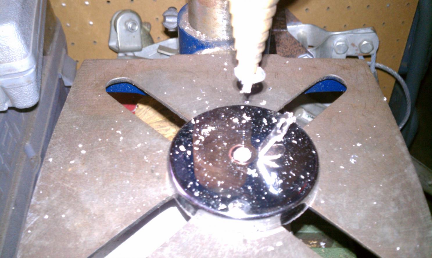

    I looked all over and found a pair of HFreight magnetic hangers of some kind, bought a pair for like $2 awhile back, for this idea actually.
    We stuck it on the little drill press and removed the rivet. Then we dropped in a 8mmx1.25x2.25" (could not find a 5/16" the length I wanted and figured the cutter would feel more at home with metric).
    So now we had a base and a center post/pivot-point that will stick the ferrous metal.

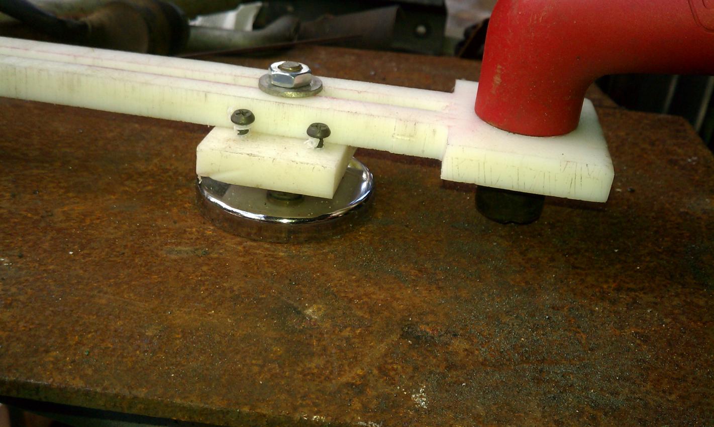

    Looked on the internet some more. Everything needed two rods to get around the center post and pivot. I had some strips of cutting boards from a food place in the back. Had the idea to make a base/pivot part, and a torch guide with a set of forks to slide in and out and lock down (around the center post). Used a four screws to make if slide straight. I will use screws through the forks if it starts to slide on me, but so far it locks down quite well. And I spun the crap out of it.
    Rivet done, the magnet is 2 5/8" across. Looked up the hanger.

    The bolt, I ended up with washer on the bottoms to get the base and top up to the right torch height. This was for the A81. You can easly adjust for a S45 and WG80. Whatever you have.

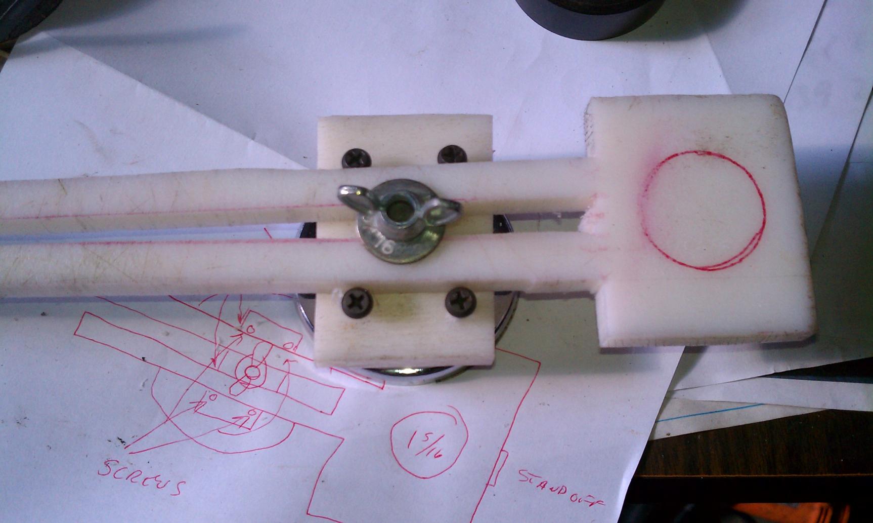

    Original non-cad paper plan and before drilling for the torch, screws to keep locked, the wing/nut holds it and it does not slide in and out, clockwise or counter. The HF wing nut broke, so the cool factor went away. Through them all on the trash after a second one was so brittle and broke (no joke).

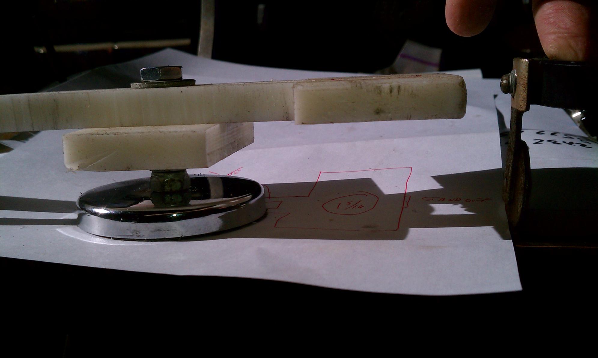

    A81 set at a random spot and I spun it over and over. Standoff is good. Never came lose. Made a video, but never put one on here before and not a youtube or spacebook fan myself. You have to trust me, I was surprised it did not move.

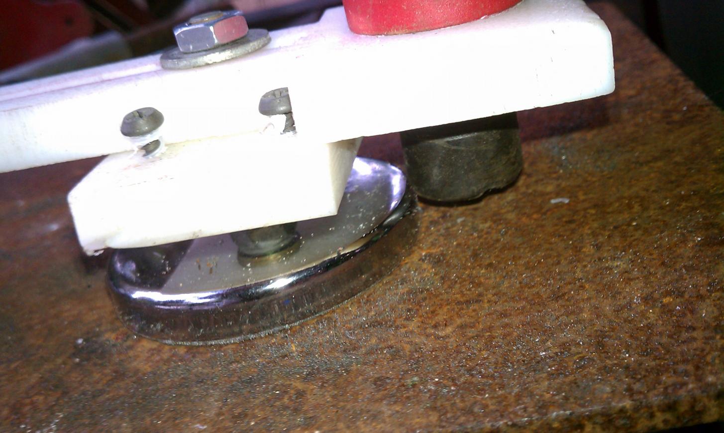

    Cranked it all the way in to the magnet base, just a tad over 1.5" center to torch center. So, 3"+ holes only due to the magnet size.
