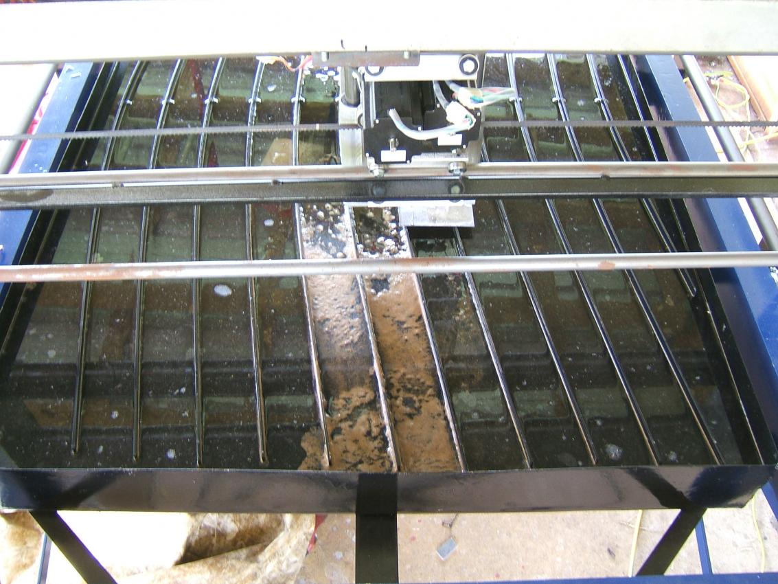

    Tom your table is looking very nice and clean. If you don't mind could you shoot some video of your setup and cutting.

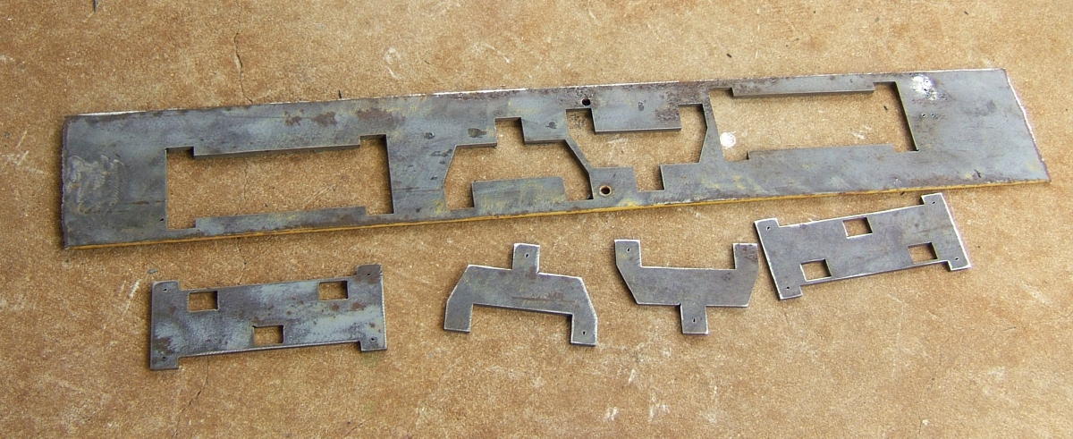

    HI All
    Well I am done with building and checking out my CNC table.
    http://www.youtube.com/watch?v=OJfW0...uRw&playnext=1
    Here is a video I did today cutting parts, the short bursts are drill hole marks and the middle of the video was double speed to make is shorter. I'm not sure if all torches are the same but I ran cutting height of .060" at 70 PSI found a formula for water table rust preventer to keep the water clear I have the stuff just need to mix and put in the table.
    This table is using a Everlast PM 256 multi-unit plasma with the torch sent with the unit. I was using 55 amps for 1/4" steel plate with no problems. I know the duty cycle would cause a problem for really big parts but for what I am doing it works great. Green Power
    Lots of time my everlast and a spair computer and some scrounged materials I think my cost was under $1100.
    Have tun
    Tom
