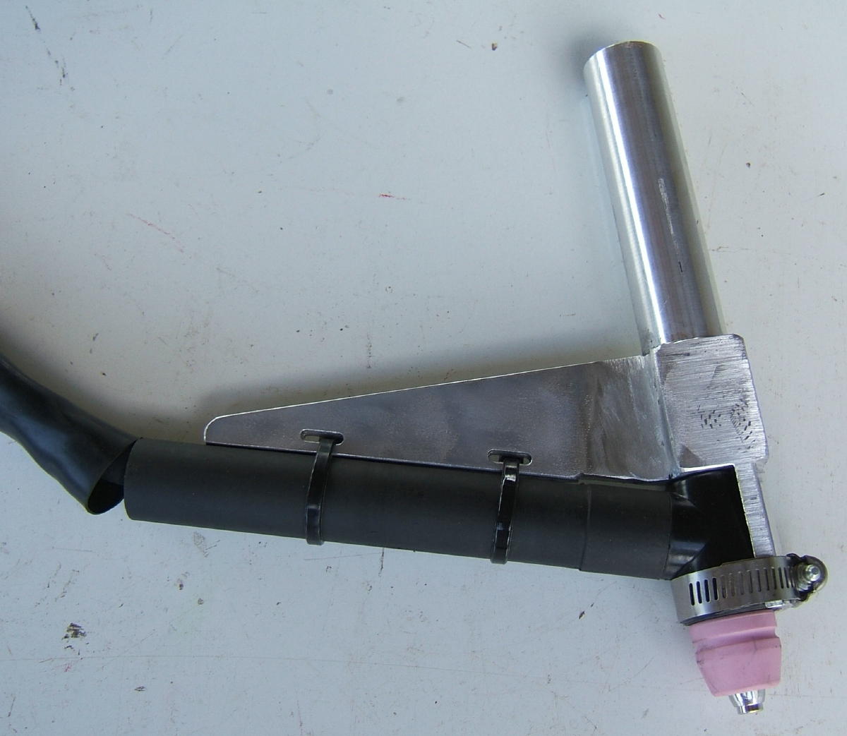

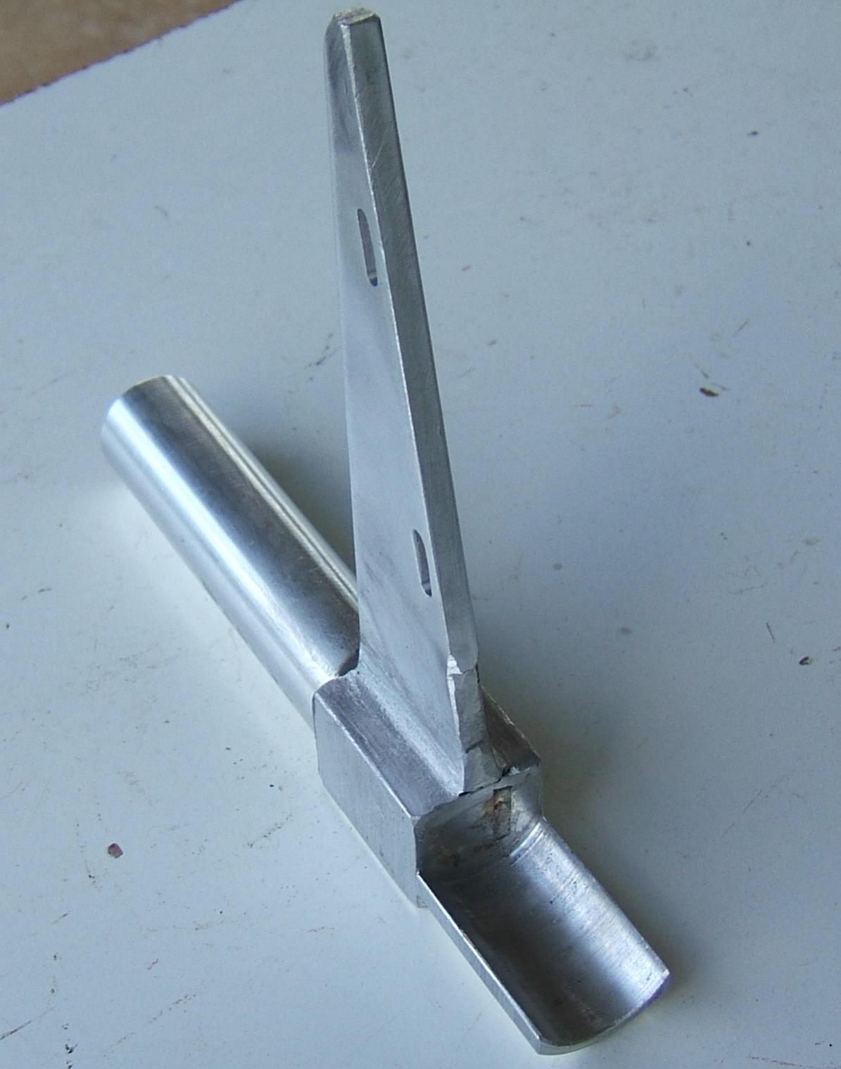

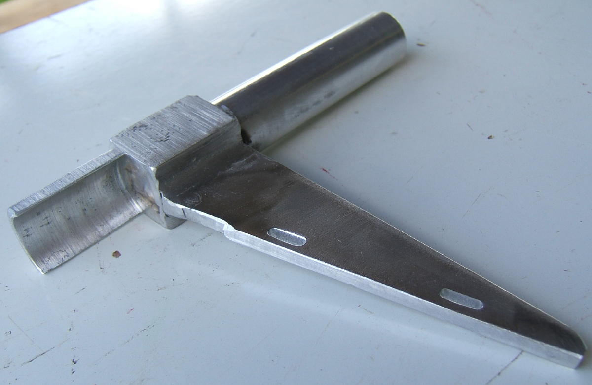

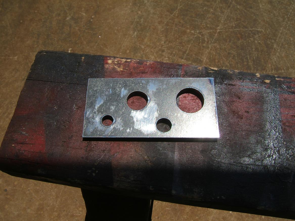

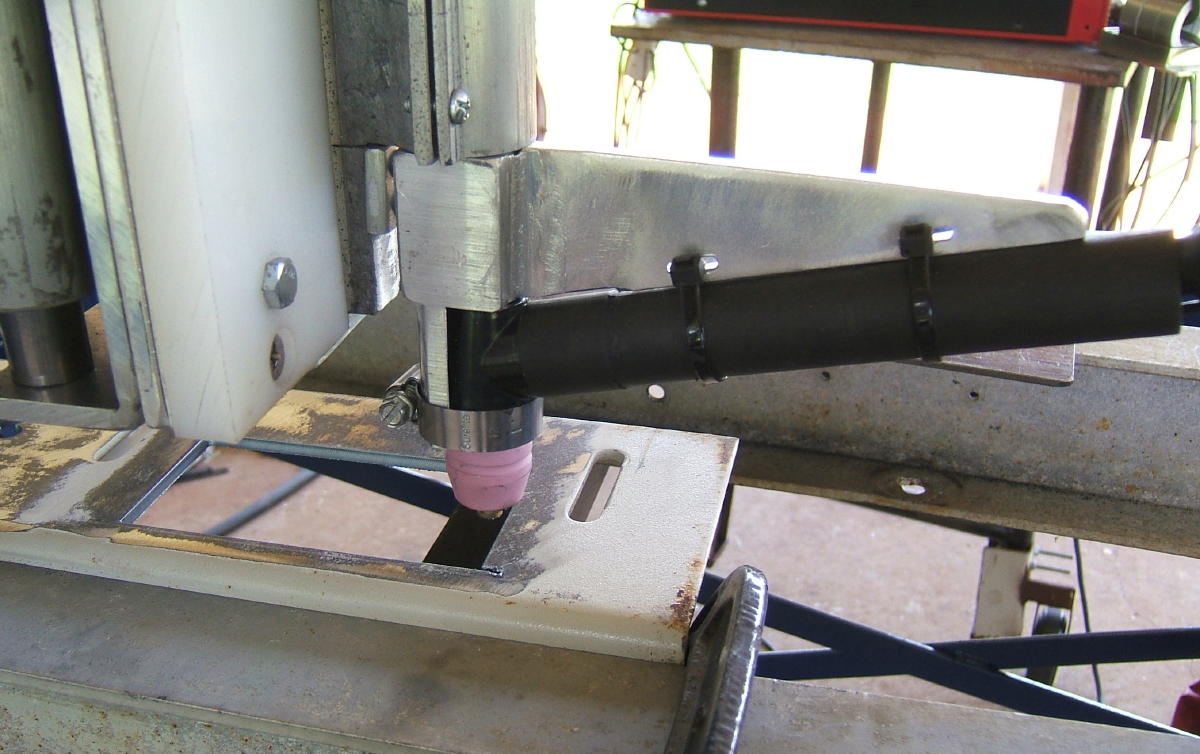

    New torch holder, I was not pleased with the operation of the p-80 torch as it was a 60-80 Amp torch. So I broke out the torch that came with my Everlast PM256 (60 amp max). I machined a holder for it so I could use the floating head holder I was using with the p-80. This was a great improvement in cutting I did a test cut. I drew up a box with 4 holes of different sizes and this torch completed the cut very well. Still much to learn and a few more bugs to work out.
    Have fun
    Tom

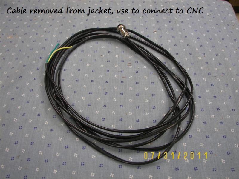

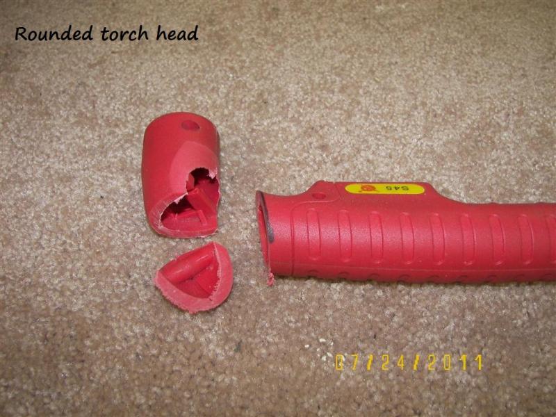

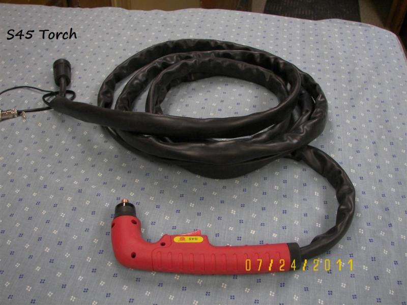

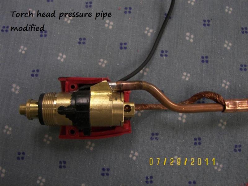

    I too agree. I have been hounding Oleg to find me a 60 with pilot and euro connector. The old 60 cuts nice and the consumables are pretty tough and cheap. I use the P80 for hacking things up and the A81 for cleaner work for now.
    BTW, table looks good, like the handle for the torch as well. Keep us posted, esp total cost minus plasma.

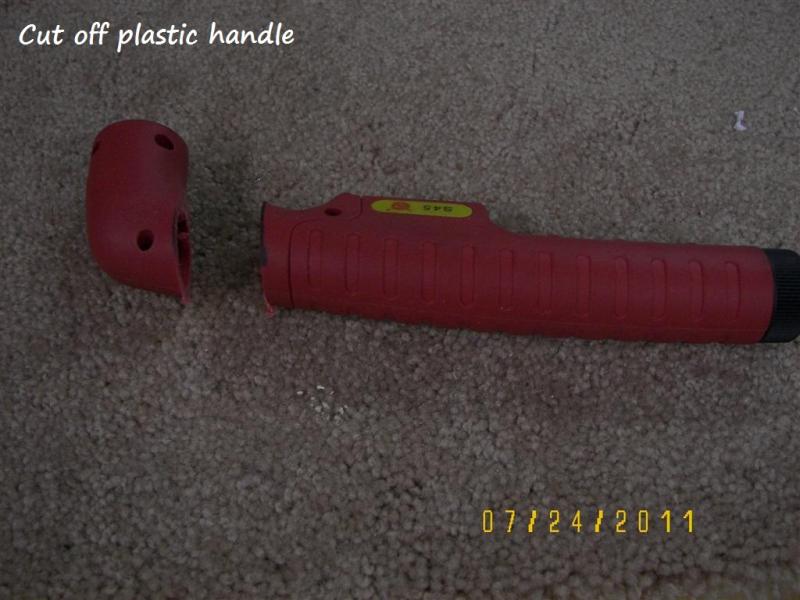

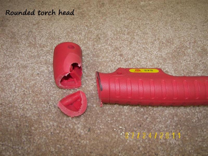

ID:	6842thought this was cool mod to torch Click image for larger version.

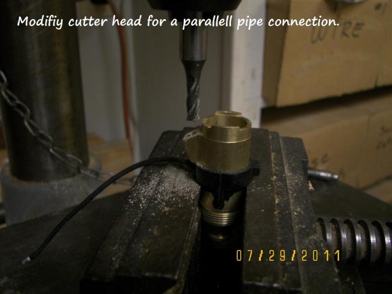

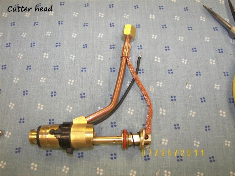

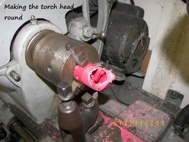

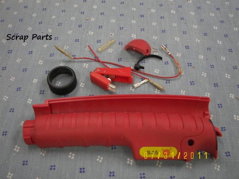

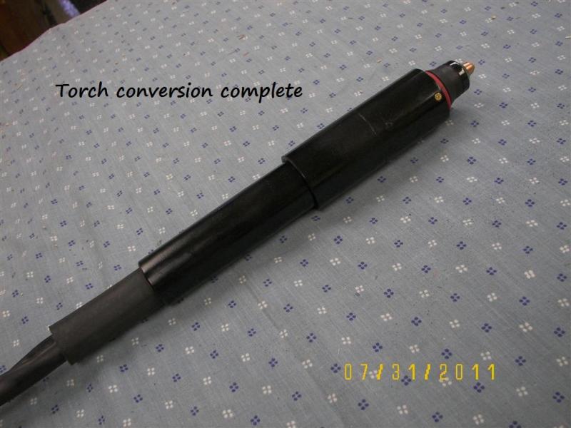

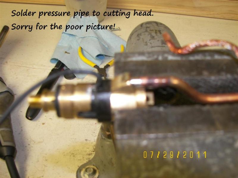

    rest of mod pics Click image for larger version.
Name:	S45 Conv 13.jpg
ID:	6845Click image for larger version.
Name:	S45 Conv 14.jpg
ID:	6846Click image for larger version.
Name:	S45 Conv 15.jpg
ID:	6847Click image for larger version.
Name:	S45 Conv 16.jpg
ID:	6848Click image for larger version.
Name:	S45 Conv 17.jpg
ID:	6849Click image for larger version.
Name:	S45 Conv 18.jpg

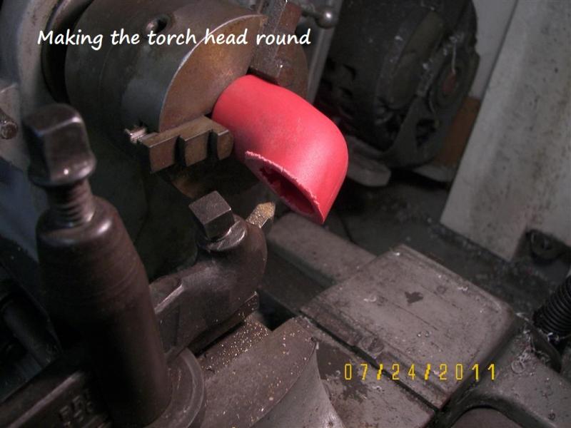

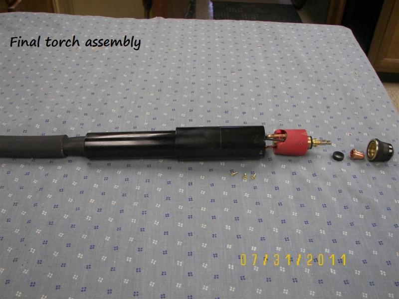

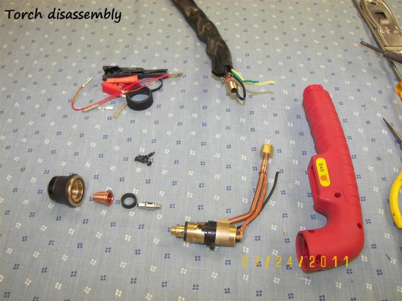

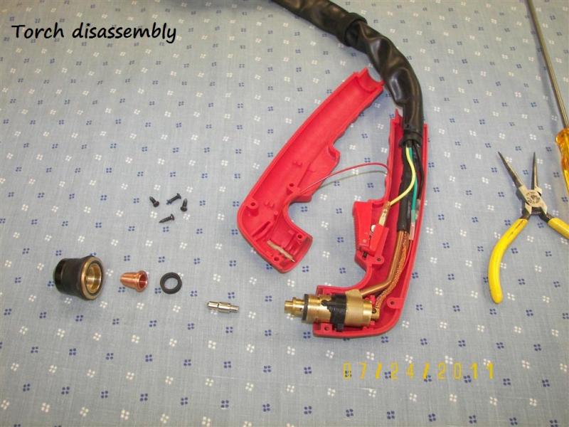

    That saved a lot of money right there. I like it, your own blowback CNC torch (dirt cheap).
    Sometimes Rod you do scare me. hahaha.. I could see you going, you heat the red bend on the torch handle with a torch and put in a vise and bend it straight.
    Nice job. Where did you get the black plastic tubes from).
    vacuum cleaner end pipe or could just use pvc pipe . lol i spend so many hours on the internet just looking a homemade projects. people have made people come up with some neat cheap things to make

    That's being pretty resourceful. A bit of an aside - You ever cast your own metal parts, Rod?

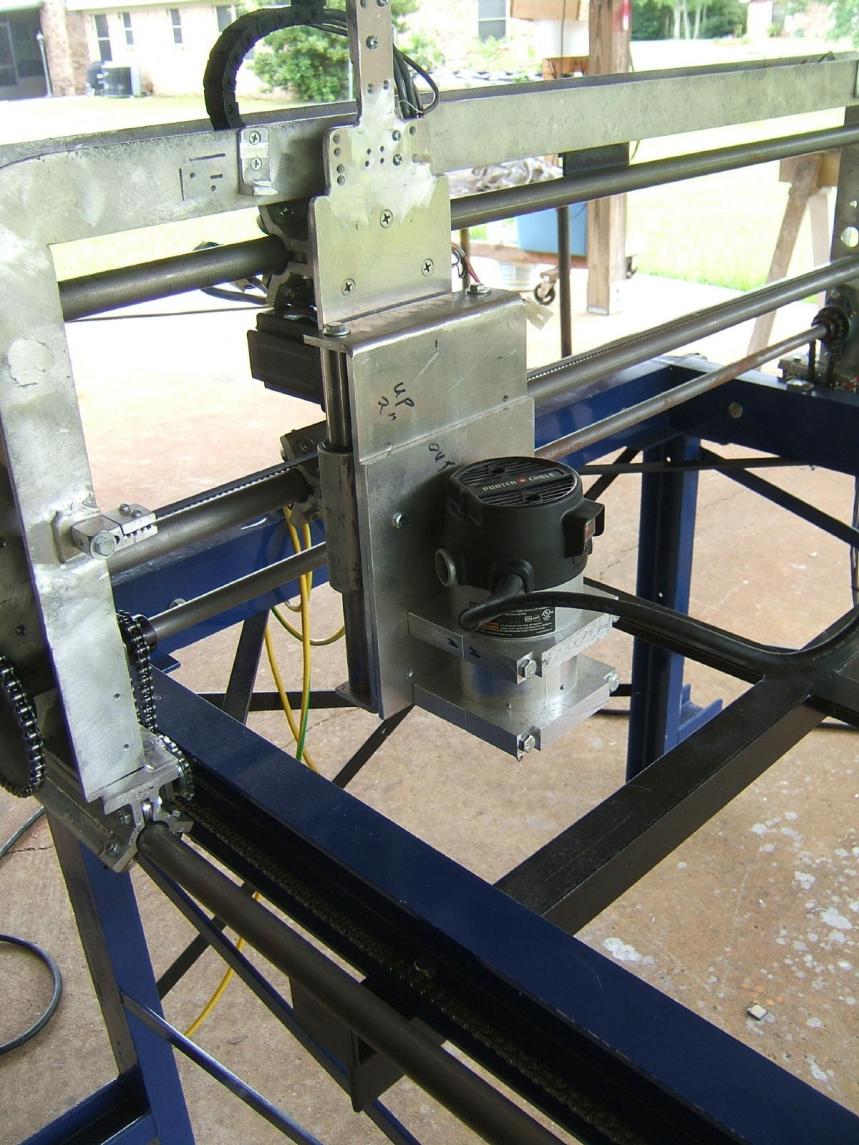

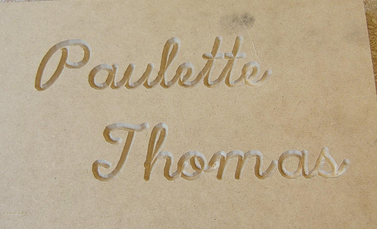

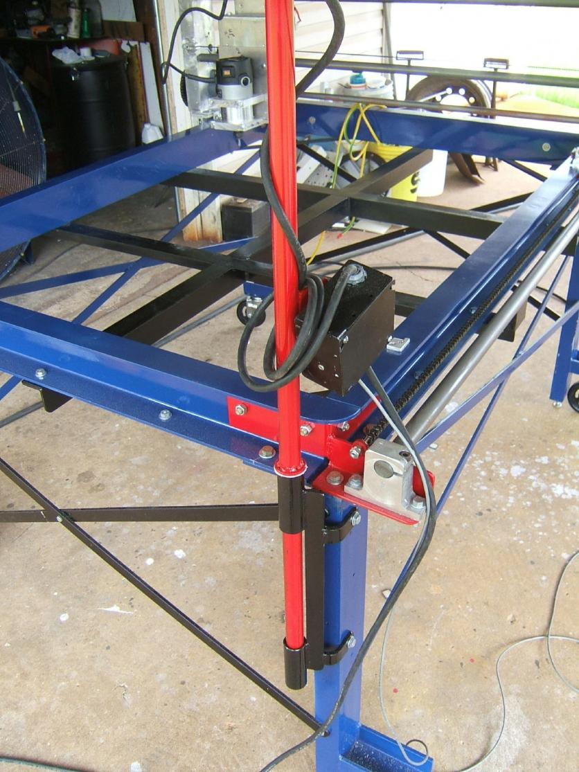

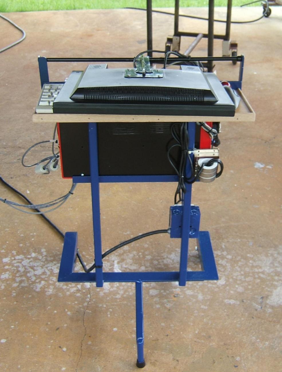

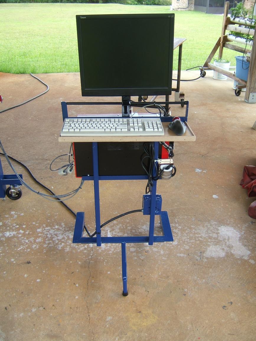

    Getting near the finish of the table. Build the mount for the router and a boom for the plasma cutter cable and router power. I used the same output from the BOB board to start the plasma and router, with the router I added a SSR to switch input power on/off. That’s in the black box on the boom the boom rotates freely and can be removed for storage.
    I also built a cart for the controller/computer box its like a hand truck so I can move it when I want. The keyboard and track ball have Velcro under them to hold them down. The monitor is on a flip stand up for using it and down for traveling.
    I ran a free program called StickFont v1.1 to lay out names and routed them on some MDF as a test.
    Have fun
    Tom

    Really nice and clean. Excellent idea to combine the router and cutter capability - best of the wood and metal worlds. Even better you are able to test things out before the project is completely done. Are those ferrite cores you have the laptop power cable looped through or is it just cable management? They aren't the "typical" ferrite core color.
  13. #33
    that looks super nice like the computer stand
  14. #34
    Yea, I like the computer stand and fold down display too. Ford blue is a nice touch

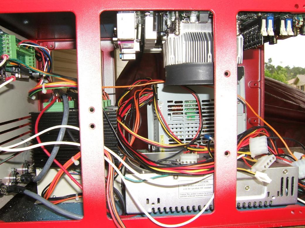

    I don’t have a laptop I removed the motherboard and hard disc and installed them in my controller box. Attached is a picture of my controller with the motherboardand disc mounted to the top of the box. The BOB is on the front panel and both power supplies are on the bottom with the motor controllers. That is the black box on my cart. The trackball and keyboard have ferrite cores on them and I have a USB jumper out the back. I use it when I want to add things to the disc me inside desktop is where I load a thumb drive with changes and bring it out to my shop to load. If the ferrite cores are large enough it pays to loop the cable through it a few times.
    I downloaded a Plasma screen from shopdroids here it is if you want it.

    Those are pretty big cores. Nice that you took advantage of their size and wind a couple of times.
    I see now. Should have taken a better look when I first saw it. I like what you did with the screen. Nice way of keeping the screen safe when you aren't using it.
    Good idea with the trackball and the USB drive. Will probably keep everything far more industrial that way.
