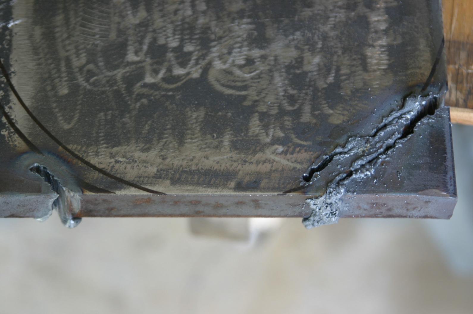

    I gave it a try and didn't do so good. I usually keep it at about 60# air, upped it to 70 for this and gave it full 70a. power. Cuts on the right don't count, I forgot to lower my lens shade down and was pretty much blind. Cut on the left I could see, but it didn't like it. Sounded like it was switching on and off.. I'm going to try again on the cut offs when I get some time. Any suggestions?

    cutting to fast max amps and 70 to 80 psi have to keep torch straight

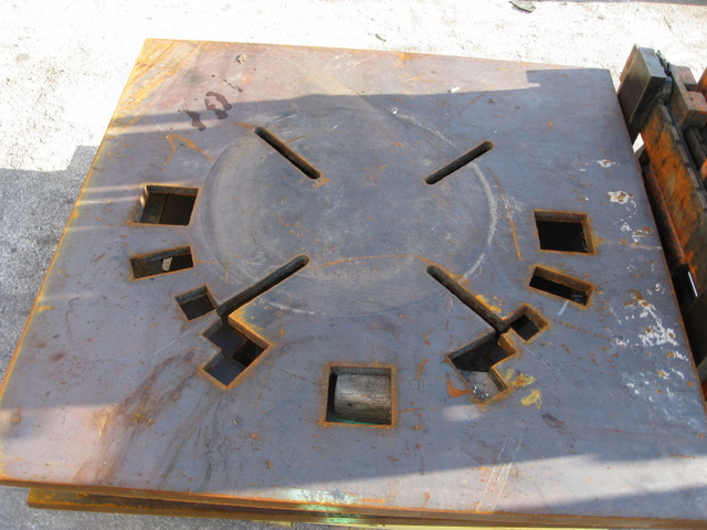

    jake, for the money and the convenience it is a good idea to have an oxy/acetylene setup on hand. i have a plasma cutter, i rarely take it out except for stainless steel. and on occasion for steel plate 3/8ths thk and less. for the most part i use the OA setup, the steel in the photo is 1" thk, and on occasion i have had to cut up to 3 1/2 inch thick. cut quality is pretty good once you get used to it. in the field it's indispensable; it cheap, portable and doesn't require power. it is a good idea to have a backup just in case.Click image for larger version.

    same here i cut all my thick stuff with oxygen acetylene . been doing it so long come out nice and clean cuts pluss have the rite size cutting head setup for thick stuff , sorta cool cnc oxygen and acetylene setup
    you can do some nice clean cuts with a gas torch
    Making a free hand cut in thick stuff is difficult without a rest /guide strip etc. The local welding shop has one of those little bugs that runs on a track holds either O/A or plasma,,,,,moves slow and steady and makes nice cuts....my free handing on thick stuff doesn't look much different than yours,,,to old and shakey I guess..
    Well, that could be part of it, for sure..
    FDC, the cuts in the photos are OA? Dang. My welding cap is off to you.

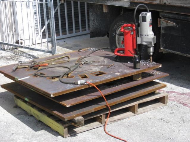

    Is that some kind of portable drill press in the photo? Never saw that kind of thing before, but it makes sense when the plate is so large.
    i use a 00 tip for cutting; the problem is it does not generate enought heat to blow throught the one inch plate, so i'll drill a 3/16 hole first. the smaller tip allows me to move a little slower and maintain some degree of accuracy. it is not all that hard but it is amazing how many guys using a cutting torch produce work that looks like they did an apprenticeship in a scrap yard.
    the drill is a mag based drill. you plug it in, push a button and the magnet comes on. the head can be reversed to increase break away pressure point. i have it four inches out in the photo. it is variable speed, takes bits or annular cutters, and will drill through anything. i recently drilled a bunch of 1 1/2 in holes in some 1/2 in 316L SS plate. no problem.
