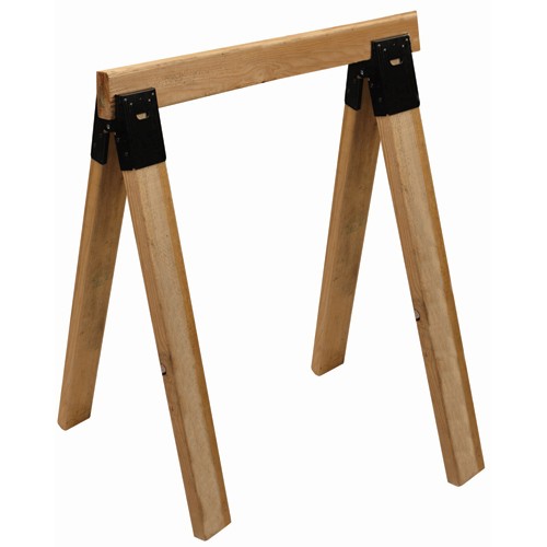

    these are the kind of projects i like to do , I have seen some really cool trailers like this , like watching the tv shows about them , should get some sawhourse bracketsClick image for larger version.
