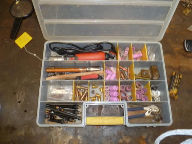

    i use a dedicated grinder I use a mini bench grinder also use the flex shaft tool to clean my mig torch ends when full of stuff http://www.google.com/products/catal...d=0CJcBEPMCMAAClick image for larger version.

    I use the same mini bench grinder to sharpen my tungsten as well. Then I use the scotch-brite wheel on the other end to polish it. Works well for me and was a very cheap setup.

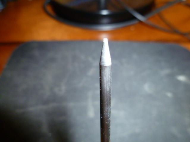

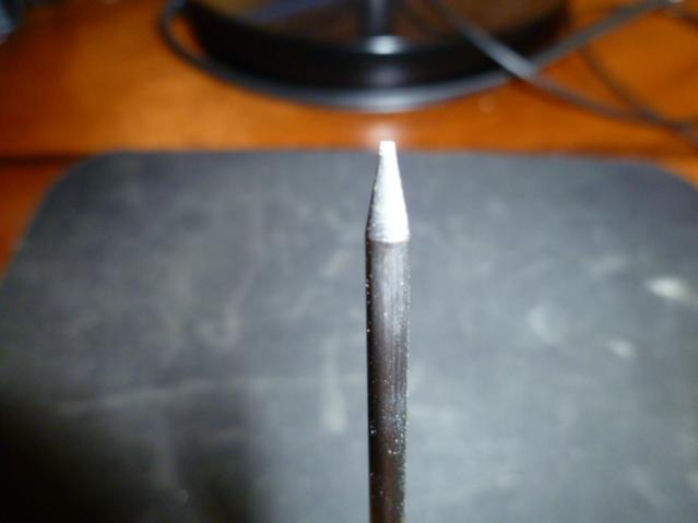

    this works for me since i'm usually outside.Click image for larger version.

    Just got one of those grinders...works well and more handy and safe than the old bench grinder. I got a 10 pack of double sided, 1" diamond wheels on ebay for $8 and they work well so I'm happy with this set up

    that picture looks like the grind is across the tip? I thought that was N-G.. or is it my eyes..
    Looks that way to me too
    Probably works fine for anything not on the lightest end of the amperage scale
    New to welding!
    Lots of Snap-On tools
    In need of more toys
    I think it's just the picture.
    From the manufacturer:
    "The long-life double-sided diamond grinding wheel produces longitudinal grinds for consistent welds, deeper penetration and less re-work."
