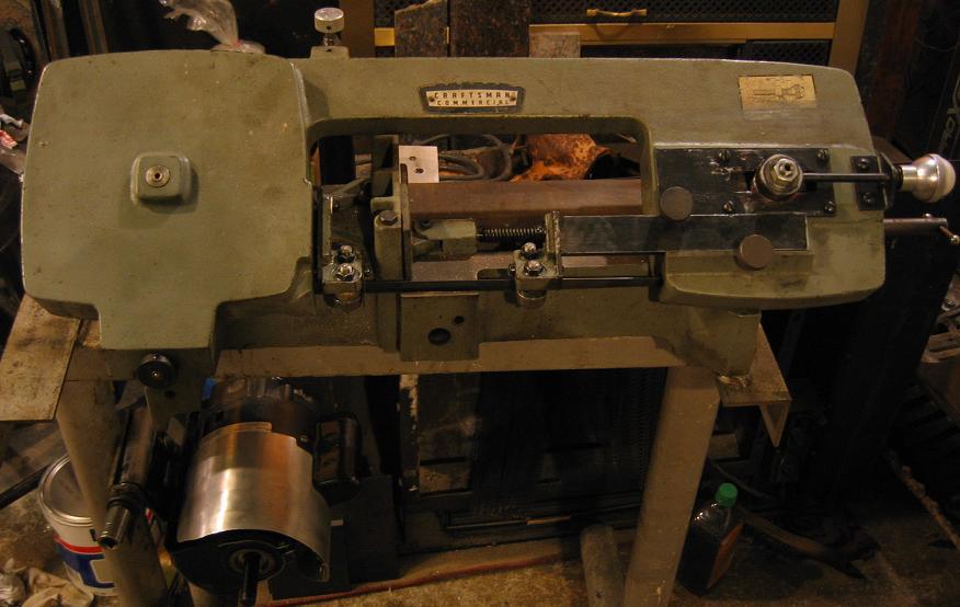

    Hey hooda - good to hear an update.

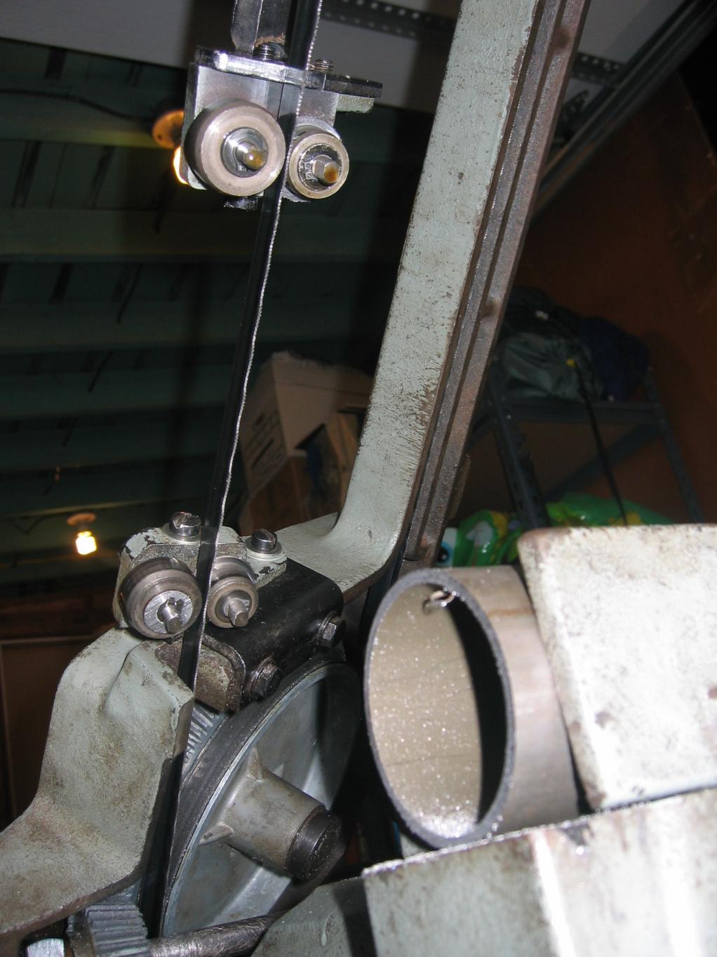

    I have a bit of time (and interest) lately in getting the ol' craftman metal cutting bandsaw dialed in and figured out. If I make any headway, I'll let you know. I know you've got one just like it, so if it's just a simple matter of setting it up properly to get it to make square cuts, that'd be pretty sweet.
    Here are my latest thoughts (completely untested) - I have seen no "good" source as to how to tune the gap between the blade guides. The owner's manual instructions in this regard make no sense to me. I'm pretty sure I have mine set up somewhat "sloppy" - meaning the blade rests kind of angled in between the guides. So, one guide bears the tension of the blade high up, and the other bears the blade tension down low. So as the blade deflects from varying cutting force, it bends the blade sideways somewhat, which makes the blade wander. My thoughts are if the guides were tighter, it would keep the blade more fixed with a range of tension. It seems like a pretty difficult parameter to adjust on this bandsaw though, and I can't think of any easy way to improve that. Maybe it's something where once it's adjusted right, it won't need to be readjusted again though. (At least if you keep the same thickness blade... I'm using .025" since they're commonly available.)
    Those are just my preliminary thoughts. And I know I've set my guides up so tight before, that little metal fragments on the side of the blade practically extruded going through the guides. Not a good situation, it was definitely *too* tight. Anyhow, I'll let you know if I make any headway on it. I've tried some cutting in it recently without trying very hard to make the cuts square, with pretty good results. So now I'm thinking maybe using a high feed pressure helped. I don't know.
    PS - on the TIG welds, one tip - I think if you ran more current, with a faster travel speed (or even using pulsing) you could input less heat and oxidize the metal less. That may be a moot point for your project (because it's going to get paint over it any way) but if there are any stainless steel parts it will help the way the welds on those look. Try running more amps and a faster travel speed, or using some pulse perhaps (either with machine or manually with the pedal.) Cheers

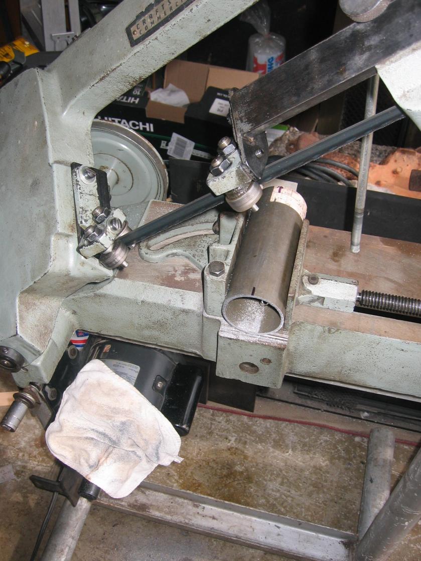

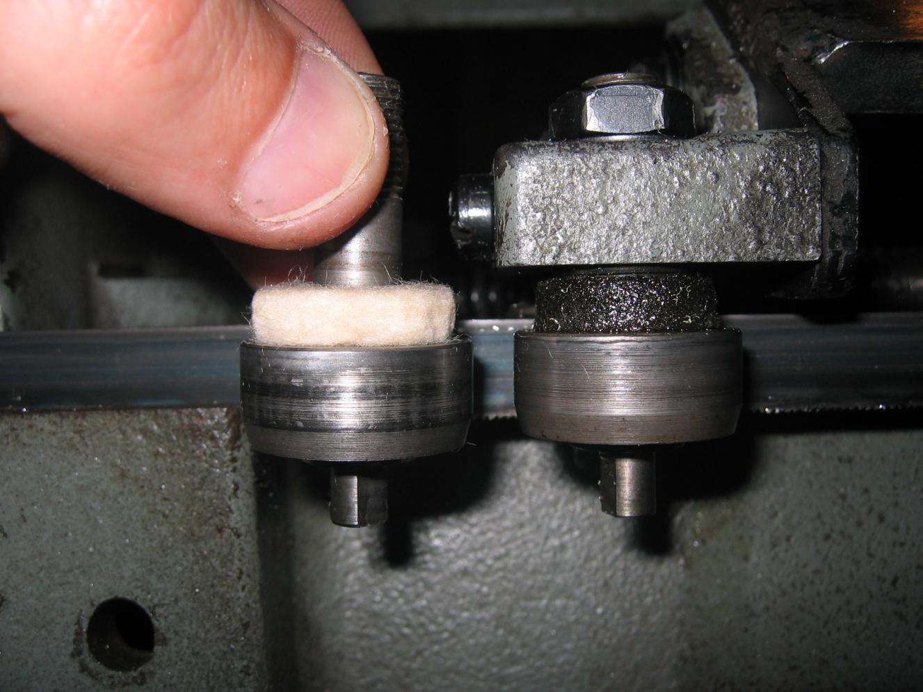

    Hey rodsmachine - thanks for the link but, not really applicable. It's a horizontal saw. The blade rollers are also really old style, they are actually oil lubricated solid rollers, not ball bearings like most newer saws. They have these felt "wipers" on the top which have the job of retaining a bit of oil to keep things lubricated. When I first got my saw, one of hte "wipers" was missing and it didn't work at all. Any oil I put in it drained right out and the blade guide was running hot and dry. I ended up making my own wiper out of some felt stock I think I found from an old dremel polishing wheel.
    Anyway hooda has the exact same saw so if I can figure it out, I might be able to help him. I think I can set it up so it cuts straight on a certain test cut piece, but then when I use it to cut a different piece, it's not straight. So the problem is, it's not consistent. My theory (that is unproven at this point) is a difference in feed pressure causes the blade to rock in the roller guides either more or less, and causes the inconsistency in cut angle. I believe hooda has encountered the same issue with his.
    Edit - I found some pics - this should show the roller setup on this bandsaw. This pic was before I made the missing felt wiper.

    you can still buy parts for these old band saws since most old craftsman machinery tools was made my atlas , whats the model number
    How right you are! I have bought some parts from clausing service, and cured many of the problems with this unit. (The biggest one was a worn out driven wheel bushing.) The problem I had before doing that was keeping the blade to stay on the wheels. I don't think hooda has been having that problem. But anyway, that's all fixed now. It's just getting the unit dialed in to cut straight *reliably* that I haven't figured out.
    One thing I have not tried, is a .020" blade which the machine is actually designed for. I have been trying .025" wide blades, because they are more commonly available (and less expensive for a wide variety of different blades), so I was thinking if I can make it work on an .025", it'd be pretty sweet.
    Mine is a 101.22923. I've located an owner's manual that's pretty close (actually I have some others on variations on this saw as well.) Hooda's is pretty much the same but, his has an on/off switch "upgrade" that mine lacks, but I plan to add to mine soon. (I already have the switch, just need to install after figuring out where precisely to drill the hole for it to go.)
    I found a pic of my homemade wiper. Works like a charm! Practically never need to add any oil now.

    And an overall pic of the bandsaw:
