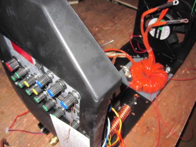

    Got her in the mail today. Gotta say hat was some quick shipping, I ordered it a little after 2pm on Tuesday and it was here at 10am this morning, gotta like that.
    Here are a few shots of it first out of the box. I was a little disappointed in the fit and finish. The knobs are not punched on center and some are longer than others. In addition to that one of the retaining nuts on the knobs is different from the others, like they just used what they had lying around. There are some scratches on the bezel, I don't care about that much.
    This was also lame. I cannot stand it when people just mashed wires into a terminal. On top of that if you look close you can see where the wires arced when they did the testes at the factory.

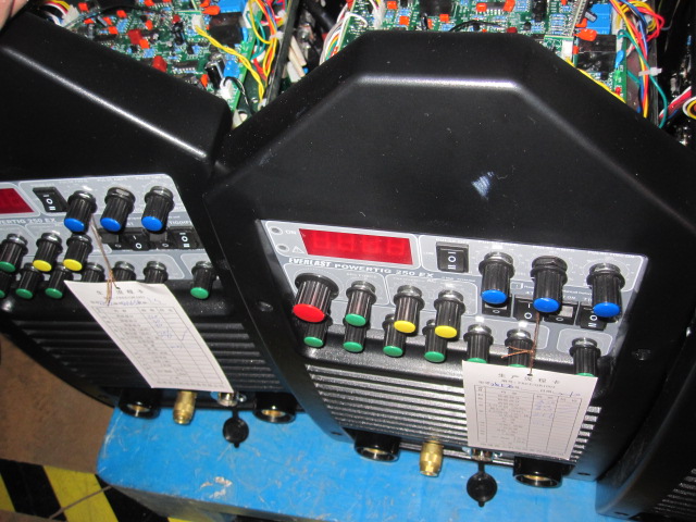

    The pot that has the black lock nut is not a random thing. all units have this.

    The pot that has the black lock nut is not a random thing. all units have .
    Cheers
    LOL, I didn't know that. Doing production and QC work myself I noticed it right away.
