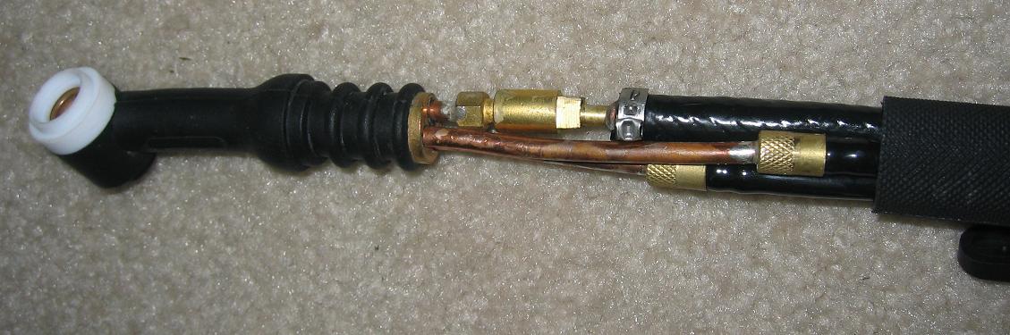

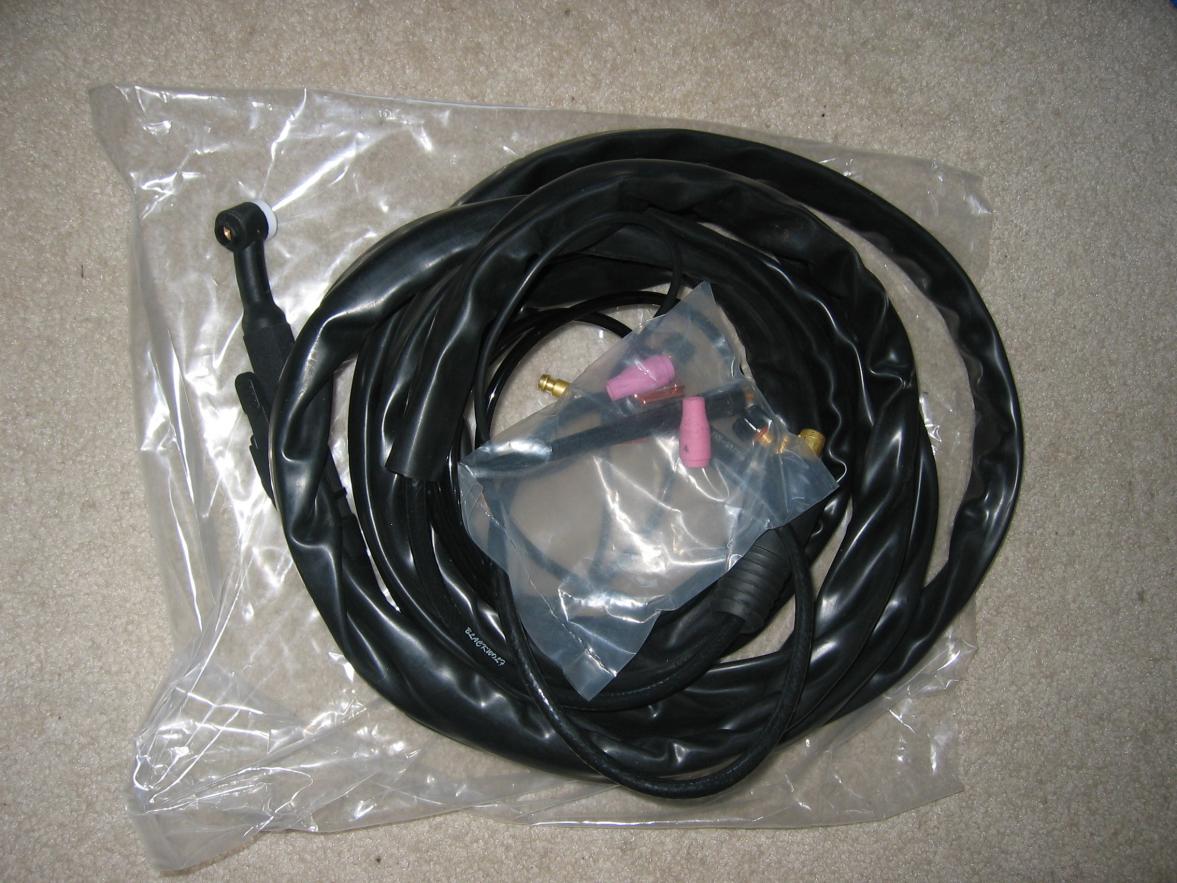

    Forgot to mention - Everlast's WP-20 is pretty sweet too. The nice thing about it is, it's a package: all the right fittings, the torch switch, cable cover, it's pretty good quality. The only thing it lacks compared to a CK is the superflex hose. (And also, CK torches tend to be rated really high in terms of amps & duty cycle for their size, too, but I'm guessing for a 250EX, rated 250 amps @ 60% duty, either is going to be fine... especially if you're stepping up from a WP9!) Aside from the lack of superflex cables though, it actually is pretty close in terms of quality to CK's torches.
    Let's see I have a pic of the Everlast WP-20... (which I have not used yet, but so far have checked out pretty closely.)
    Check out the screw-on connectors under the handle, just like CK.
    The CK has a bulkier teflon insulator than the other brands too. (I think it lets them cram more brass into their torch head for their higher amp & duty cycle ratings.) Every once in the while, the bulkier teflon insulator can get in the way though.
