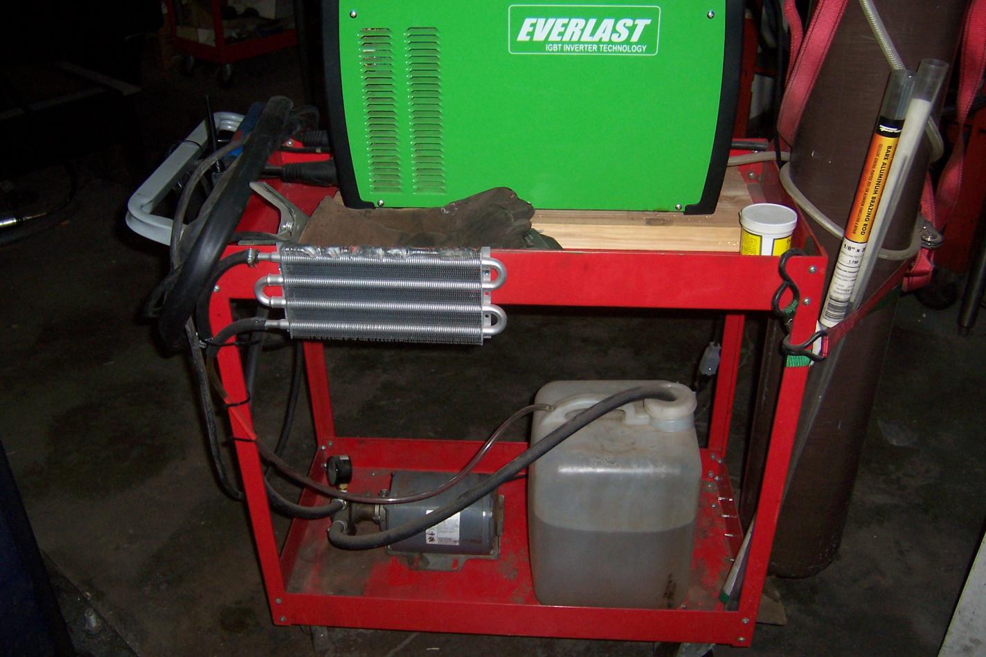

ID:	6342 just a standard cart like the tig up hi and have room for all the consumables got the cart on ebay for like 40 bucks
