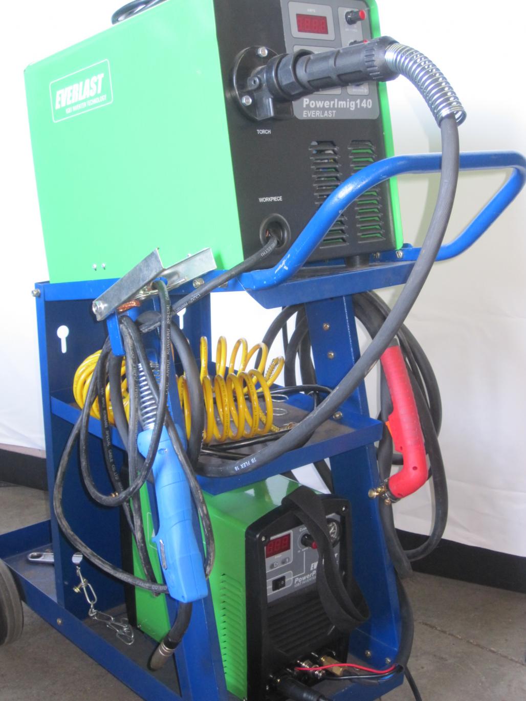

    Sorry i missed your first post here been a bit busy lately trying to get ahead on things as i am due at the factory in a couple of weeks time.
    The 25amp plasma uses a continous blowback style torch . This torch is the newly designed Trafimet SK25S torch ( uses same consumables as the S45) it only needs 33lpm of air flow at maximum 30psi ( works best at 25psi) and it is designed for a clean cut of 6mm (5.5mm= 1/4" ) it can drop down to as low as 12 amps for fine cuts .
    the Technology is IGBT similar to that of the PowerPlasma 50. However with the 25 amp we eliminated the Euro connection in order to keep costs down on the unit. ( $500) I will post some pics later
    Cheers
    Duncan
