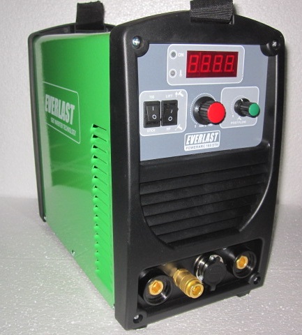

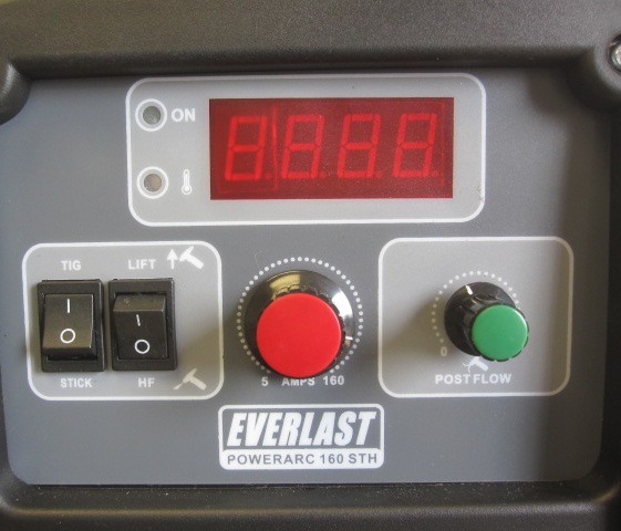

    The PowerArc 140ST is a nice little machine but if i wanted to use primarily TIG i would get the 160STH . This has both hf and lift start for tig , built in gas solenoid with front panel connections for the gas line.
    Regulator is also included
    The option of adding a foot control pedal is also a added plus.
    In addition it puts out higher amps on both 110v and 220v . And of course you have the Tig /Stick to 160 amps on 220v
    It comes supplied in a similar black plastic carry case to that of the 140ST
    Cheers
    Duncan
    Cheers
    Duncan

    Can't speak to the 140, but was using my 160STH last night for a stick weld repair and setup/take down is 5 minutes. Can't figure how you'd be significantly faster with the 140.
    If you plan on doing any significant amount of TIG, I wouldn't even think about skipping HF start and gas control via solenoid with the 140. S/F.....Ken M

    Doesn't look like the manual for the 160STH is up on the website yet. I remember EchoSixMike mentioning he liked the post flow from his unit. From what I've been reading, it looks like the gas flow on the 140 is pretty much controlled from the manual gas valve on the TIG torch as the unit doesn't have its own gas solenoid. To stop welding, you need to pull away and break the arc. If you don't have a foot pedal for the 160STH, how do you stop welding and take advantage of the post flow and gas solenoid stopping the gas?
  16. #17
    You let go of the trigger and it stops the welding process and post gas will run. Just like the pedal.
  17. #18
    But with the trigger, it is on/off and doesn't control amperage, right? Need the pedal for that? Sorry for all the questions but certain individuals in these forums have got me looking at the 160sth when I really shouldn't be ....
  18. #19
    Correct, it is always on/off, with no amp control on the torch with this model. Foot pedal always controls from 5 to160 amp range without any limit from the panel.
