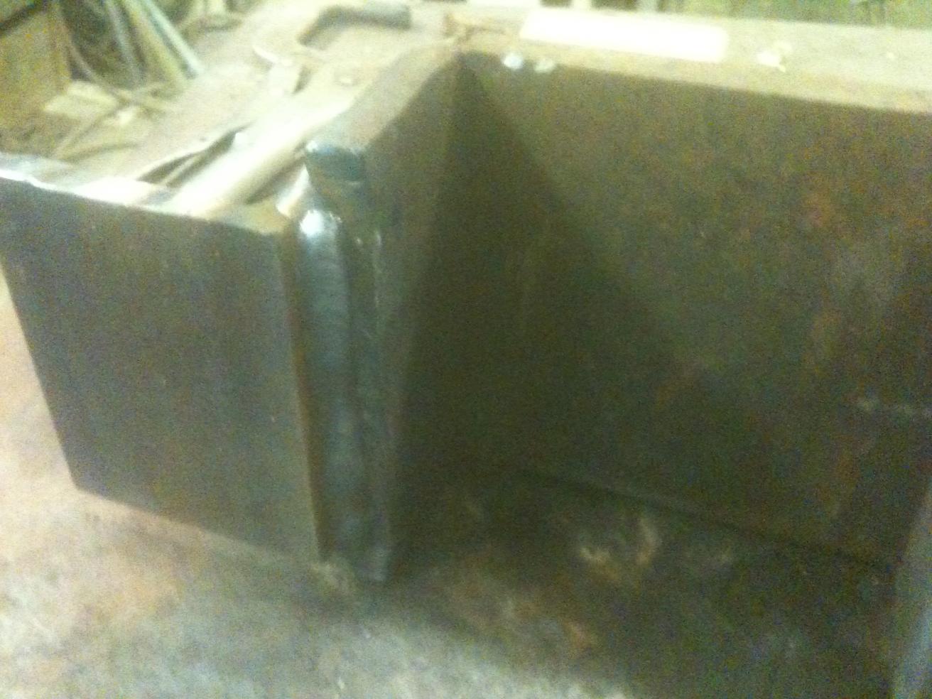

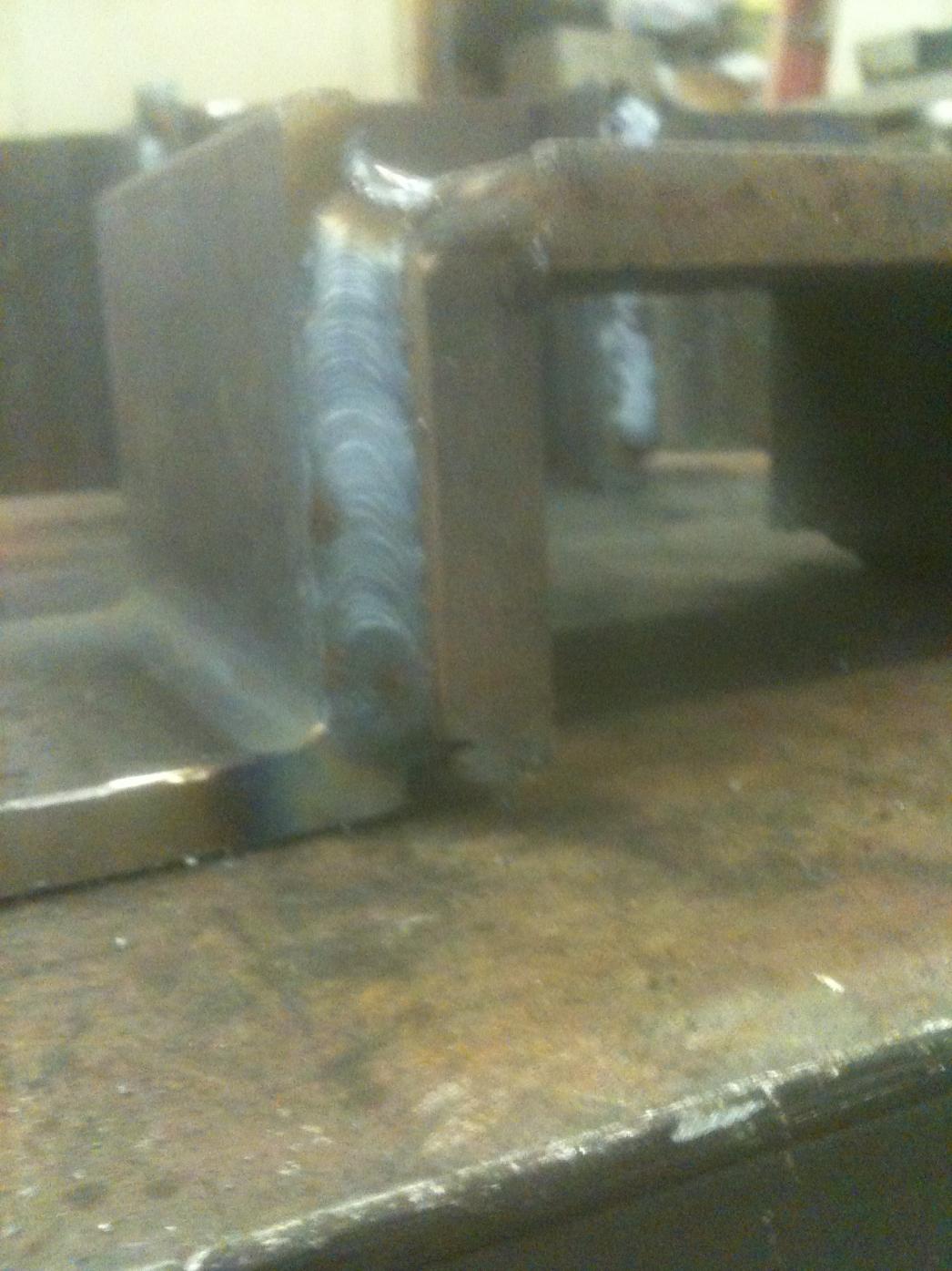

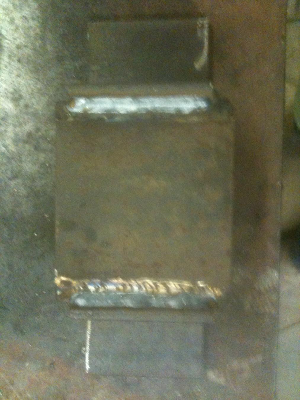

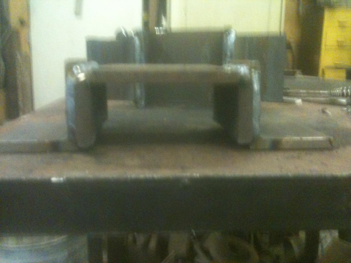

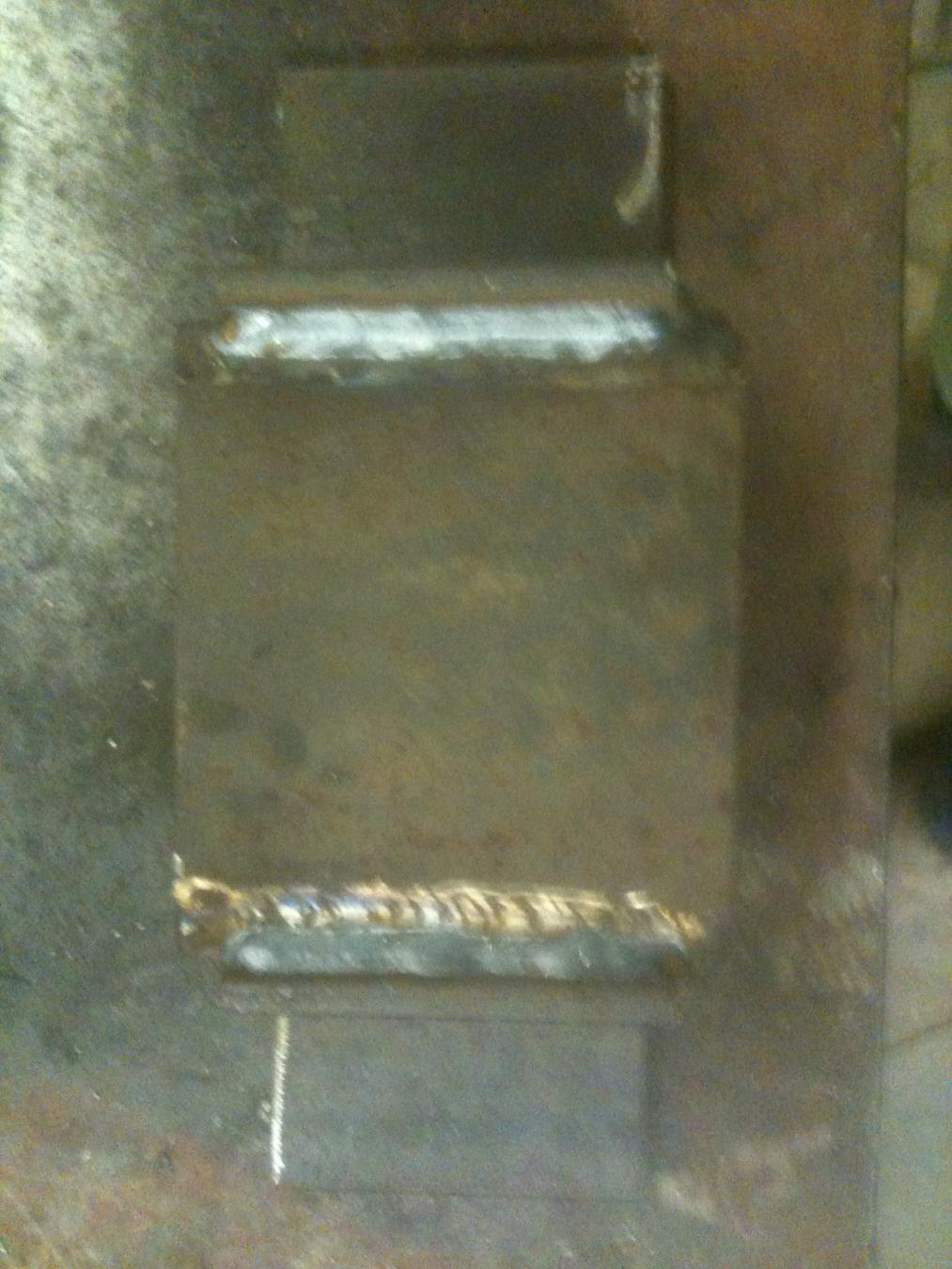

    So I took this old set of holes that were for our loader forks that got cut off of something and rewelded angle iron on so the forks would fit in it again. I should of just made new ones but didnt have any big enough pieces of that thickness. So i just used used some angle iron and mig it onto the old ones. These are gonna be for an easy pickup on our big log splitter. Havnt welded them on the splitter yet. It took prolly a couple hours had to find everything and then try and get it all perfect and square. They will work but kinda goofy looking.

    welds are nice but should be the same thickness or more to be a strong weld . need to do some more pass,s on the welds to build up
