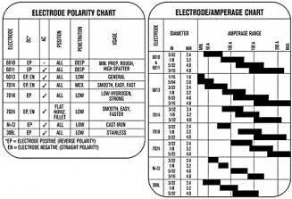

    can anybody tell me the best arc force settings for the 6010 (Fleetweld 5+, 3/32) with the Everlast PowerArc 200 ?

    The PowerArc 200 doesn't have arcforce settings,,,it is adaptive,,,you must mean amp settings,,,,try 50 to 60 amps for that size of rod and remember it's not a drag rod like 7014 it has a longer arc gap (dist from rod to metal) slightly greater than 1/8 inch once the arc is struck,,,,that's why they make scrap iron so you can play and practice on pieces until a fellow gets a feeling for different new rods...hope this helps you

    http://www.hobartwelders.com/elearning/ amps 40-85 DCEP: DC, Electrode Positive (reverse polarity) has the most weld penetration this mite help
