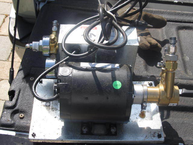

    I made my cooler for under 150 bucks . just a pump . a 5 gallon container and a transmission cooler works great , its wired to turn on when i turn my tig welder on
    Cool--how much water do you need to move for something like that, and is there any kind of fan on the transmission cooler or does it transfer enough heat without?
    the trans cooler just by itself never get hot . the pump is a procon pump what they use for espresso machines . you can get the pumps on ebay for as low as 75 bucks to 130 bucks , there the same pumps miller uses in the tig cooler unitsClick image for larger version.

    not sure on flow but pulled the cover off my buddy miller cooler and was the same pump with same part numbers i know with hose off it shoot all away across my shop lol so it has good flow , being line so small on a torch for cooling it need a good flow pump that why miller use them most the cooler units i look at use this pump

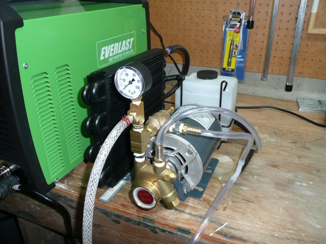

    lol, cool.. Well maybe I'll end up with water cooler sooner then.
ID:	6206 this is what mine looks like but i use 5 gallons of distilled water instead of a small washer bottle ,what cool my 5 gallon containers i get from goodson tool that grinding fluid is clear like a washer bottle and thick plastic the pump runs about 30 psi just checked the specks

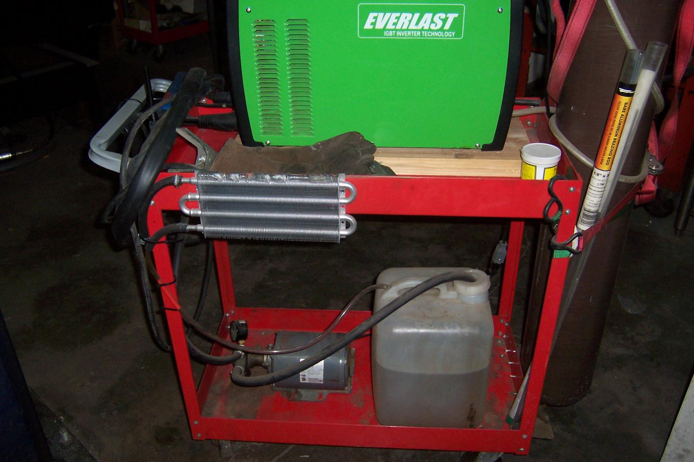

    If you have a a water tap and a place to run a drain, you can use a water cooled torch for a few bucks worth of fittings and hose. Just crack the faucet so you don't over pressure it and most importantly, don't forget to turn it on.
    I have a friend that just use his shop water but has 2 filters before it go through the torch , back in the old days that's what we had for are helio arc welders to cool the torch talk about dinosaur welders . here isClick image for larger version.
ID:	6212 what i am using for a cooler works good. some day i will put all the cooling stuff in a case and maby add a fan since have 2 or 3 blower fans at the shop
