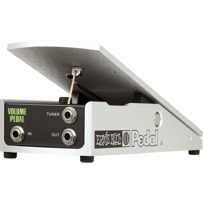

    don't know if it would work on my compressor since i run 175 psi . it is a neat setup thanks now i see how it works , hey was surfing ebay think this would make cool tig peddle http://www.ebay.com/itm/Morley-EOV-O...item2ebc88555a or this peddleClick image for larger version.
    I don't see a max psi listed, but you would need to go with a different hose.
    BTW with till you get some metal shavings in that pedal!!!!
