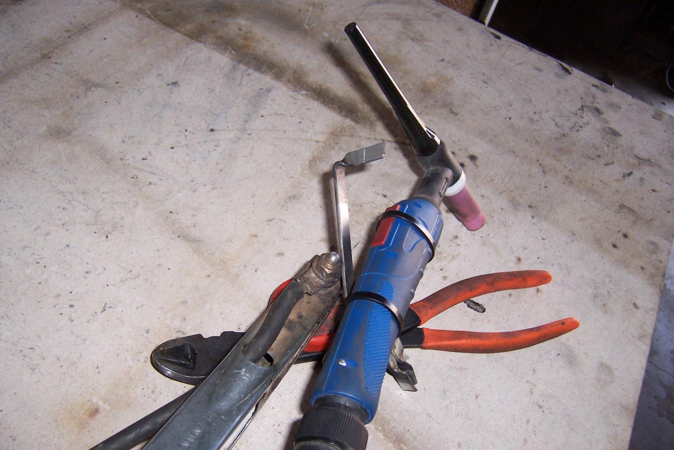

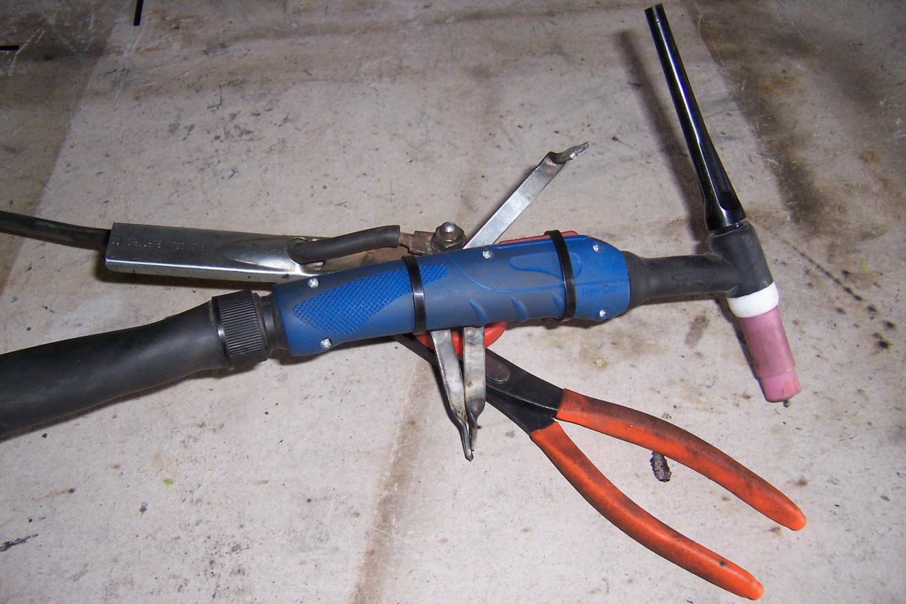

    Been working on a system to control amps that like a foot peddle so working on a set up you use your thumb like pushing a foot pedal . first proto type . already have the electronicClick image for larger version.

    made a box with the micro switch and potentiometer and it uses a bicycle cable to work the potentiometer
    i dont like thumb wheels used them hard to work with a welding glove. the flat one you push with your thumb but found need to move the lower arms back so not in the way when holding torch. also though maby a gear and and slide so wont have anything stick down under torch. tried hooking to regular pedal and have pull pedal down but spring in pedal is to strong
