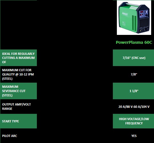

    I don't see HF listed in the description... Source: http://www.everlastgenerators.com/Po...0C-366-pd.html
    Features & Benefits
    - High Voltage/Inductor Start is excellent choice for CNC operation with the fastest pierce times. This is different than HF starting as the frequency is lower, reducing the risk of interference associated with typical HF/HV starts.
    Look @ link below.
    http://www.everlastgenerators.com/pr...tegory-57.html
    I see that one... it needs to be fixed.
    Fixed...Again. It was fixed before, but at some point, the web guys did not back up the right version of the page.
