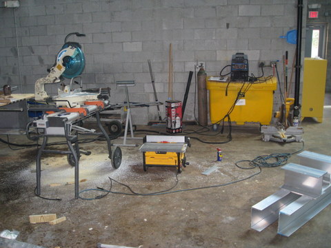

    i do a good amount of field fabrication of aluminum. i don't even pack a plasma, it has it's uses but this isn't one of them.
