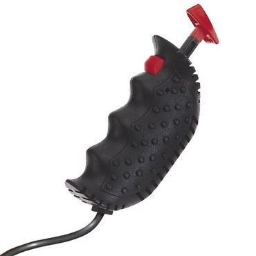

    you know what would work instead of a foot pedal a slot car controller. Click image for larger version.
ID:	6155 all a foot pad is, is a rheostat with a gear on it and a cog belt the turns it
    how are you supposed to hold your filler and that?
    Journeyman welder
    250EX
    Power plasma 60
    horizontal band saw
    strap it to the side of the torch and use your thumb to push the plunger up and down plus holding the torch with palm over torch button would squeeze switch on, then your other hand is free to use for what ever
