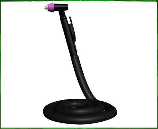

    I have a PP205 (50a plasma) Can anyone recommend a roller guide as well as a radius guide that will fit my torch. Checked the one on everlast site out and looks a bit thin?
    Some on ebay, but not sure if they will fit?
    I don't think there is a roller guide for the standard torch. There's no flat area for it to sit. (untapered)

    The Guide in the right of the picture fits your Torch.
    The US Office should have these in stock as it is a common part that we carry
    Cheers
    Duncan

    THanks....Do they have a radius guide too?
    I thought you may have had this torch. Click image for larger version.
    A roller guide makes a big difference in your cuts. The edge will be much smoother.

    Thanks Zoama...The torch that I have is the one that came with the PP205 from Everlast.
    I have an AG-60 torch and bought one of these
    http://www.ebay.com/itm/Plasma-cutte...ht_3588wt_1164
    my torch looks like this and it fits fine

    The AG-60 has ceramics with a groove so you can use a wire stand-off. Also, river-weld (and all his many river names on ebay) is a good guy to deal with.
    Duncan and Jean in Canada (everlastwelders.ca) will always have what you need as well.
