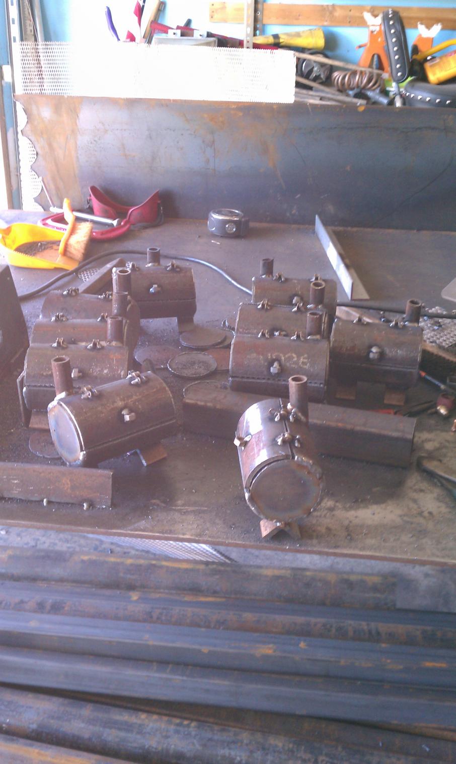

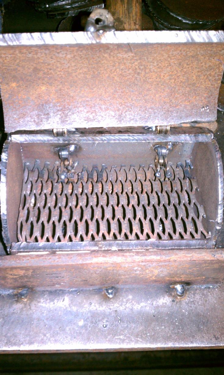

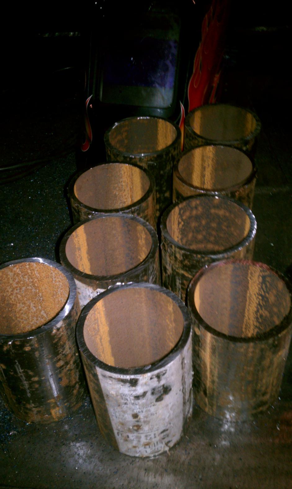

    Here a few pics of these lil smokers that I made for a friend. They are made with 3" schedule 40 pipe and 1/8" sheet steel on the ends. Some angle for the legs and expanded steel for the grate. Hinges are made from bicycle chain.

    Well a friend of mine came to me and had seen one somewhere. He asked if it could be made fairly cheaply. I made a few sketches and then priced the mats. gave him a quote and he said go for it. He loves to bbq and what cooler than to have a lil bbq for an ashtray on your table. It at least makes a good conversation piece. He has a few other friends that have bbq restraunts and such. So, I beleive they will end up there. And as you well know patrons of restraunts will find a way to break anything they can. Bulletproof? not so much. At least not yet. Give me some time and I will make them bulletproof. The hinges will need to be revamped or go with a heavier chain. Bicycle chain is a little weak for the hinges on the lid.
