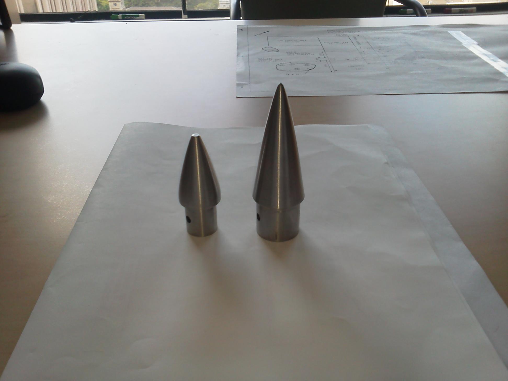

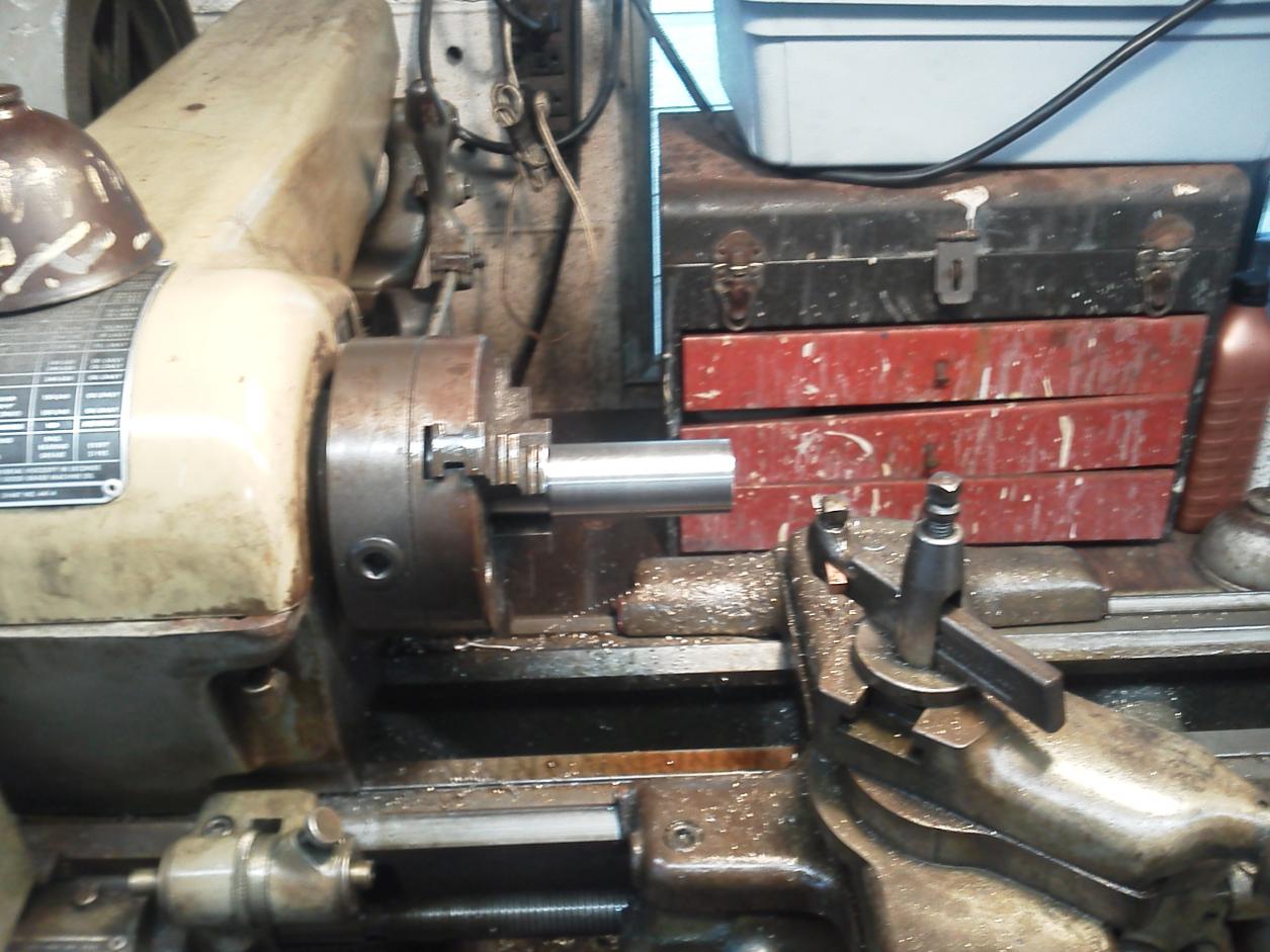

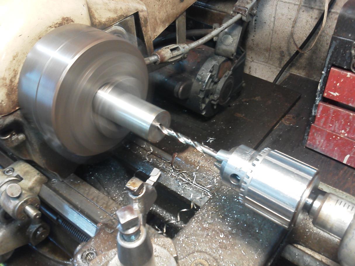

    I finished the two spit rod tips I wanted to make. First made some calculations (they were wrong turns out) about how long the round stock should be then put it into the lathe. I drilled a 3/8” hole on the back end so I could spin it in a ½” drill chuck to get the tip smooth after turning it on the lathe.

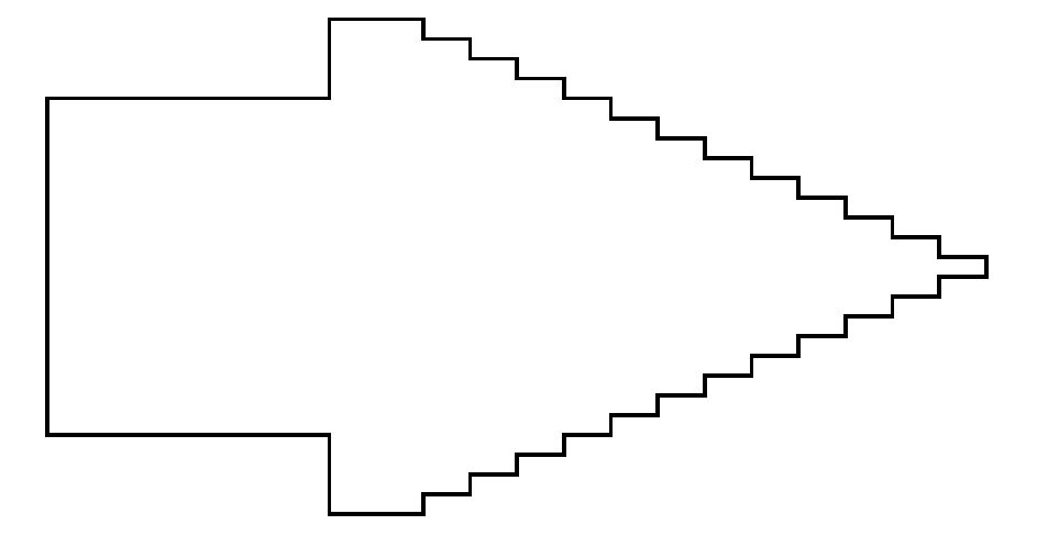

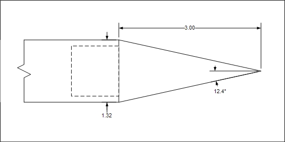

    Next cut the shoulder to fit into the spits ¾” and 1-1/16” both by 1”. Flipped the stock around putting the neck into the chuck jaws and started cutting the tip. Forgot to take pictures but here is a drawing.

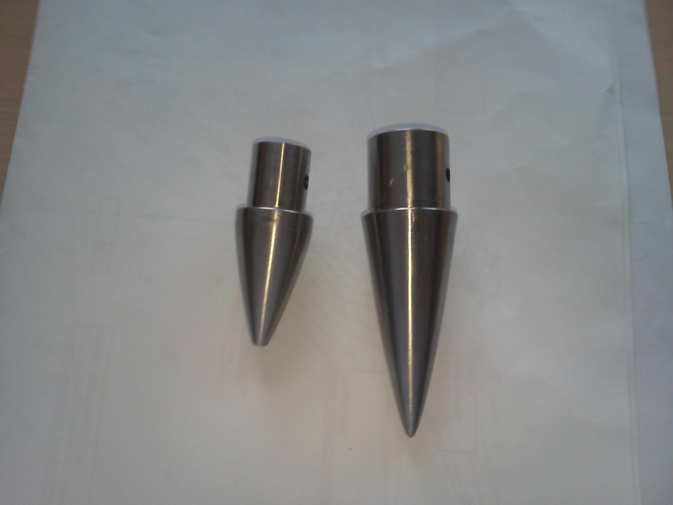

    Once the tip was rough cut inserted it into the spit found center and drilled a 3/16” hole. Pulled the tips out cleaned up the tips and the spits and inserted the 3/8” shaft into the tips and drilled a 3/16” hole in the shaft. Attached to the drill had a friend hold the drill and spin the tip and went at it with the grinder.

    Finished with some fine paper in the lathe and the final product was what I wanted. There are things that didn't turn out as I expected like the shoulder to the neck is not exactly 90 degrees and the ends of the spits aren't either, but it will turn what I need.

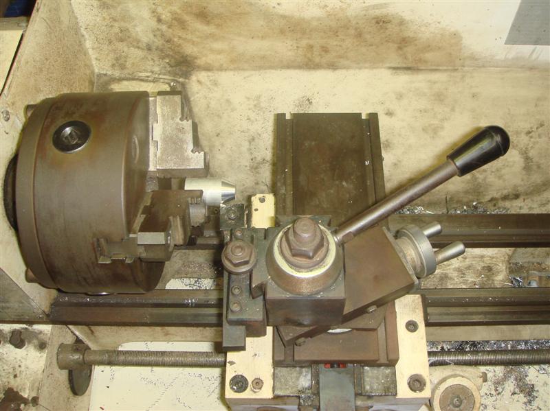

    Why didn't you just turn the angle you wanted with the compound on your lathe?
    i have a cross feed on my lathe makes it easy to do angles when doing stuff , the tips turned out nice looks good to me
    Using a lathe is new to me and I'm not quite sure how to do it that way. I know you have to turn the rest to the angle you want and start there. Then move the rest and cross slide but I'm not sure how to calculate the travel. Any help/explanation would be great.

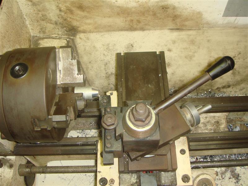

    No problem. You simply rotate the compound rest to the angle you want to cut, and then use the compound to feed the cutter across the part. You can use the cross feed to advance the cutter for each pass. Sometimes it helps to lock the carriage to keep it from moving. There is a book that South Bend has been printing since the dawn of time (early 1900s) that you might want to get. It’s called “How To Run A Lathe”. You can find online scans and I think you can even buy a current printed version from South Bend. Without a doubt a lathe is one of the most versatile machine tools you can own.
    Here I have the compound rotated to about 30° to make a 60° point on the end of some stock.
    Start here…

    And end here, by advancing the compound feed.

    For something like what you’re doing, I would probably just eyeball the angle. However, if you wanted something precise, it’s not hard to calculate the exact angle to use. For your large tip, the pipe OD is 1.32” and you mentioned that you wanted a 3” long point. So that will be a right triangle with the radius (.66”) as the short side and 3” as the long. Do the trig or plug those numbers into a handy online trig calculator like www.carbidedepot.com/formulas-trigright.asp and you get an angle of 12.4°. You can do it in sections if the travel on your compound isn’t long enough, but I think on an SB9 you should be pretty close.
    Rambozo thanks again for the information and help. That is a great link and it will help with my project this weekend.
