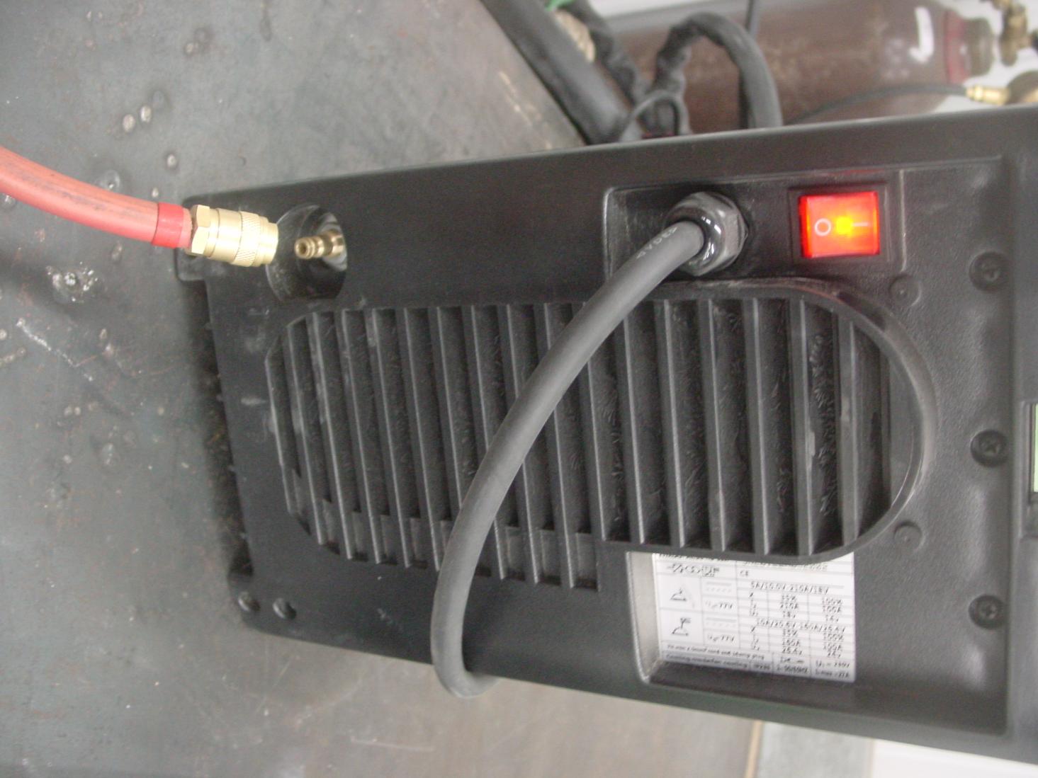

    I know everyone like pictures, so here's a few more...
    Ed, I think the processor is the tiny thing that I'm pointing at with a philips screwdriver. It's Very small with no markings.
    I still haven't located an arc gap, I'm thinking it must be gapless.

    What Amazes me is how well made the everlast welders are made . looking at the circuity boards in this unit looks like they did not cut corner notice had large capacitors and they are using over kill resisters which is good . I have the 250 tig and there plasma cutter . there very well made machines , what is good about the everlast company they take care of you , Had miller tig and it was act of god to get them to help you when something broke . With everlast there rite there to help when something go wrong . there honestly the only company i will buy welding stuff from now on , since of there great service
    Another nice thing is all the boards are potted, they have a clear sealant on them for protection.

    By looking at the pictures of this unit, I am thoroughly impressed. All the component locations look well thought out and the wiring is nice and neat inside. It looks to be a very well built machine and of top quality. I'm really liking the gap-less HF as well. I'm still in the "saving money" stage of my welder purchase and I was looking forward to purchasing a 250EX but now I think I'm going to have to consider this 210EXT as a possibility as well. I'll just have to decide whether or not I'll need the extra 40 amps or not. Could somebody post up the full specs on this unit. Such as the duty-cycle at the full 210Amps and at what amperage the unit will run at 100% duty-cycle. Also do you know what the final price will be once this unit is in full production? Thanks.

    Yes, that is the processor. I am not sure what brand it is. But the IGBT modules are not Siemens, but an American known company, International Rectifier.
    If it is the chip with the most leads, it probably is. That board sure has a whole lot more SMDs than the 250.

    Are the bright spots in the 7 segment displays that noticable in real life or is it just the camera?
    I like the welder only turn off for me i like knobs not all the sensor push pad stuff . like to just reach over and turn a knob and not have to turn a knob to get to what mode you want to adjust . that's why i like my 250ex so use to it now can reach over with out look to adjust stuff lol when dieled in almost never have to do any change when welding aluminum
    It's very easy to read, the camera makes it look bad
    I have a 250EX also, I agree, the visible knobs can be great for quick adjustments. Where the digitals are nice is if you want to flip between programs ( there are 10 stored programs ) and have the exact settings every time. Different strokes!
