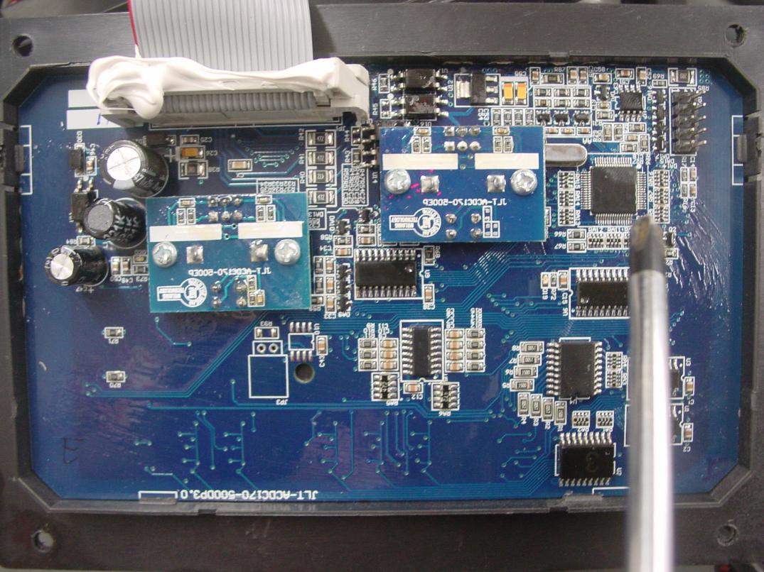

    Mark, is there any info on what microprocessor it has?
  10. #30

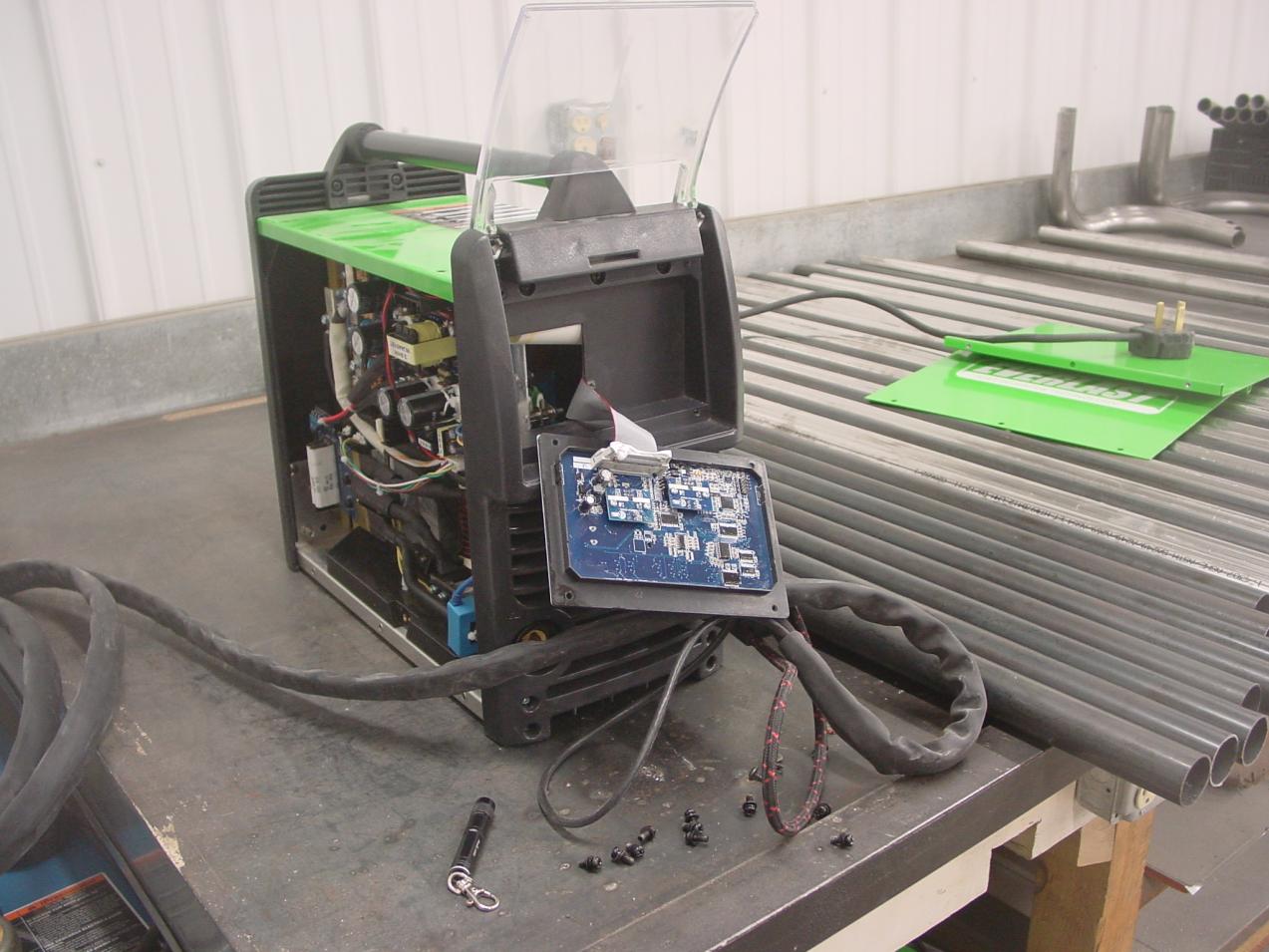

    I know everyone like pictures, so here's a few more...
    Ed, I think the processor is the tiny thing that I'm pointing at with a philips screwdriver. It's Very small with no markings.
    I still haven't located an arc gap, I'm thinking it must be gapless.

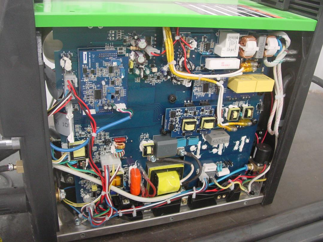

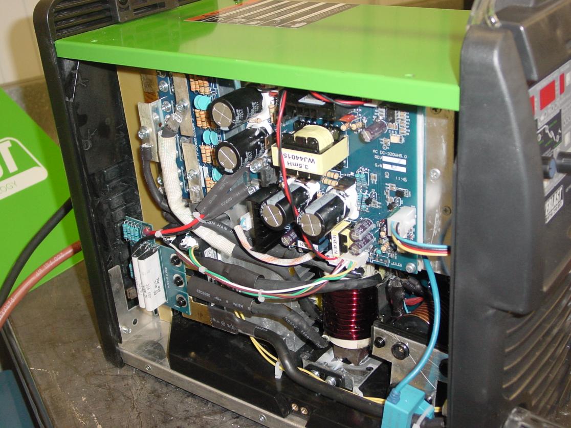

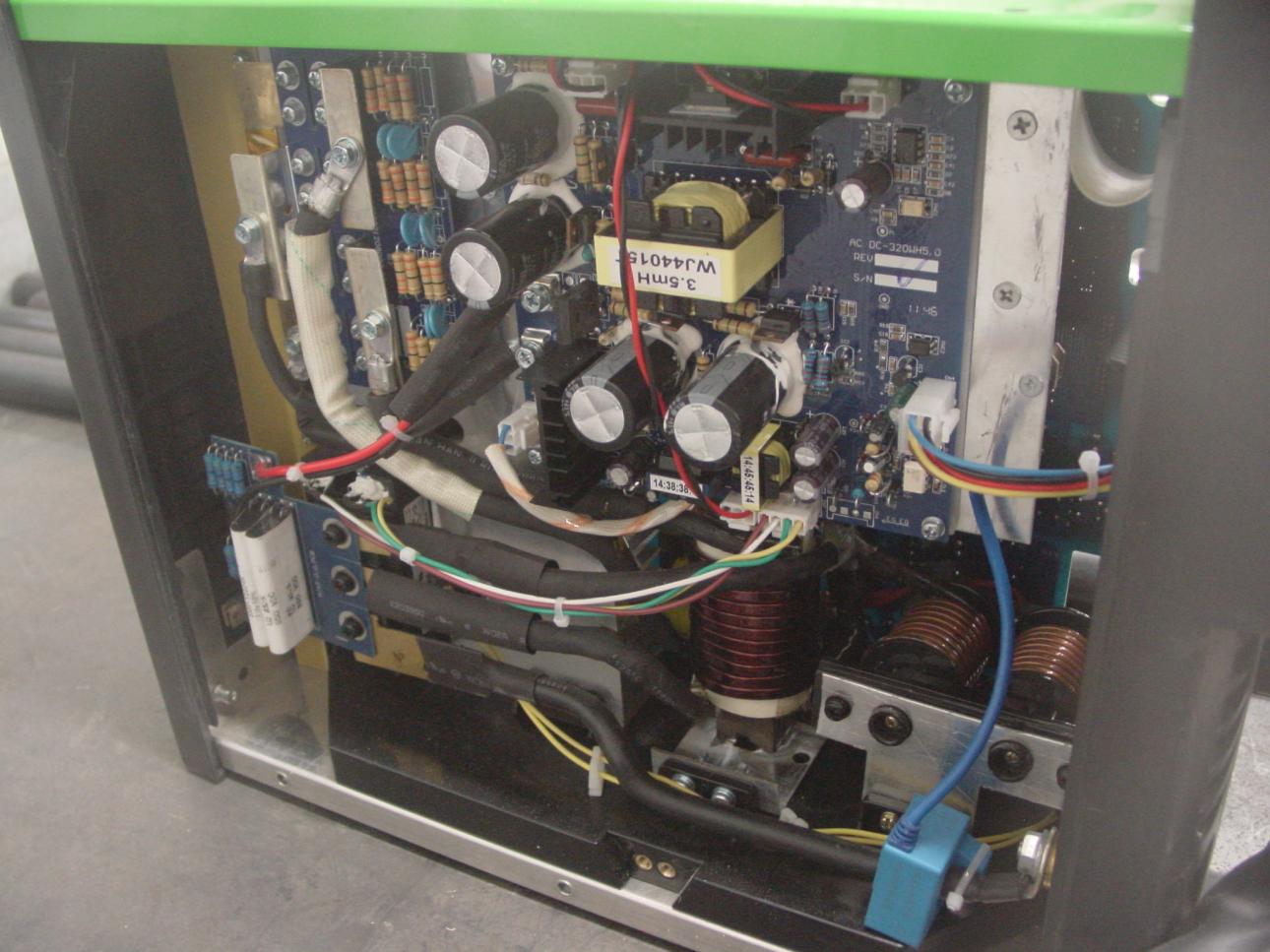

    What Amazes me is how well made the everlast welders are made . looking at the circuity boards in this unit looks like they did not cut corner notice had large capacitors and they are using over kill resisters which is good . I have the 250 tig and there plasma cutter . there very well made machines , what is good about the everlast company they take care of you , Had miller tig and it was act of god to get them to help you when something broke . With everlast there rite there to help when something go wrong . there honestly the only company i will buy welding stuff from now on , since of there great service
  12. #32
    Yes, that is the processor. I am not sure what brand it is. But the IGBT modules are not Siemens, but an American known company, International Rectifier.
  13. #33
    Another nice thing is all the boards are potted, they have a clear sealant on them for protection.

    121
    By looking at the pictures of this unit, I am thoroughly impressed. All the component locations look well thought out and the wiring is nice and neat inside. It looks to be a very well built machine and of top quality. I'm really liking the gap-less HF as well. I'm still in the "saving money" stage of my welder purchase and I was looking forward to purchasing a 250EX but now I think I'm going to have to consider this 210EXT as a possibility as well. I'll just have to decide whether or not I'll need the extra 40 amps or not. Could somebody post up the full specs on this unit. Such as the duty-cycle at the full 210Amps and at what amperage the unit will run at 100% duty-cycle. Also do you know what the final price will be once this unit is in full production? Thanks.

    Todd, I like how you get right into things. Great pics.
    That black "structure" at the base of the unit is kind of interesting... I wonder what it is.

    ...That black "structure" at the base of the unit is kind of interesting... I wonder what it is...
    Probably the IGBT module.
