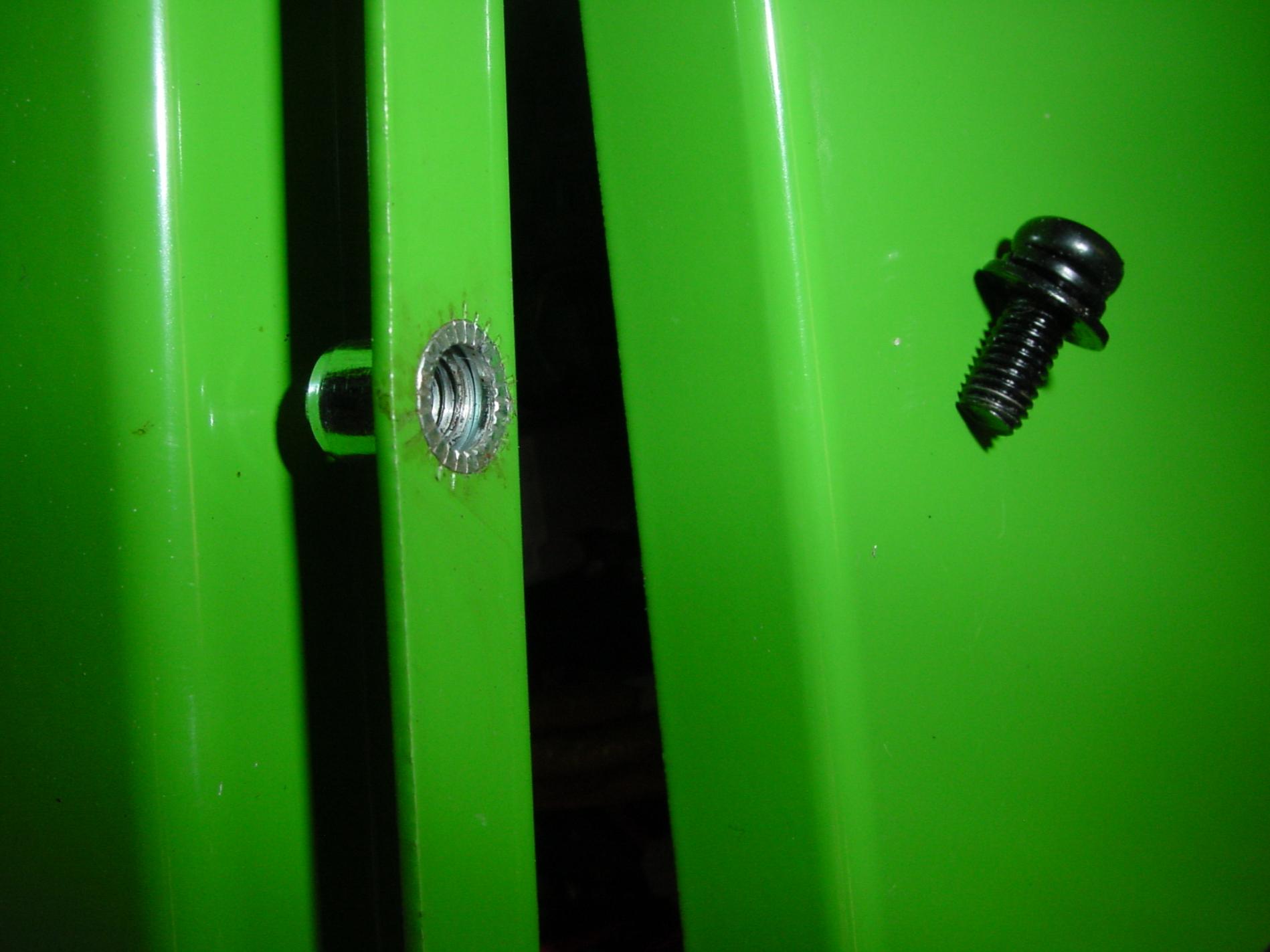

    The case has been brought up to a higher standard, it uses machined screws with captive washers and nutserts in the chassis, the screws are a nice quality black oxide, and the holes line up like they should ( this is a small detail, but it shows that they are working to bring the standards to a higher level ).

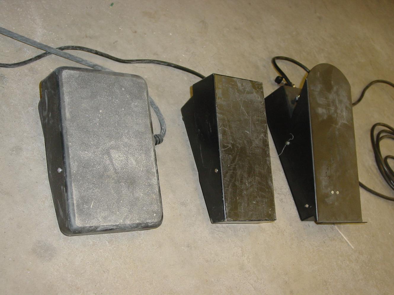

    The foot pedal works like it should, it is a different design than the other Everlast pedals, and it seems pretty nice. It has a smooth metal top, I would probably but some non slip on it and a hook for you heel for easy positioning.

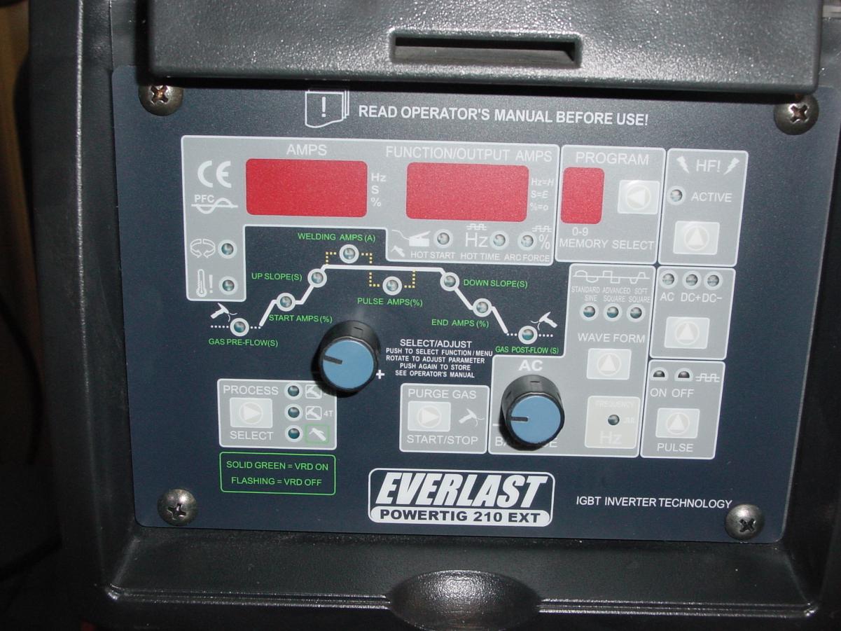

    In the second menu,have 10 channels
    D01: Vacant
    D02 :High voltage stricking ARC time :0.5-2S
    D03: High voltage stricking ARC frequency :10-100HZ
    D04: DC High voltage stricking ARC current :10-100A
    D05 :AC high voltage stricking ARC current :15A-100A
    D06: Vacant
    D07: AC DC LIFT starting ARC current :10A-100A
    D08: For Adjust the fingertip AMP control TORCH."00" --4T power off ;"01"-- 4T is on
    D09:For adjut the VRD ."00":VRD is ON ;"01"VRD is OFF
    D10: For the AC Pulse selection. "00" means single Pulse ,only AC ;"01" means double Pulse .
    Attention :
    1)D08: "00" is for normal torch or called non fingertip AMP control TORCH, means when you are using an non fingertip AMP control torch for the machine ,first need enter the channel D08, and set "00",then you can switch 2T to 4T ;if you use fingertip AMP control torch ,must set as "01",if not the machine will detect and switch to 2T by itself ,Some peopeo dont know this function ,they think our machine has problems .
    2).D09 :"00" mean Voltage less than 24V; "01" means Voltage more than 67V
    3) D10: Under Double Pulse ,the peak value is AC ,base value is DC.
    Double pulse mainly used for thin sheet welding ,with Double pulse ,the thin sheet not easy to get bent while welding .
    So after a few adjustment I was able to get the start amperage down to a very low level for thin material, but still have the option of raising the amperage for sure starts on heavy, dirty, cold metal. ( pretty neat option ).
    The control panel is very small compared to the 250EXT, larger, bolder, brighter lettering would be a good thing on the printed parts, the LED's are very easy to see. The control works different than the 250EXT, and it seems to have a little more of a learning curve, but once you get the hang of it, it's very easy to use and does everything it's supposed to do.
    I haven't used the welder at every setting, but I have used a lot of the settings, so far I have not been able to spot any problems, the only limitation i have found is that AC pulsing caps out at 10HZ, but the DC pulse which is more important to me goes to 500HZ.
    The welder feels strong and smooth, it feels just as smooth as the 250EXT ( once you get a flame established with the 250 ), it does not have the top end grunt of the 250 for puddling heavy aluminum castings, but up to 1/4" is no problem.
    The 210 did not come with ground cable, regulator, consumables, or instruction manual, so I cannot comment on those items, but I'm sure they will be included with the production models.
    I will keep using the 210, and keep pushing its limits to see if I can find any problems. So far it's doing everything it's supposed to do, and doing it very well.

    The pedal looks like a 1k, the 250's are 50K.

    There are 3 waveforms, I will try them more over the weekend.
    The 210 may have a few more adjustments, but the 250 still has the bias control ( I really like the bias ).
    The feeling I get for the welders is, if your looking for a portable that can do almost anything, the 210EXT is a pretty nice choice ( there is even a quick coupling on the gas inlet for portability). If you are looking for a heavy duty stationary unit that has lots of power, lots of adjustment and water cooling the 250EXT will be the ticket once the last bugs are ironed out.

    I did not recieve a manual with this welder, so I am not exactly sure on the balance control. It goes from -30 to +30, which would imply 20-80 balance. It gets you well into the range of being able to use a pointed tungsten on aluminum.
    I know Oleg was going to check with the factory on a couple of things on the ranges and settings, .2 or even .1 may be do-able on the pulse, It's not every day you need a 10 second pulse rate, but there may be times when it would be handy.
    Edit: Another really cool option with this welder is that you can set the pulsing so it cycles from AC on the high side of the pulse to DC on the low side of the pulse. I will try these settings this weekend also, and see what effect these settings have on thin aluminum. It's pretty wierd to listen to in use, buzz-smooth-buzz-smooth......
