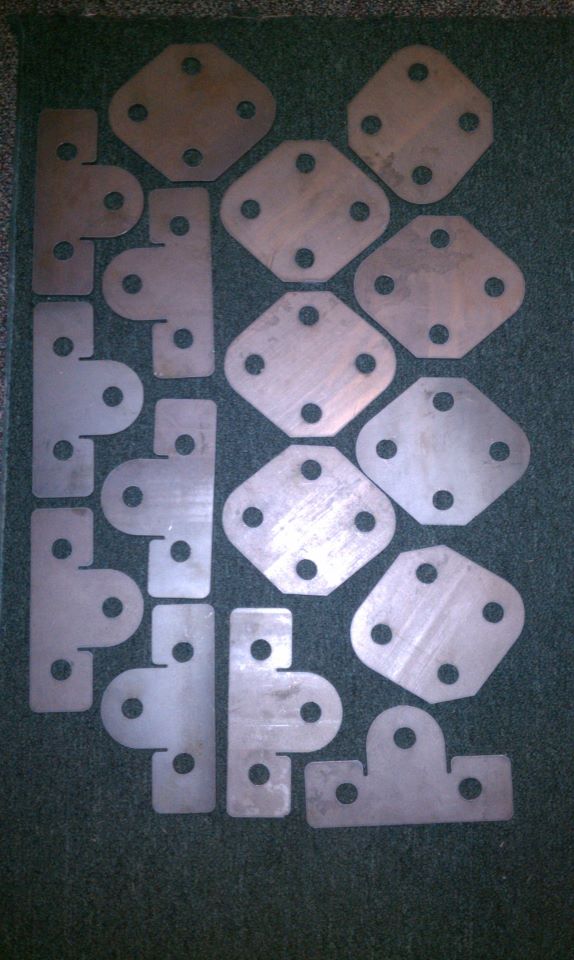

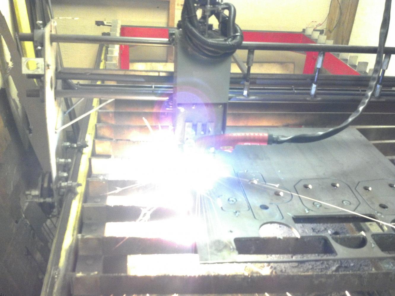

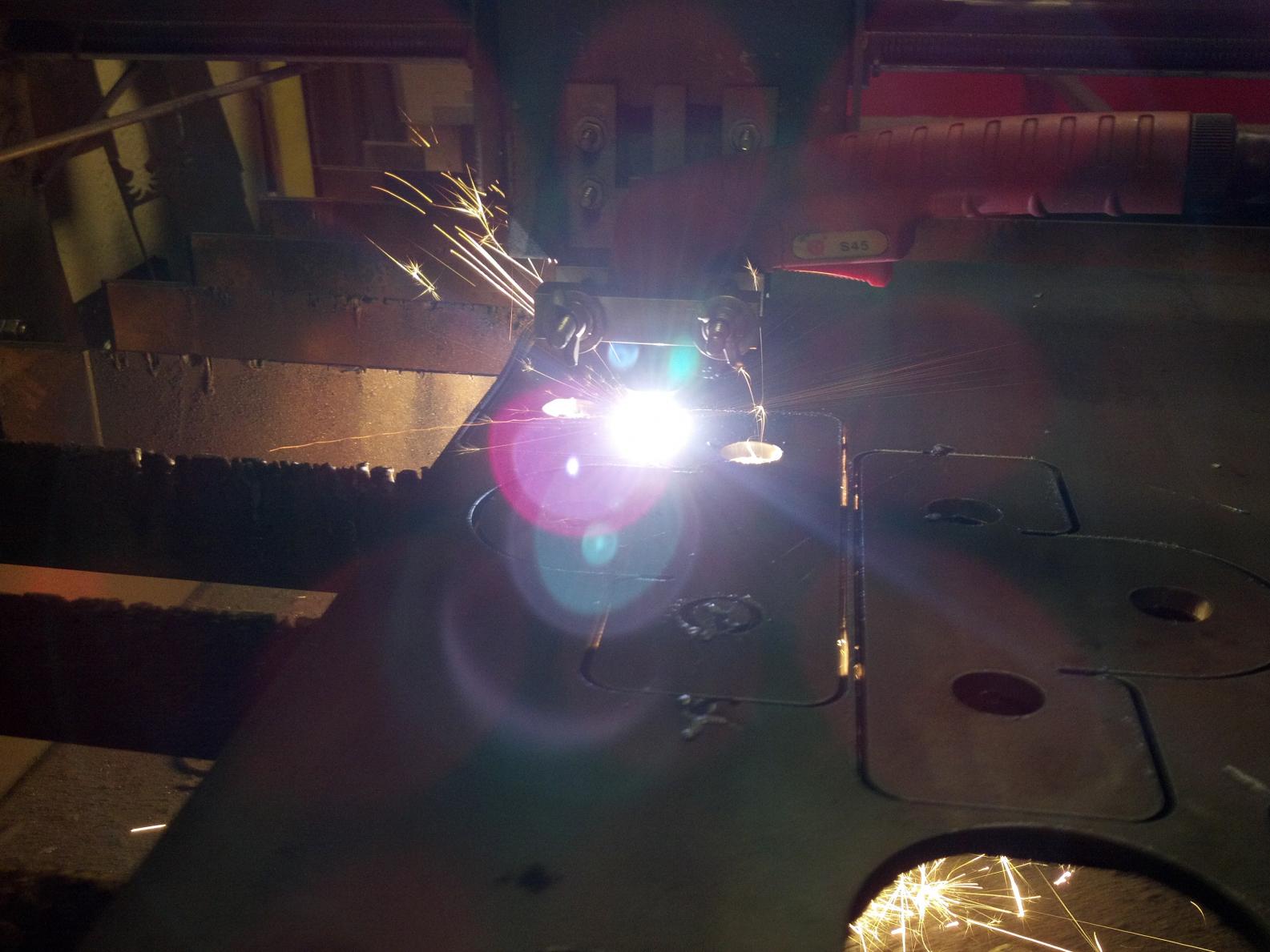

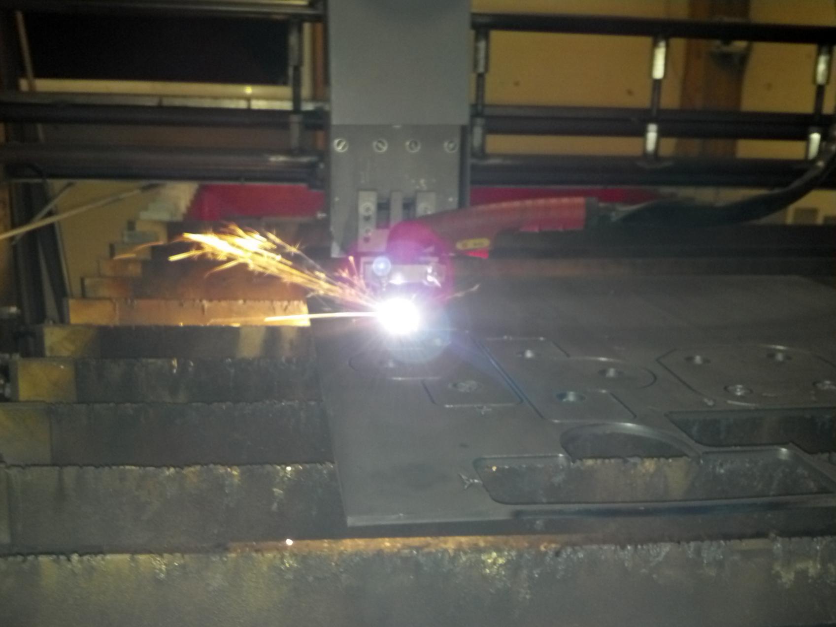

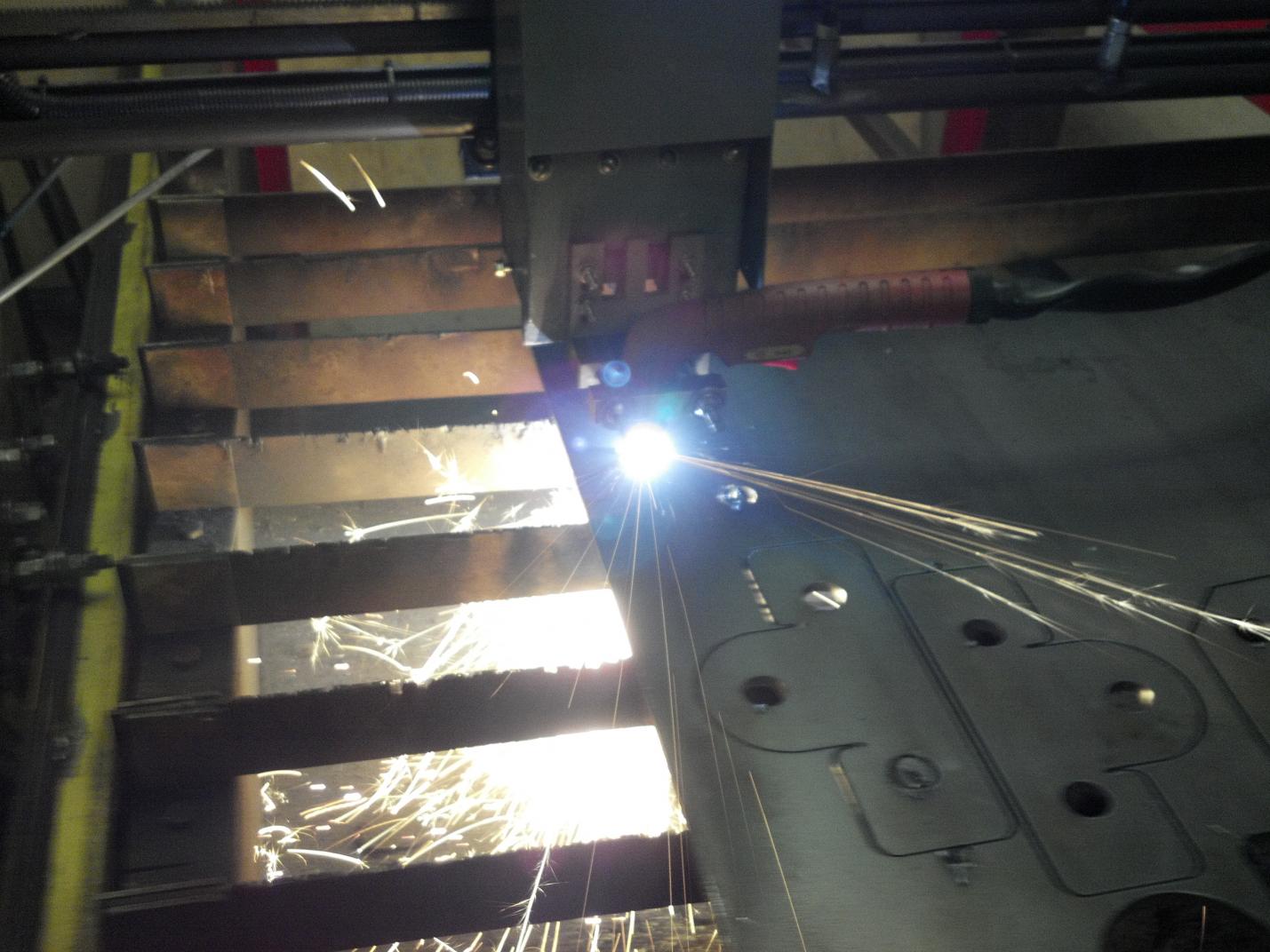

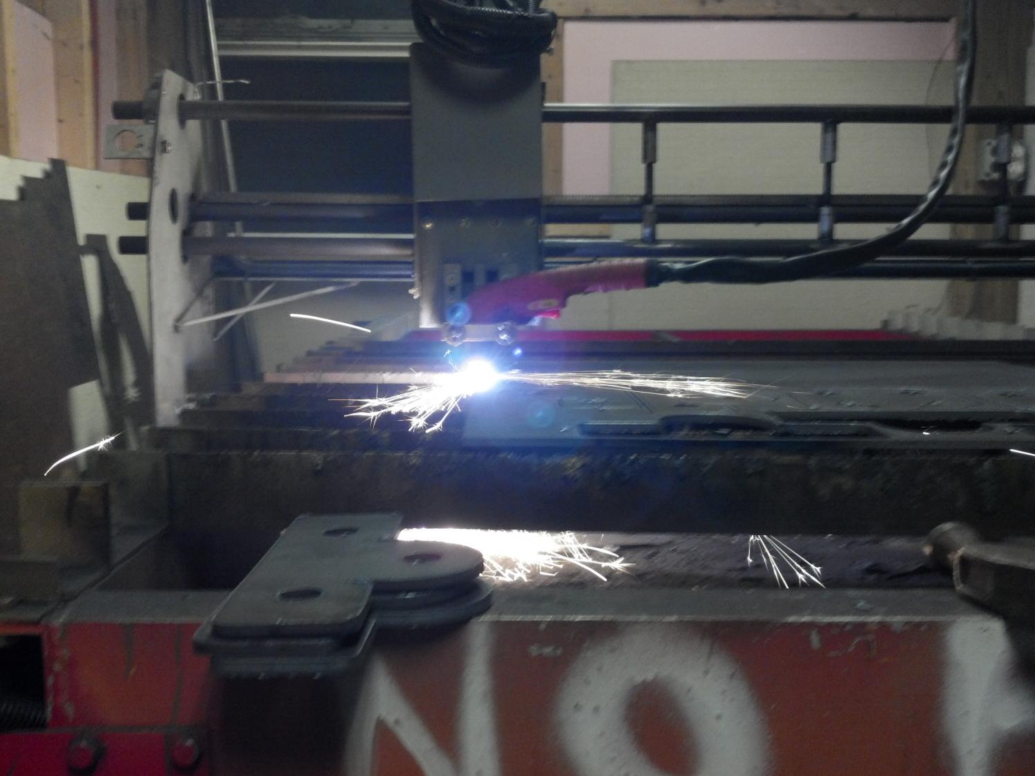

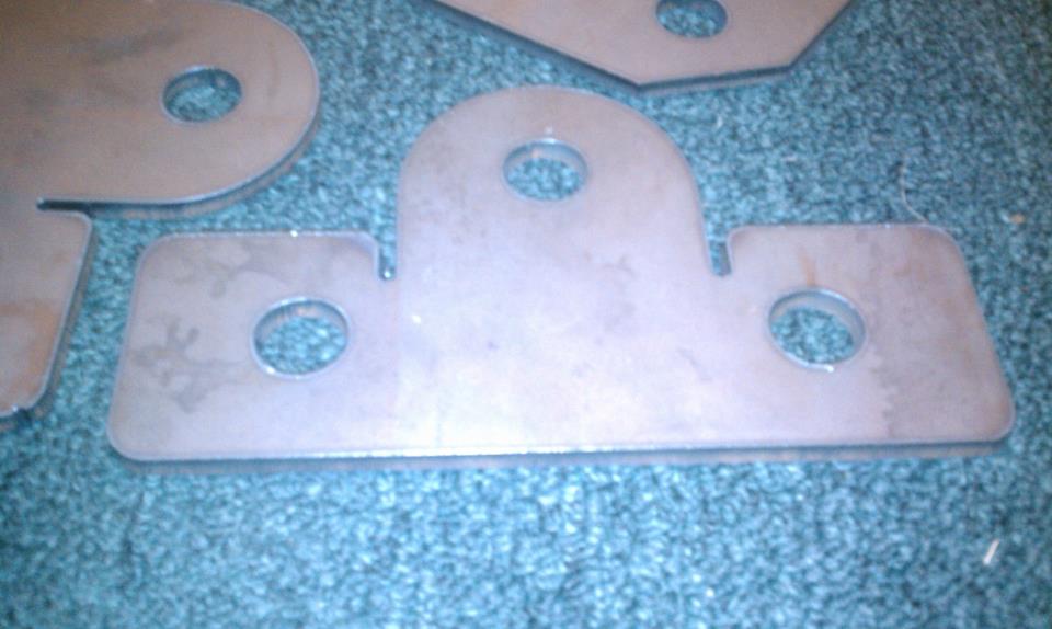

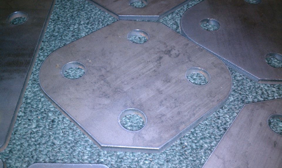

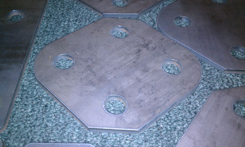

    For those of you who have a CNC plasma cutting table with the PP-50 cutter, here are some specs that gave me great cutting results.
    A customer came to me with a job cutting (16) ¼” thick brackets, and possibly more depending on the quality of the work.
    Apparently the first set of brackets came out great because he just came back for another (32) brackets.
    Here are the specs. I used for cutting.
    PP-50 with the hand torch.
    Material- ¼” A-36 Carbon Steel
    Air Pressure – 65 psi
    Cutting Amps - 45
    Pierce Height - 0.25”
    Pierce Delay – 0.25 seconds
    THC Cut voltage – 106 (around 0.7” cut height)
    Hole Cutting Feed Rate – 25 IPM
    Perimeter Cutting Feed Rate – 40 IPM
    Edge quality turned out great and the 13/16” diameter holes for ¾” Bolts came out with a very minimal bevel & dross.

    Here are a few pictures of the brackets.
