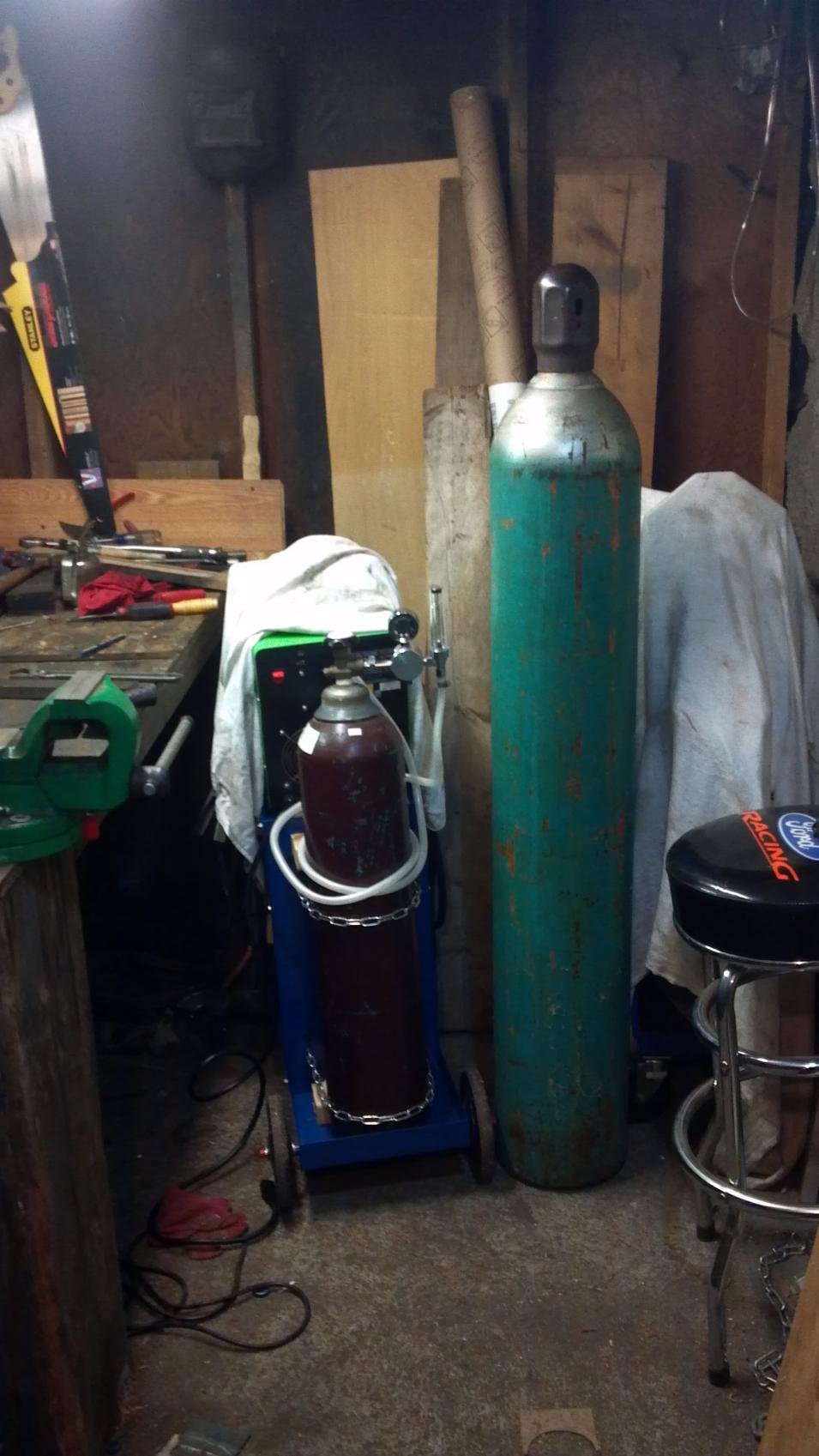

    yeah we shall have to wait and see, not sure what size it is but it has 2000 psi in it a little over. It appears to be 60" tall and 9 or 9.5 inches in diam. I can pick it up and move it around but I am not going to say it is light.
    I would call ahead and see if they would fill it. There is no way in h### that I would allow them to "sieze" it I would stick it back in my trunk tell them where to stick it and leave, I mean they can't stop you or touch you the most they can legally do is call the cops.
    I actualy do not know if I will even be able to use all the gas up before I hope I can move outwest where it won't be a problem. I have an 80cf tank with mix in it and even with what I feel is quite a bit of welding it is still over half full.
    I know what you mean about them lying, and like with cops if you ever ask them if you are allowed to do something they will almost always just say no right away. Most of the time they have no idea.
    Here is the tank next to an 80 sitting in a HF welding cart.

    I would guess that is a HP280 or HP330 if that is an 80 next to it. Over 230 for sure.
