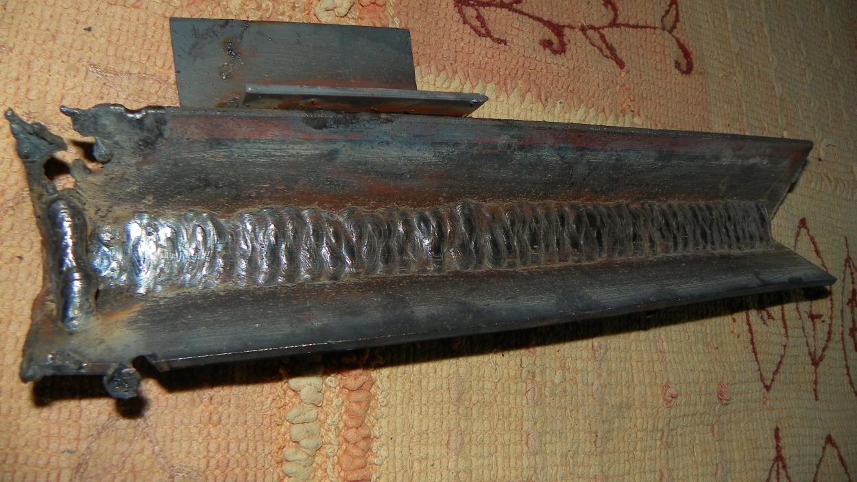

ID:	5969Well, here I have an uphill weld...Four passes of 7018 at 90 amps on 1/8" steel.

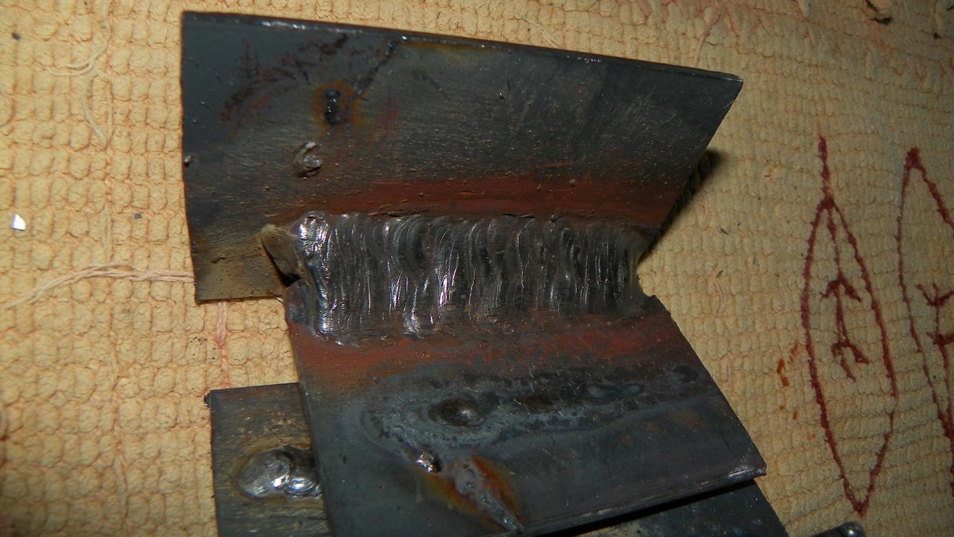

ID:	5967Here I have just one pass of FCAW.

ID:	5968And here I have 7 passes, yes seven passes, of 7018 at 120 amps. The weld is about 1-3/16" wide.
    This was all performed with my Everlast IMIG 200.

    Mighty fine Benjamin. I need to practice a lot.

    Thank you! I am in the process of getting 75/25 Ar/Co2 so that should help me out some with better wire welds.
