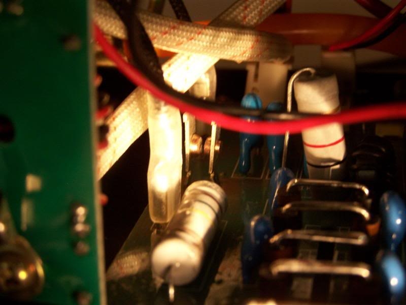

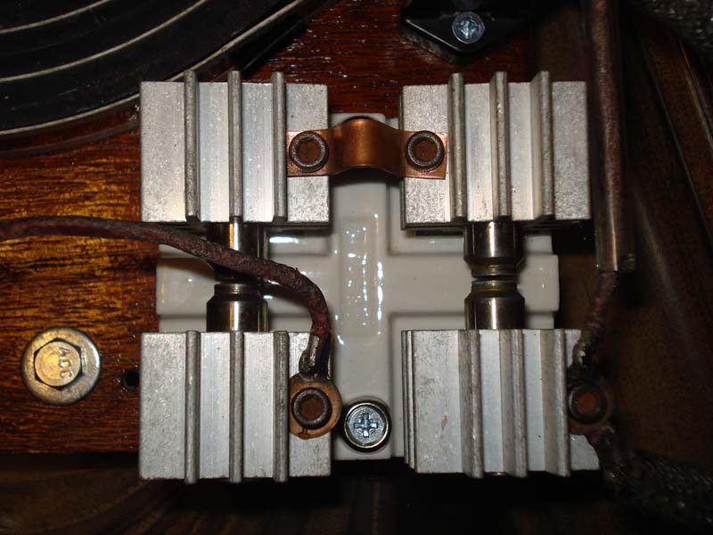

    I've had my Power pro 256 about a year now. When I first got it I tried to weld some aluminum but had a lot of trouble controlling the arc. Over time it just got worse and worse until this month when I couldn't even get the arc to start unless I scratch started it. I decided to open up the unit last night and look at the spark gap electrodes. One of them was twisted like a pretzel. I used a needle nose pliers and straightened them out and set the gap to 0.03" with a feeler gauge. I haven't had a chance to try it out again but here is my question. Do other people find that their spark gaps get misaligned over time? Or once you set them they stay set? My machine has been on a cart in my garage and hasn't moved more than four feet since I've bought it. I looked at Miller's spark gap and they look like something the military would have spec'd out. So I have started to design my own spark gap. I am going to mount it remote from the high frequency board on a piece of polycarbonate. Two aluminum blocks will each hold a piece of 4mm tungsten rod. The gap will be set just like the Miller set up by sliding the rods in the clamps and locking them down. I will round off all corners of the clamp to reduce ionization losses and use good quality high voltage wire to connect the unit to the board. Any thoughts? I think it will make this machine almost bulletproof.

    This should help explain.
    Here is a similar setup in their cut50
Name:	cut50 spark.jpg
    vs
    Miller's
    Mine would look more like this

    The 250 EXT has a much improved set of points. There's a picture of them somewhere on this site.
    I tried to buy a set from Everlast so that I could upgrade my own PP256, but to no avail. I even pestered Duncan to bring me back or ship me a set from China during his last factory visit, but he did'nt do it.
    I would certainly be interested to know how your build turns out.

    If the points are properly adjusted and in alignment they will hold there adjustment and will not wear appreciably. In with Tig welding they should be active briefly when starting the Tig arc. Plasma cutting in the case of a multiprocess unit is a little different as they are firing while the pilot arc is running. But I have never seen them bend from heat.
    The contact faces are made from a very hard metal probably tungsten or hafnium, mounted to steel blades by a copper brazing, this acts as a heatsink and attachment. If the contacts are out of alignment arcing will deposit copper and copper oxide in the arc area and eventually cause the gap to effectively change.
    I’m not necessarily defending the design, as I too would like to see something easier to adjust. But the face of the contact is convex, and when properly adjusted will center the arc in the contact face and create a wide almost corona like arc that sounds like gas flowing rather than a sparking sound. In short I think it works pretty good.
    The Tig welders seem to work the best set around .028” -.035”. mutliprocess machines will require a little wider gap to insure the plasma pilot works reliably, usually .035” - .045”.
    My experience having set many once it set right it will stay that way, barring metallic dust or being out of alignment.

    Tungsten is the preferred material and about twice as tough as platinum. Considering there are plenty of 30-40+ year old welders with their original tungsten points still in service and working well, I don't think lifespan is a real issue. Just look at any older transformer machine that uses continuous HF with thousands of hours on it. Tungsten points will outlive their owner.

    It's true that other welders have more heavy-duty points. Some people say the points erode over time, but I have never had to adjust any of my Miller or Everlast machines. The light weight points work just fine for me, in fact I don't think they would ever be a problem as long as they are not over adjusted and become week.
    The Miller Syncrowave has 3 settings for high frequency start (soft/med/hot) and it will not adjust to have that positive/snap start like the Everlast does, so they do work good.
    I know the points are light weight and I would rather have some heavy-duty ones like the Syncrowave, but if it's going to add another hundred bucks to the list price, I would rather get the light ones and just let Everlast deal with it under warranty if it will not hold it's gap.
