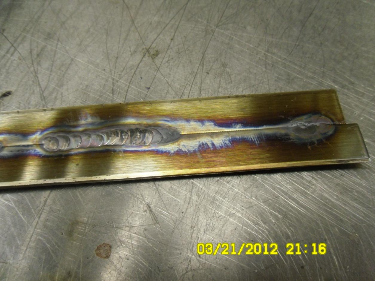

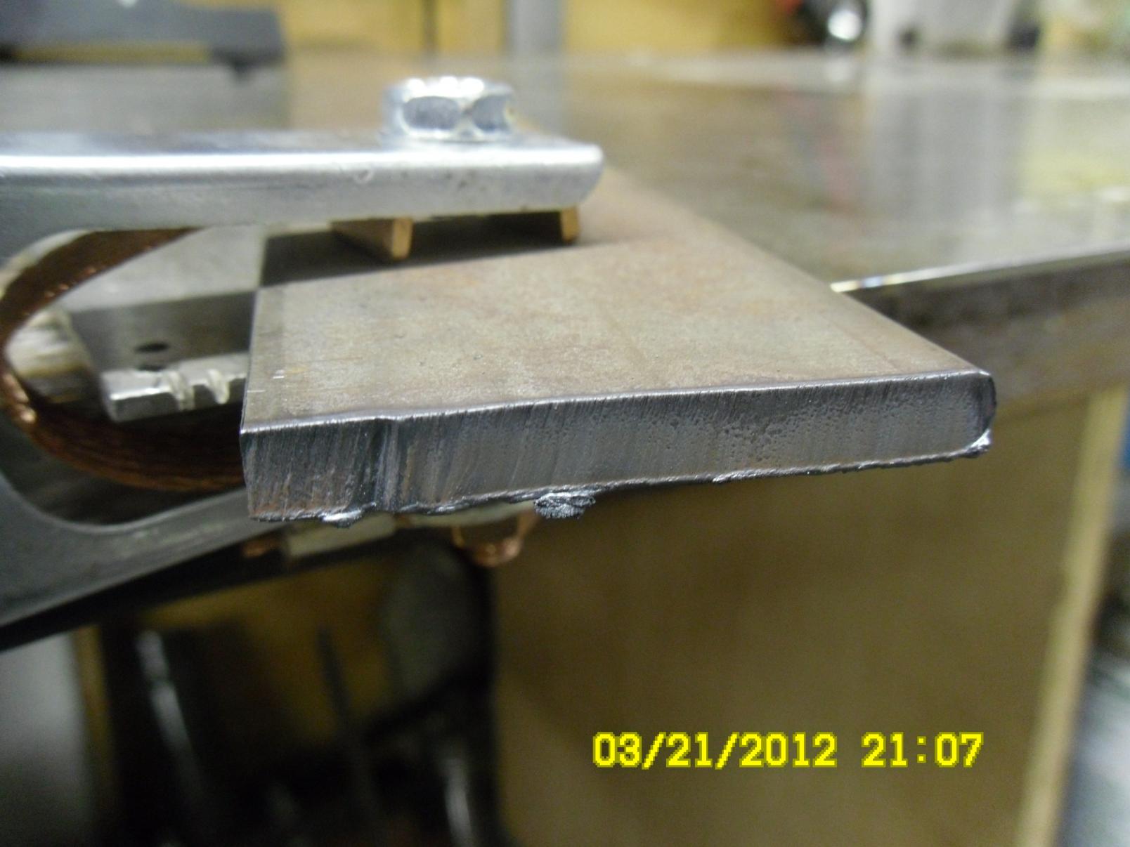

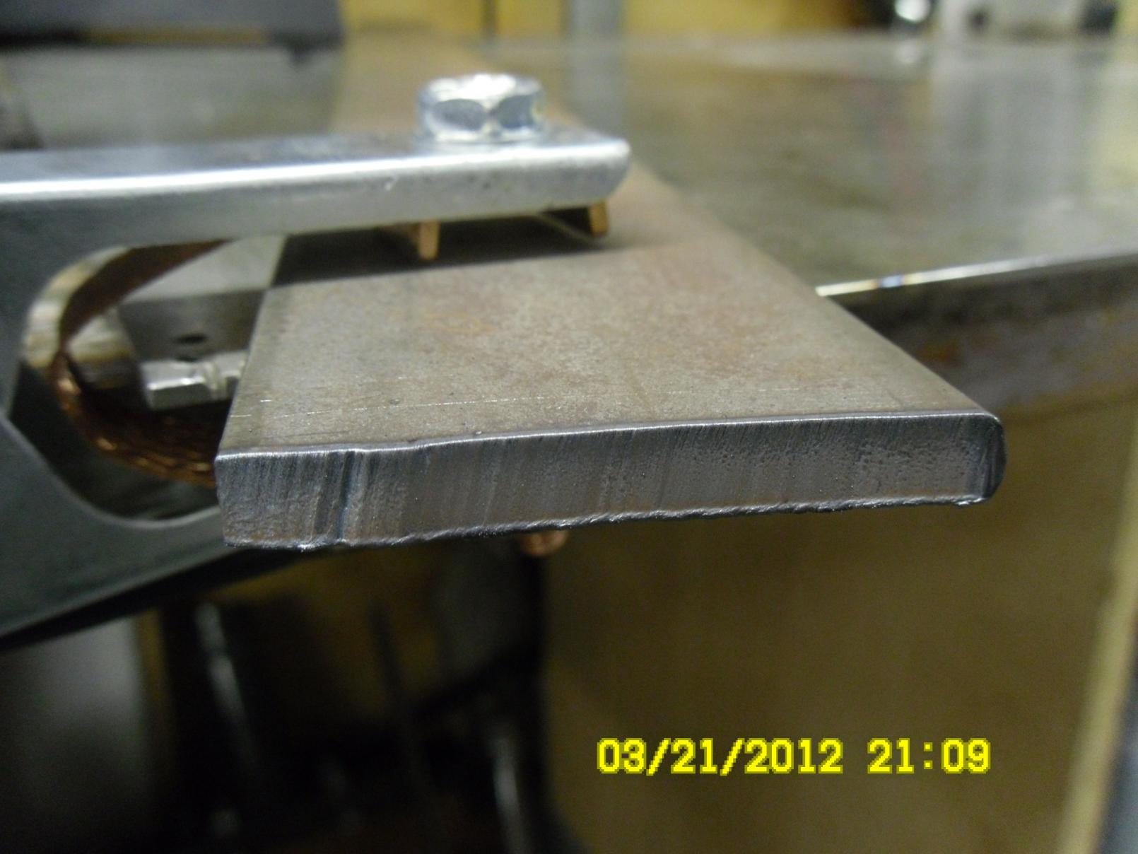

    Here's what I got with the machine on 120v. oh and all i had was 1/4 steel. amps at 45. air at 65psi.
    the welding was all pedal. with 3/32 lant. pure argon. 5 cup.
    220v cut
    120v cut

    120v fused
Name:	120v fused.jpg
    The machine didn't hiccup at all. hope this helps.

    sydneysdad, thank you very much. Did you drag cut or hold the cut about 1/16" -> 1/8" above the metal? Your PU205P definitely cuts better than mine on 120V. Thanks again,
    Ken
    __________________________
    Everlast Power I-MIG 200
    Everlast PowerUltra 205P
    Everlast SM 200-N
    Thermal Dynamics Cutmaster 42
    Quote Originally Posted by kenwhite View Post
    Ken
    I dragged it on the wire guard thingy thing? what ever its called.. lol which is about 1/8 from the surface.

    That is some pretty nice cut quality on both the 220 and 120V cuts.
    If Ken gets his figured out, I think I know what my next machine purchase will be...
