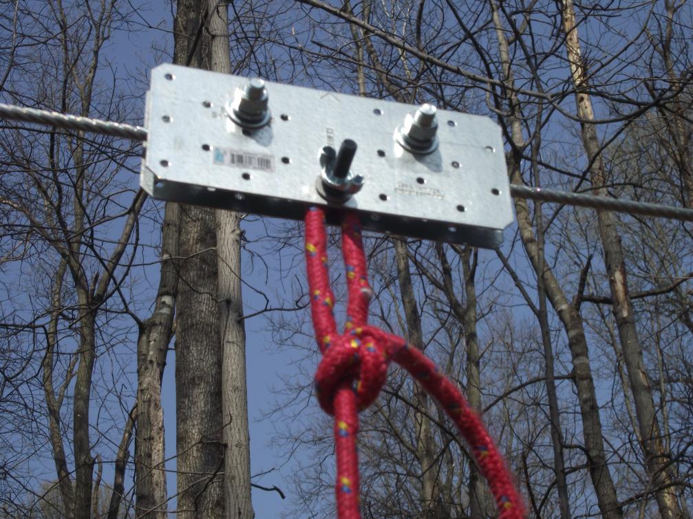

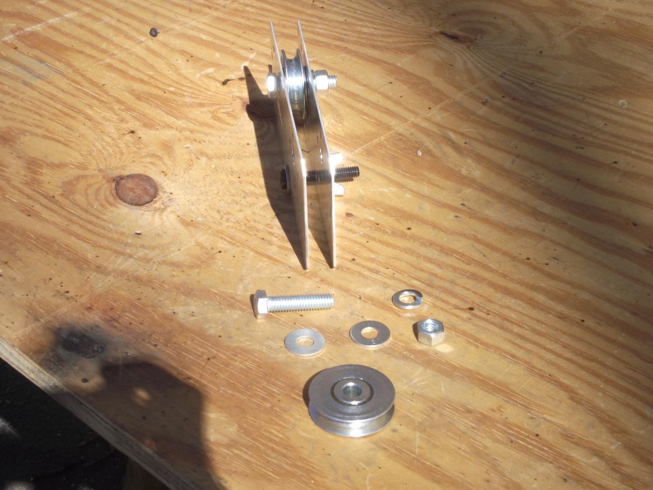

    This is a quick and fun build- I've had the idea to set up a zip line ever since we had fun on a zip line at a picnic last summer. Zip line trolleys, the part that skims along the cable, retail from "stupid" to "insane" so I picked up some pulleys at McMaster (thanks again, Sportbike), some construction ties and hardware at the Home Deep, and started assembling.

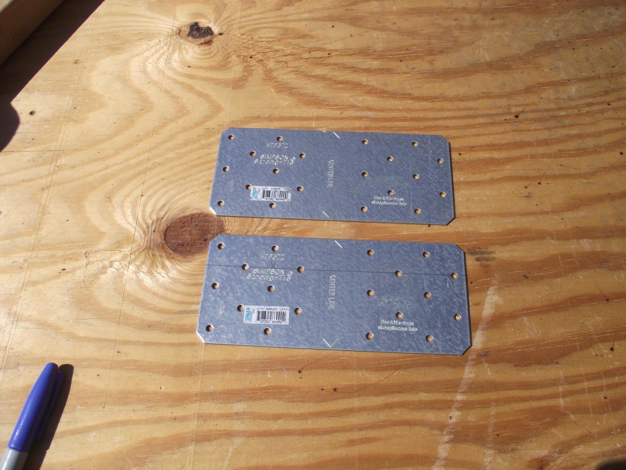

    I attached the two ties to a chunk of 2x4 before drilling so they'd result in a mirror image, and line up nicely. The pulley axle holes are 3/8" so I bought hardware to match. Then a quick monkey swing: traced the bottom of a bucket onto some leftover plywood, jigsawed and sanded, then a hole drilled for the rope. I had 50' of 1/4" cable so I attached a thimble and clamps to have loops in the ends; I roped one end of the cable to a tree and used a cable puller as a tensioner at the other end.
    All in, about $20 for the cable, maybe $10 for hardware, and $13 for pulleys (I forget what shipping was from McMaster, but reasonable). Smile on 6 y.o., priceless. Next step is to get a 100' or better cable, because 50' is just too short!

    Instead of a bolt to hold the line, you could use a shackle instead and it would reduce the possibility of cutting the line.

    Agreed, that bolt's been on my mind too, and try not to notice the rope fraying in that third pic. I was at the HD looking for hardware and got a phone call from my wife, problem at school so had to move fast, and forgot the smooth axle for the swing. But I take it down completely after every use, so I'm able to inspect all the parts for safety every time I set it up.
