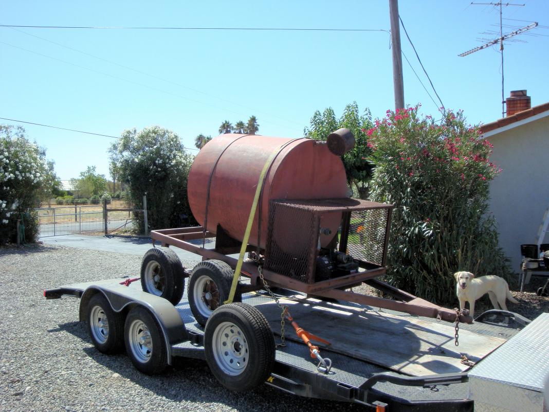

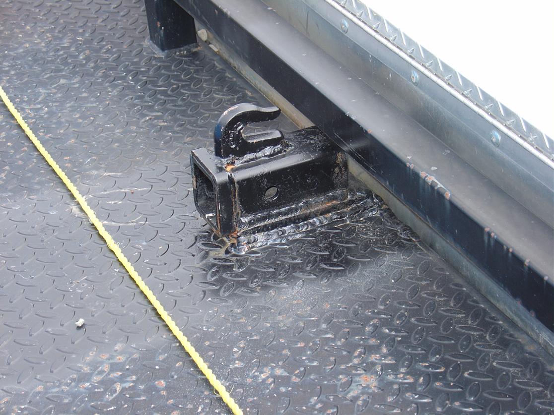

    I did something like this for a car hauling trailer for use with a portable winch. The winch mount was put on AFTER this water tank monstrosity was hand winched on with a come-along. Ugh.

    Here is how it looks on a metal bed. Underneath is a piece of tubular steel welded in for reinforcement.
