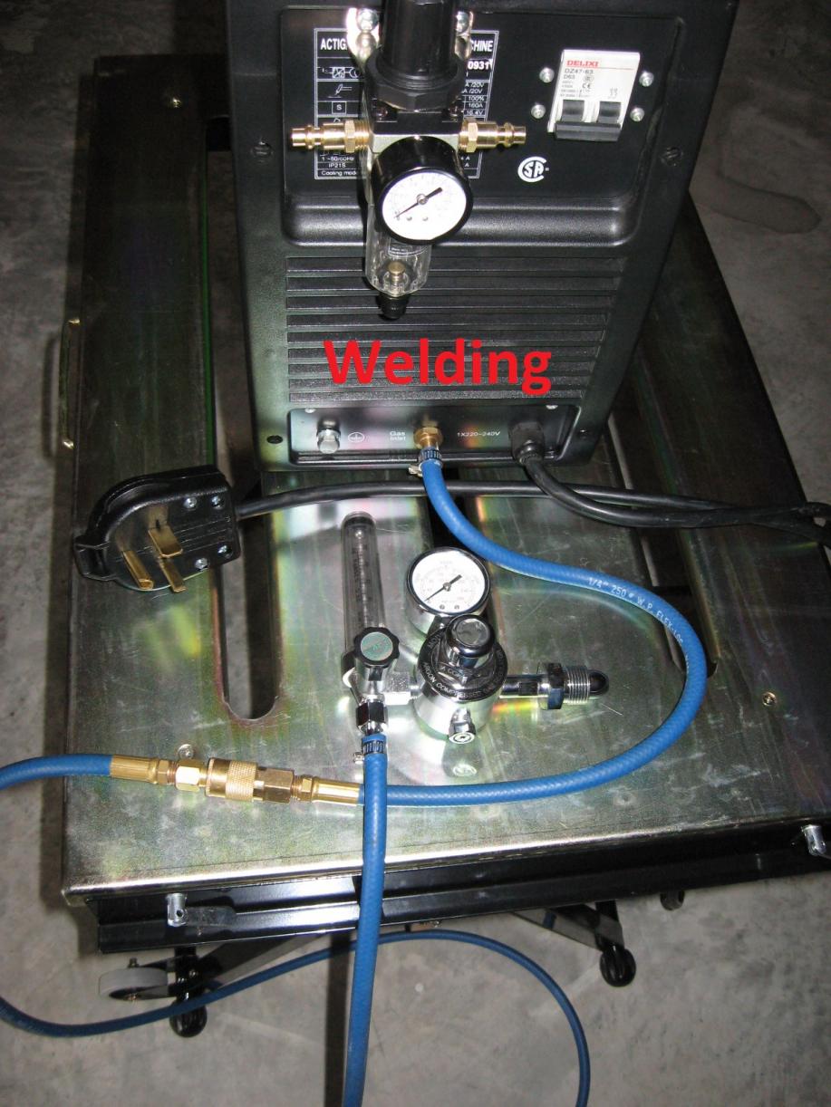

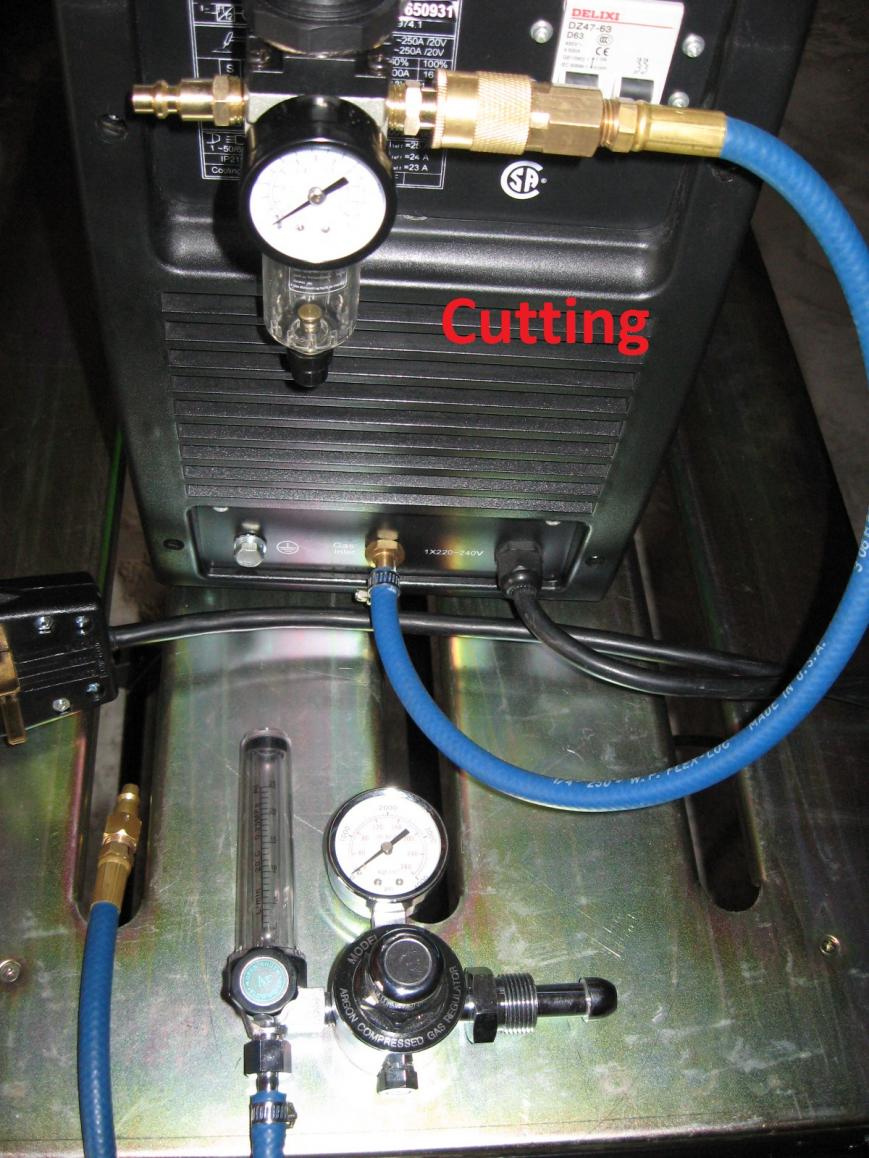

    This setup only takes a few seconds to switch and it's cheap......Click image for larger version.

    Definately looks like your having FUN! People actually steal grates out of a car wash!!! man they must be desperate!! i`ve got a set up close to what zoama has for switching around the lines, i do some out of shop repairs and usually don`t need the regulator so at least i can keep it home and it dosen`t get banged around!

    Thanks Zoama! I can do that, so off to Ace hardware tomorrow! ; )

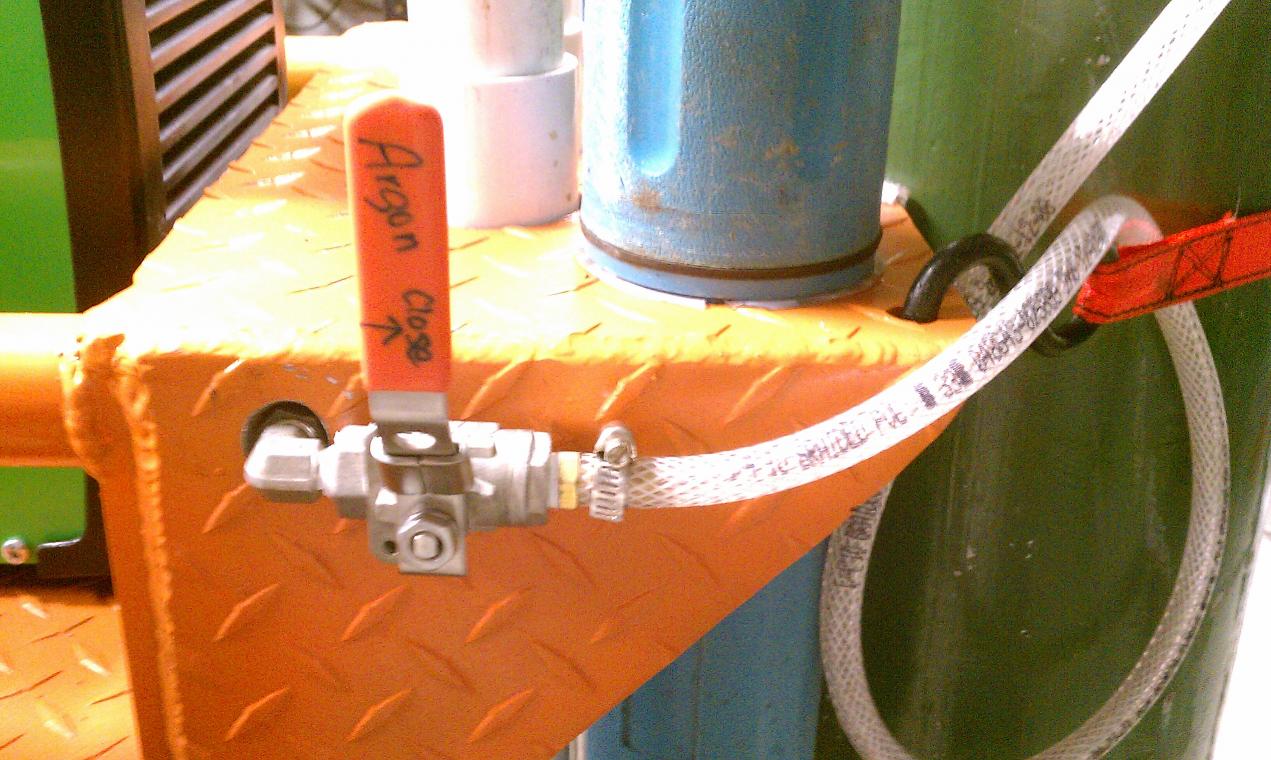

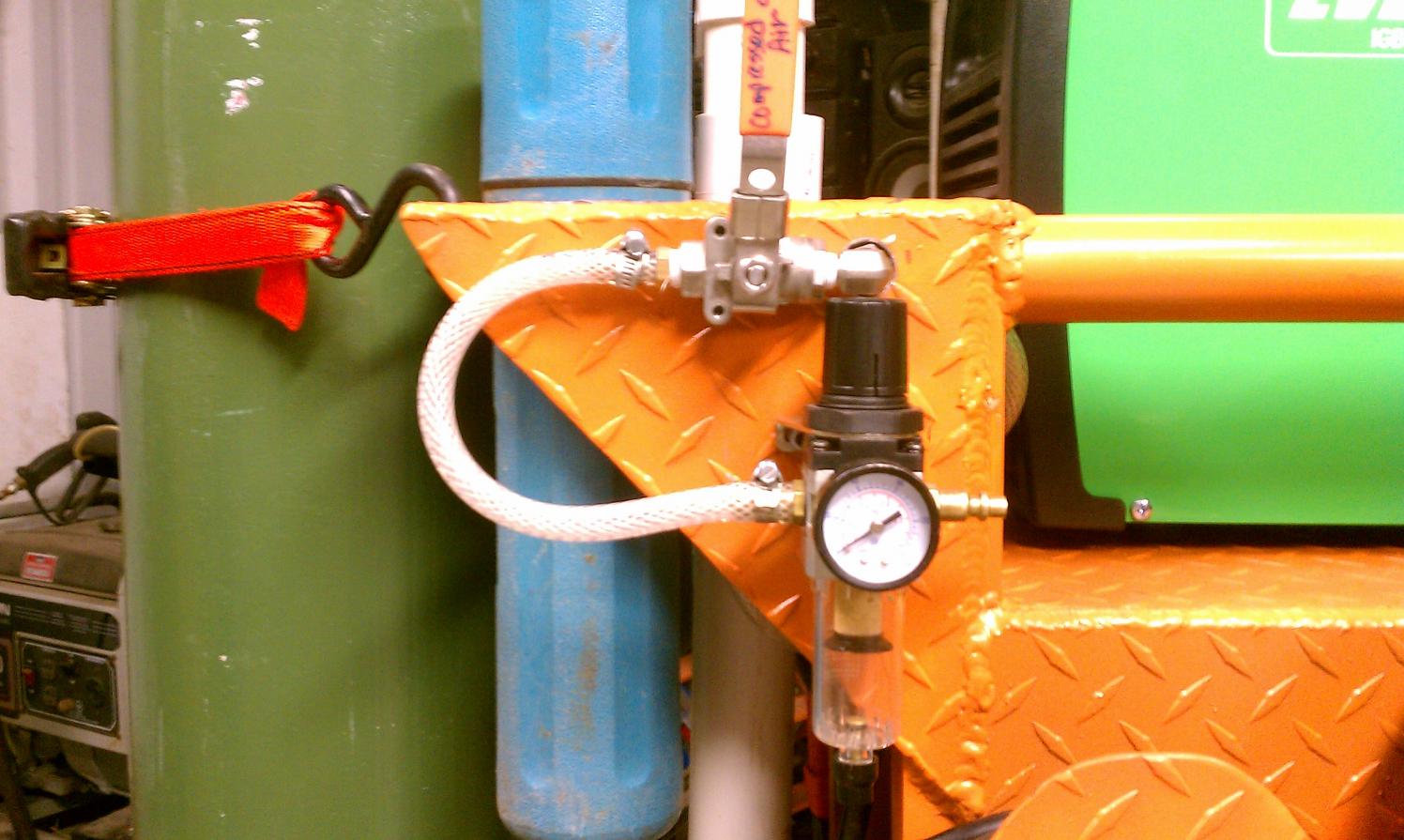

    Just my two cents but this is how I set mine up with a valve for each then going to a T then into the machine
    Open one valve close the other and add ur air line for plasma. Simple and no swapping everytime. ;-)

    No problem I will pull my machine back and post more pics tomorrow of how my cart is setup.

    If you go with quick couplers get the ones with a larger inside diameter,(like 3/8"). A lot of the automotive styles are only about a 1/4" inside diameter. This can restrict the airflow to the torch and cause it to burn up. The local home depot here carries both styles.

    Only reason I use the valves instead is over time the orings inside of the quick connects leak
