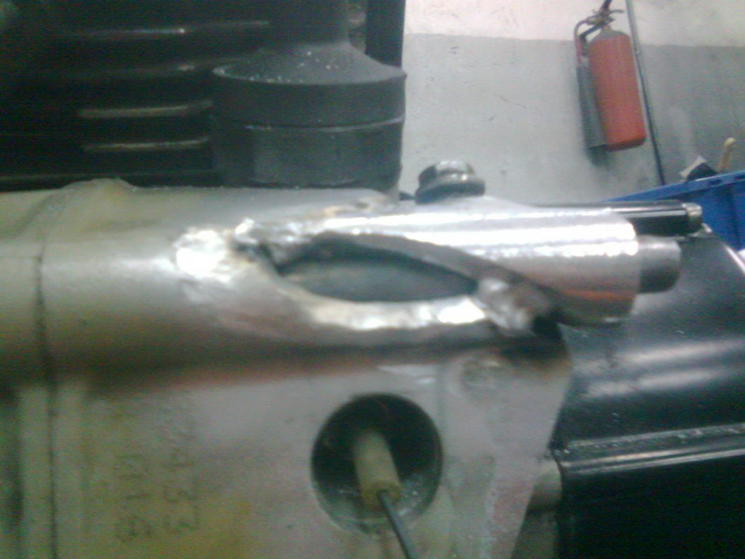

    I have friends which are fond stuntriding
    Оne of these days they brought to me the motor from (DUCATI) with the broken fastenings, and plaintively asked me everything to repair.
    Guys any thoughts, councils

    The PP256 should be able to weld it. Is it cast aluminum?
    I'd throw it over the hill.
    If I were going to attempt a repair, I think I would split the cases, do a complete teardown, then machine off the mount.
    I would then machine a tube with an undersized hole (so that it would not take quite as much heat as a solid bar) and try to weld the new tube in. Then re-machine the hole.
    Tell them it will be at least 15000 RUB to do the job. If that doesn't scare them off, have at it.
    It could be done. You have some parts that look like you'll need to be careful about overheating nearby. Controlling the heat soaked into those parts, will slow down the repair, but it still can be done. But you could either "vee" out the crack and re-attach the broken piece, or just build up the missing metal with filler rod and machine it down to desired surfaces afterward, (or more likely a combination of both) using AC-TIG. Either way, make sure there is no dirt or grease at the surfaces you are welding before you start joining the metal together. Check for clean surfaces with a light AC-TIG arc - when it leaves behind a white etched, surface everywhere, it means it will weld cleanly. Black crusty surface anywhere = clean those areas some more before you start welding.

    Thanks sportbike,jakeru
    I told them approximately the same(but they speak that engine dismantling is a full ###)
    from friends I don't take money,It is necessary to strain and create a miracle
    I think to weld the broken out piece and to strengthen it an edge from aluminum,and to the place of a missing piece to turn the aluminum bushing, to cut it lengthwise and to try to adjust a half to a relief of a missing piece and weld all
    Tomorrow I will start to conjure

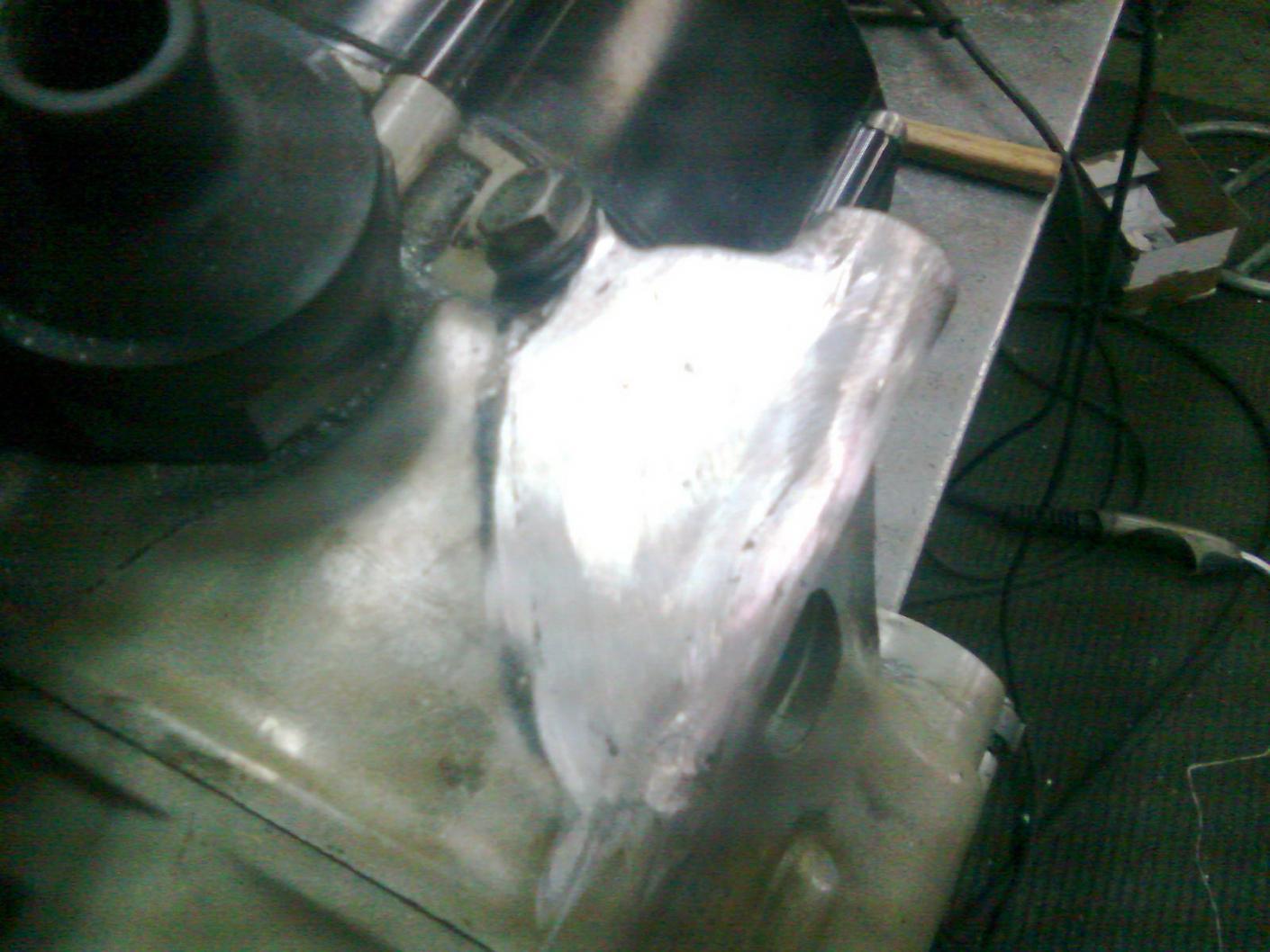

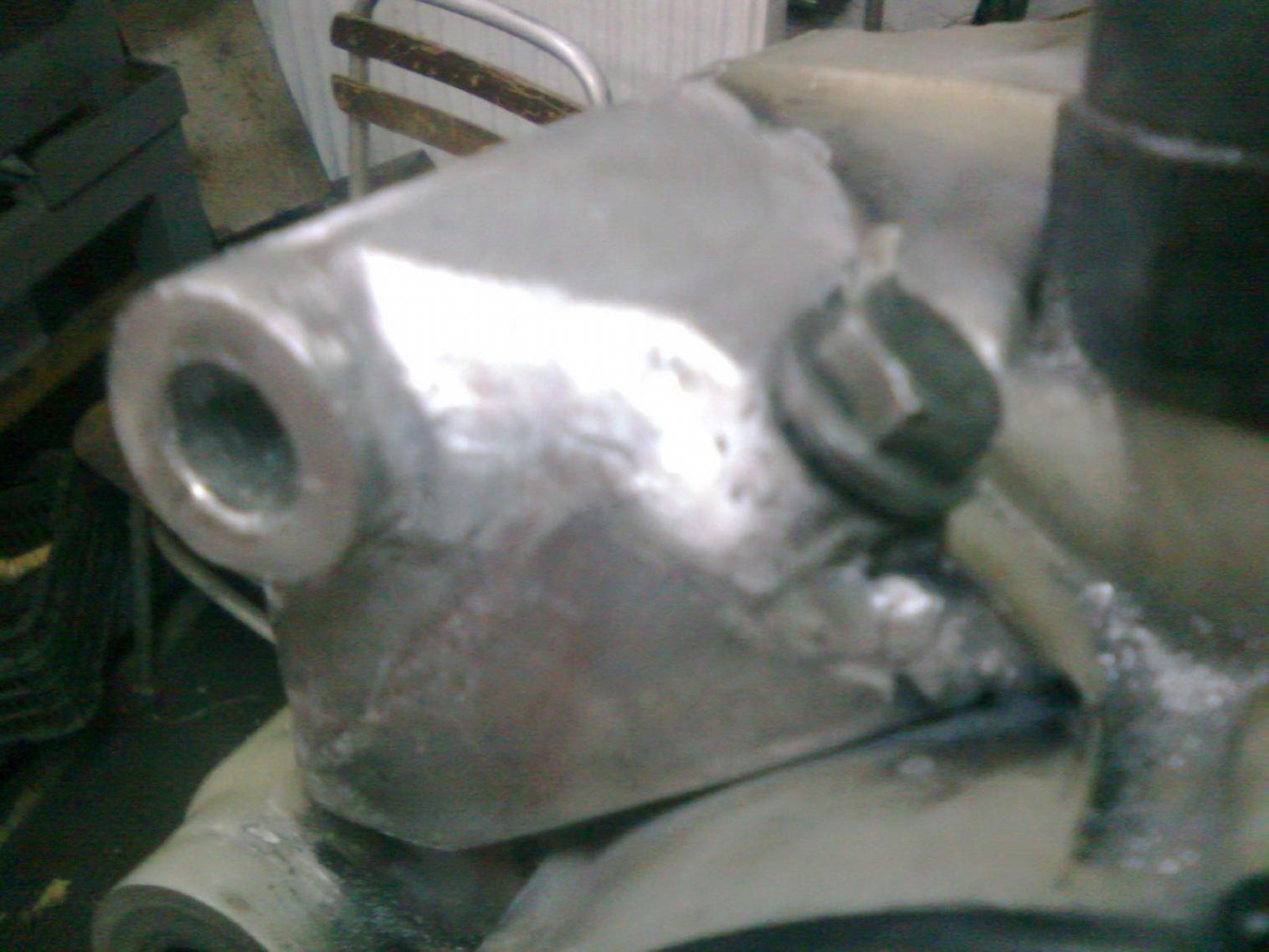

    All was not too hopelessly . Work is made, client is happy

    Looks good. Is that a piece of fuel injection rail that you used for the repair piece on the left side
    Did you use your Powerpro 256 welder on this?

    Very nice job. Get a little dirt and grease on there and I bet you almost can not tell it was repaired.
    Is the motor pinned on the frame? I do not see threads and not a bike guy? Or does a pin go all the way through?
    Good question from John, did you use the PP256? 4043?
    Ducati's use a 10mm bolt that runs the whole way through the frame and engine.
    John
    For restoration of the left part necessary to me half of bushing in diameter of 1 inch (25 mm) with an internal aperture of 31/64 inches (12.5 mm).
    For economy of a material I have cut a piece of sheet aluminum in the thickness 3/4дюйма (20мм) have drilled in it an aperture with displacement, into an aperture have inserted a suitable bolt, have drawn in a nut, and all this design have processed on the lathe.After processing on the lathe workpiece has cut it lengthwise.The missing piece is ready,At welding I have passed through an aperture a rod in diameter of 31/64 inches (12,5мм) on through.
    It is a pity to me that I don't know English language , and I know that to you very difficultly to understand that that I have written with the help Google translator (excuse) therefore I will support with drawing I hope all will understand.
    Mike i use the PP256 and 4043
