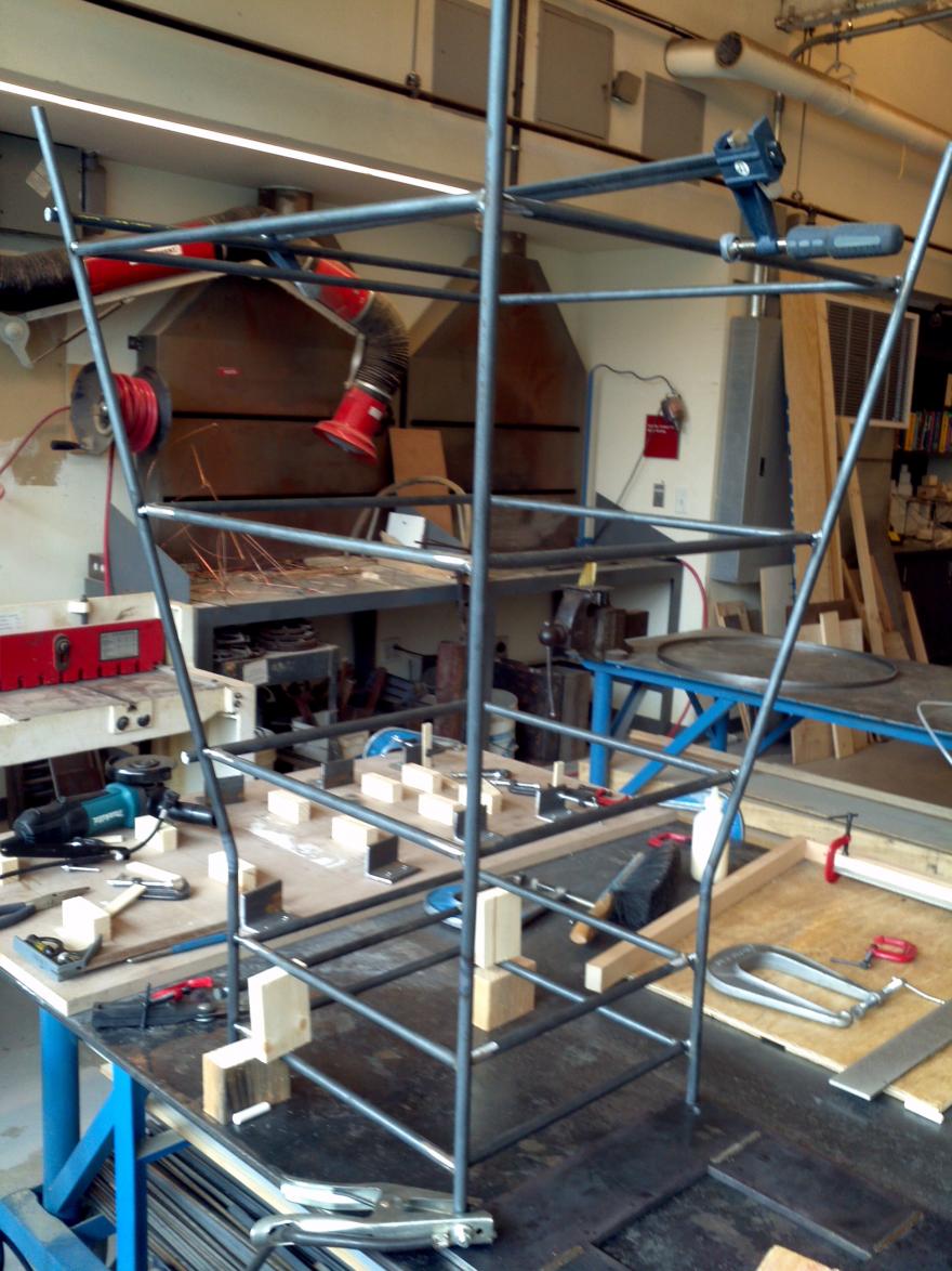

    This is a new sculpture that I am currently working on. It is very experimental to say the least. The first photo is of a smaller model that I made in the past from silver soldered 3/32 tool steel rod. The current structure that I am welding is made from 1/2" mild steel. I will be posting pictures of the jigs that go along with this project. There is a good chance that I will be making multiples of this same piece, so having the templates ready to go will make it easy to duplicate in almost exact standards.
    Ignore the top part of this piece, I am just focusing on the steel stringers for this project.

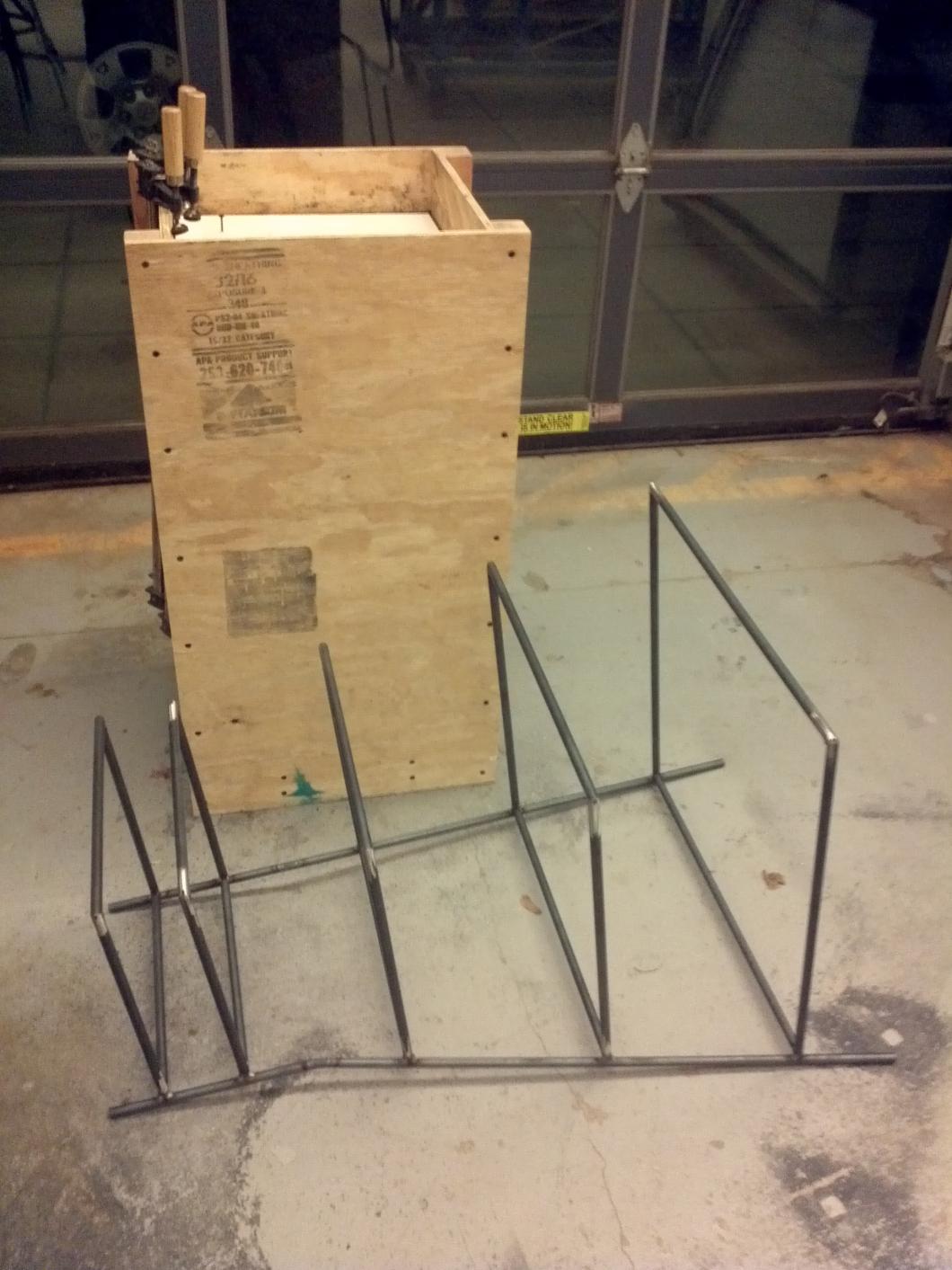

    I must have been excited about this actually working, because I failed to take photos of the final two uprights being welded, and the final piece all tacked up on the jig.
    So, the final two squares were welded at 90 degrees, nothing special. Once off of the jig, I set up to make the other bends. This will in turn make the angled squares and the 90 degree squares parallel. I used an oxy acetylene with a rosebud torch for quick heating. Both sided were heated and the bend was made slowly. I checked the distance between the squares as I was going, once the piece was parallel, I knew I was at the correct angle.
    The material support was used as a guide. I would lower it slightly, heat and bend till it made contact, and check my measurements. The bend was taking place right at the edge of the table.

    I worked my way up the piece. Sometimes having to make spacer blocks to keep the bars parallel. Overall, it worked out. Not as seamlessly as I had dreamed of last night, but hey I can't complain. So here's the final shot of the structure all tacked up and ready for some finish welding. I think I'll save that for another day. I've got a few other projects burning that need some attention too!

    I started adding clamps everywhere I could. I don't want this to warp. If I can minimize this in another way, please let me know.

    So I tacked everything in and ran some beads. It's cooling at the moment, and I cranked down on the clamps pretty good. There doesn't seem to be any movement or warping yet.
