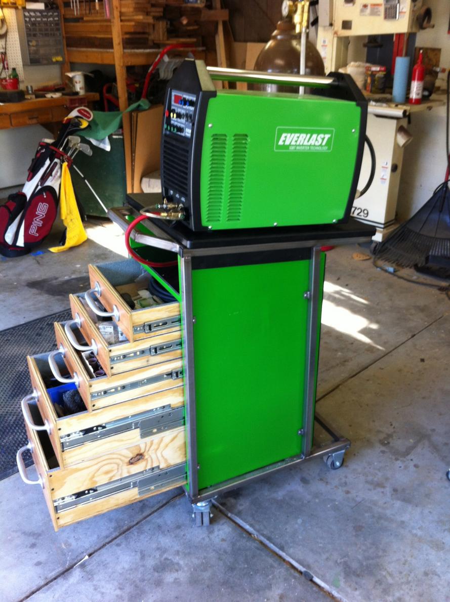

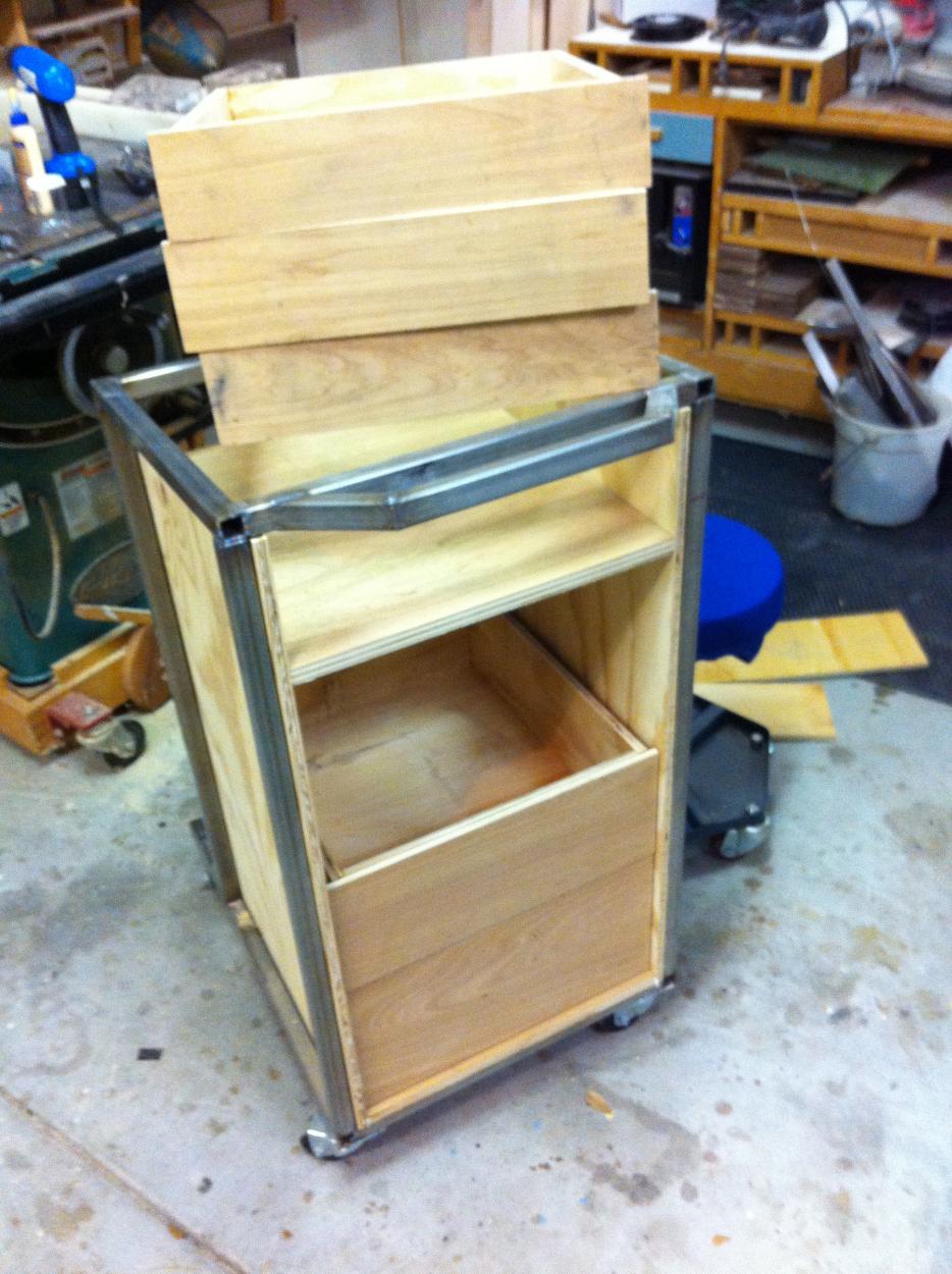

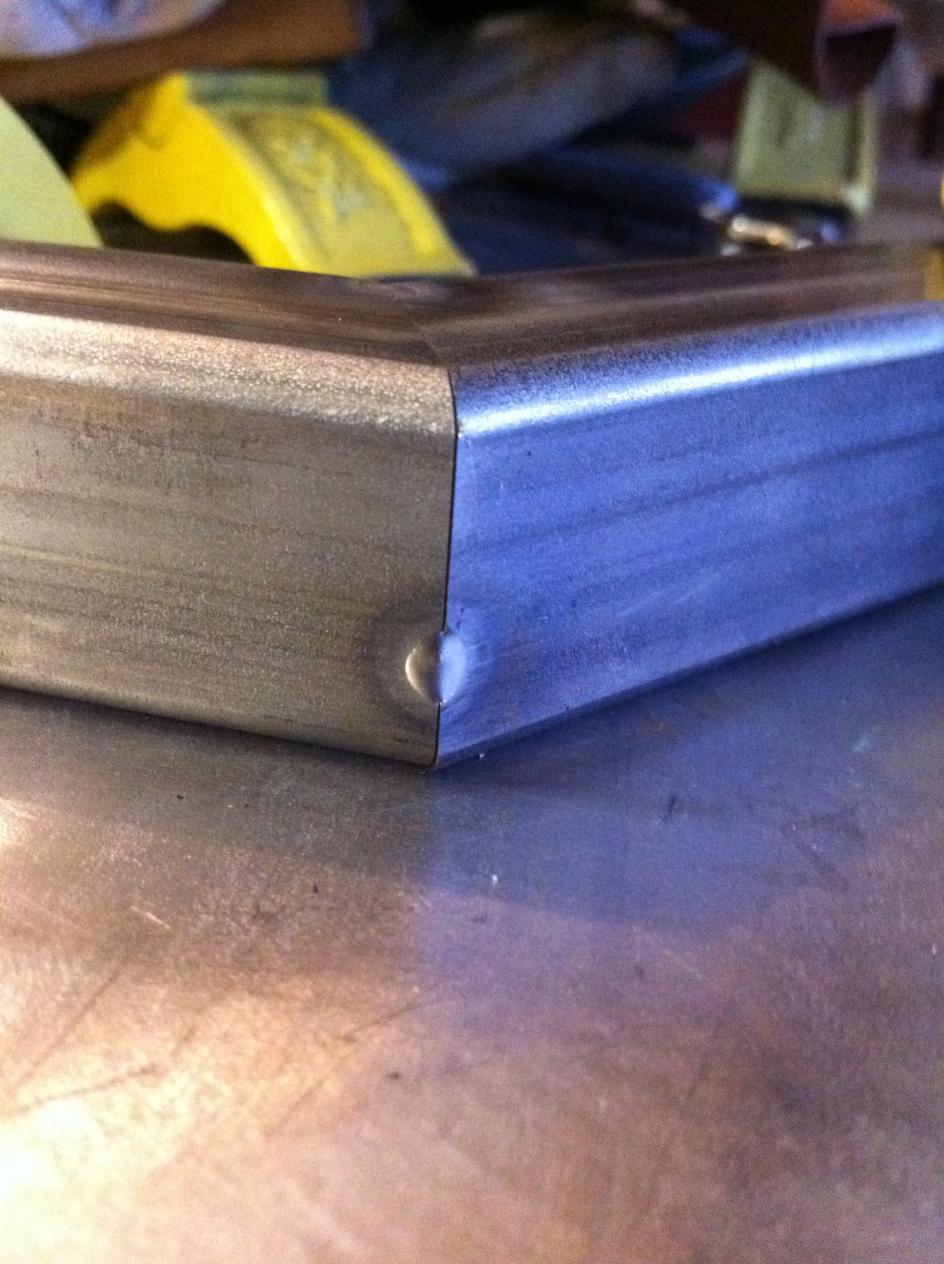

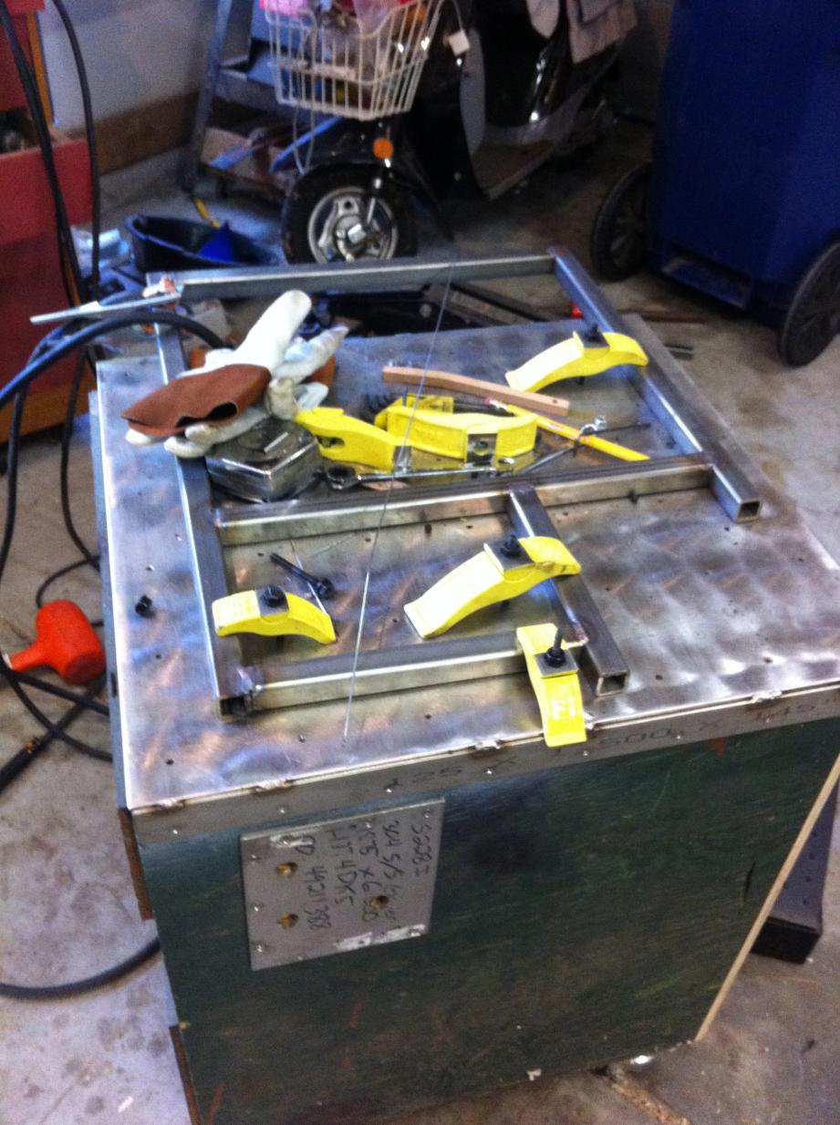

    My weld cart took longer than I planned, but its finally finished.
    My idea on a cart was based on space (the smaller the foot print the better).
    So the foot print is 20" wide by 25" deep and 40" high with a drawers on the bottom for storage.
    I used 3/4 stainless square tubing for the frame. The pictures show I'm using my weld table
    to clamp the pieces and keep everything square.

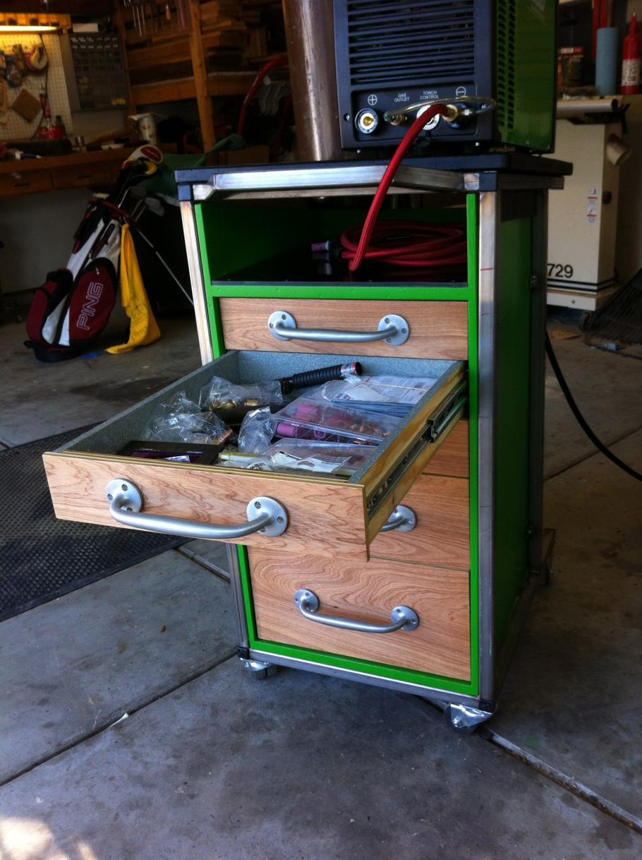

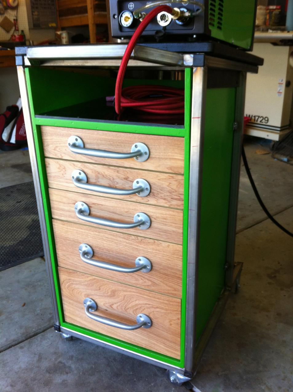

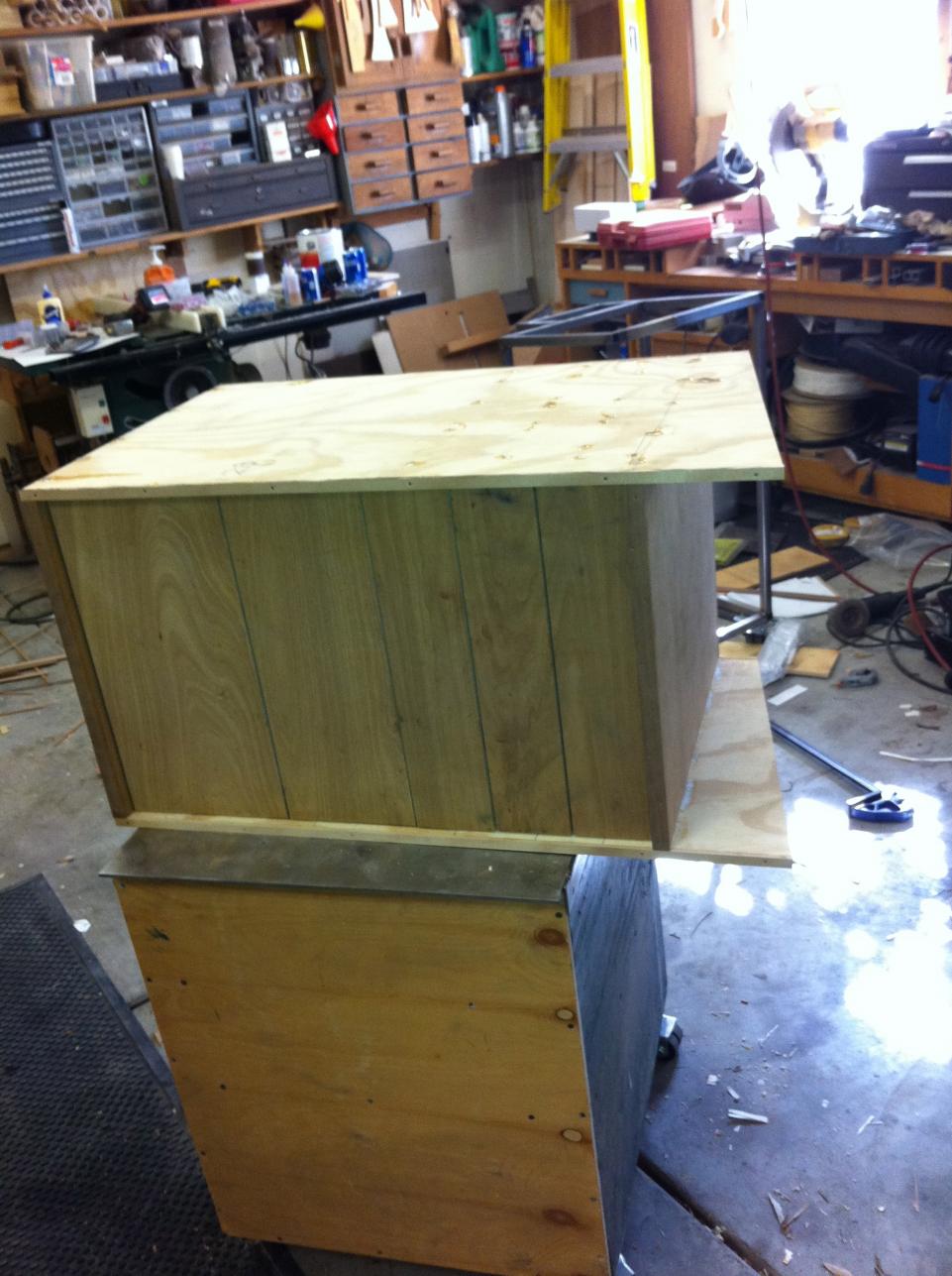

    Pictures of the front handle and the wood cabinet

    Cabinet and drawers

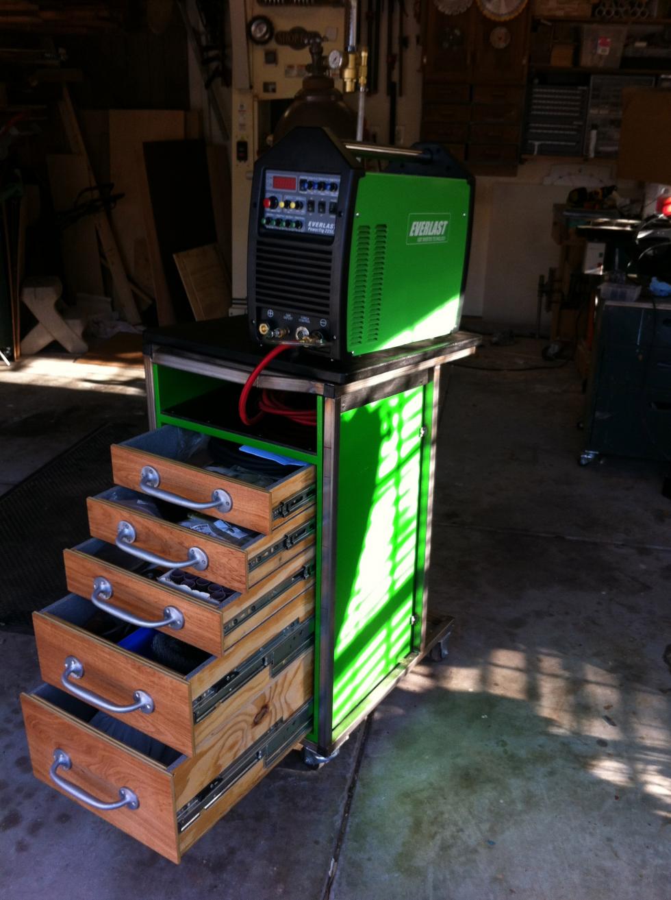

    Finished cart!
    5 drawers for storing grinding and welding stuff. (5 drawers wasn't enough room,
    filled the drawers rather quickly.)

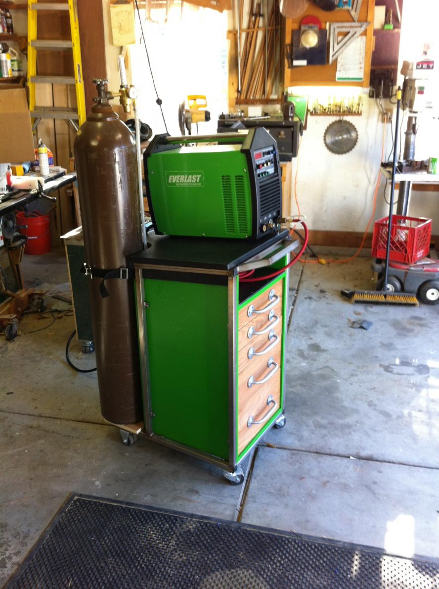

    I designed the cart for a 180 cubic foot argon bottle
    and I'm stuck with this monster bottle and it doesnt fit the cart. (Praxair only had large bottles)

    My wife made a cover. Notice the bottom front how its cut out.
    I can leave the cables plugged in with the cover on.

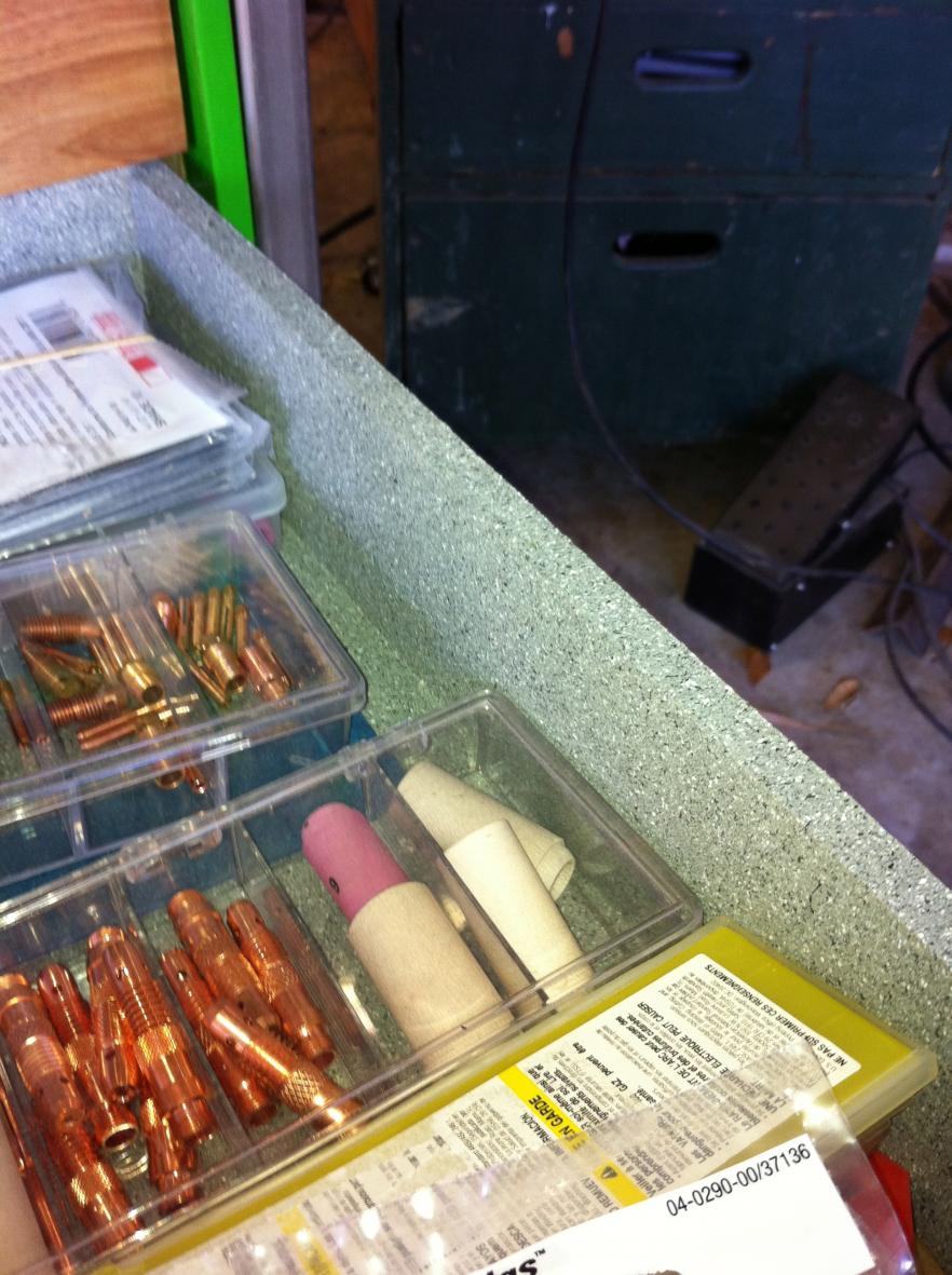

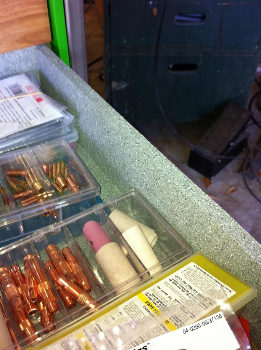

    Spray painted the inside of the drawers with granite looking spray paint. Dont waste your money!
    In the end the cart works great. Wish I had more storage but I did the best I could
    with the space.
