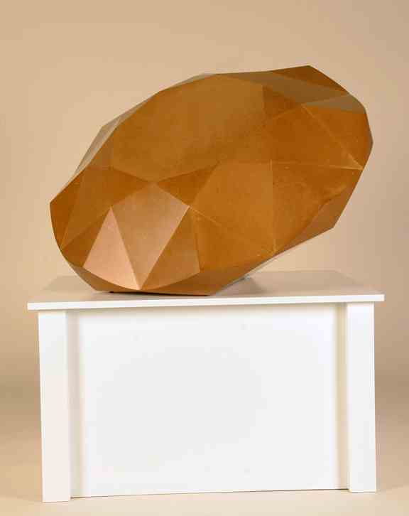

    Here's pictures of two big fake diamonds I made in 2011. I followed an old Belgian diamond cutters manual, Diamond Design, by Marcel Tolkowsky, published in 1912. I was using his recommendations on geometry and proportions for "correct" cuts of modern brilliant round diamonds. In my attempts, this is what happened, they are not correct in form, but as a generic form, they still read as diamonds. One diamond is made from 1/2" mdf, and the other is made from 3/4" knotty pine plywood. Both are fabricated, hollow forms.
    Here is the diamond on a table I also made, the diamond wasn't finished yet, it was bare mdf.

    Here's some final shots of the mdf diamond, with a satin polyurethane finish. I made the table specifically for the diamond for display purposes.

    How heavy is that? I wonder if anyone ever tried to steal it. LOL Looks like a gem from the photos.
    I can pick up the diamonds without too much straining, they are more bulky and awkward to handle than they are heavy. If I had to guess, the mdf diamond might weigh about 60 lbs. I am about to load up two pictures of another diamond which was made from thicker plywood. That one might be about 80 lbs.
    Hopefully there won't be any theft, it'd be hard to justify the value to my insurance!

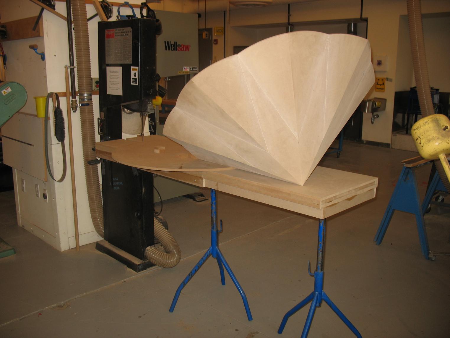

    Here's a detail of the cross members installed in both the top and bottom halves. Notice the hole in the center of the intersection. This is to hook into a circle cutting jig I made for a bandsaw. It was the only way I could figure how to create a round diamond, without racking my brain even harder in the geometry.

    To make the diamond round, I had to fabricate a circle cutting jig for the wood bandsaw. I made an extra large support table, because it was just me at the time in the studio, and I didn't want anything to slip. The large table also enables up to 7 foot diameter circles to be cut. In this case, the diamond is about 42" in diameter. Notice the scalloped edge on the bottom half, that is what I am trimming off.

    Here's a detail of the locator pin. It serves as a point to revolve around. In this case, the center hole on the diamond's cross members from the earlier photos. I had to make a few tries at locating the pin just right, see the last photo, just before the cutting was done. I purchased the aluminum track for the jig, but had to fabricate everything else, including the mount for the center pin.

    I am a part time sculptor, and some of the objects I like to make are based on engineering and old world designers (this one being Marcel Tolkowsky). This project, which will hopefully wind up in a gallery at some point, serves to keep my mind busy, and to also make attractive objects that other people will enjoy. I hope the viewer asks why I chose to make these works.
