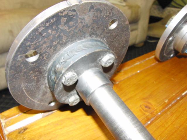

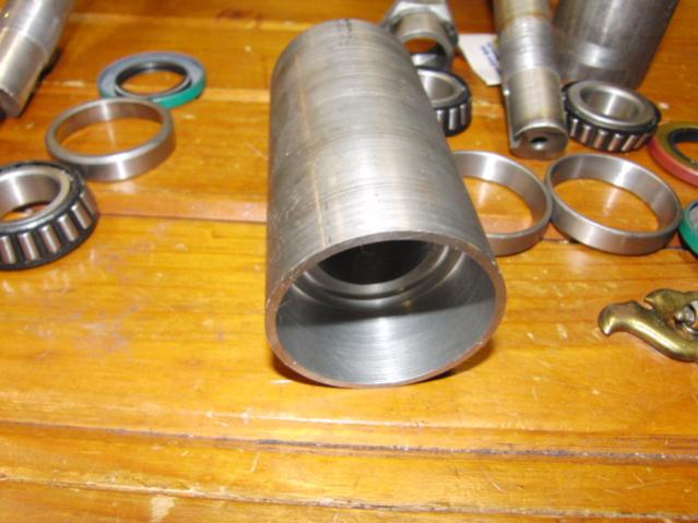

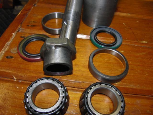

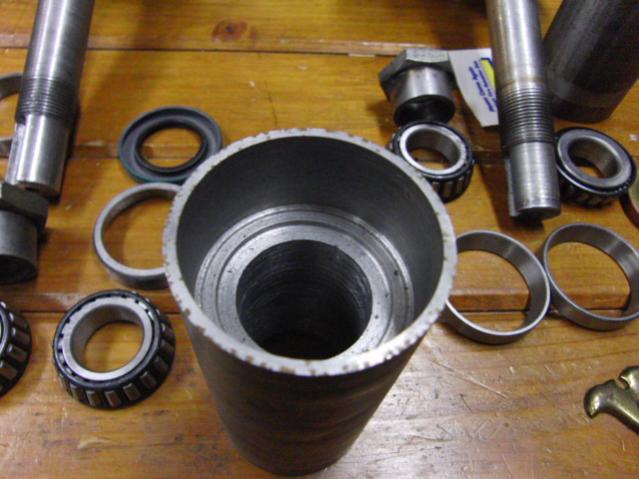

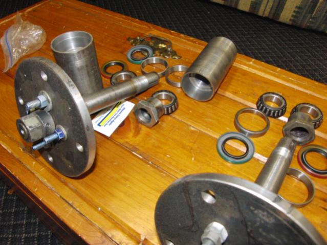

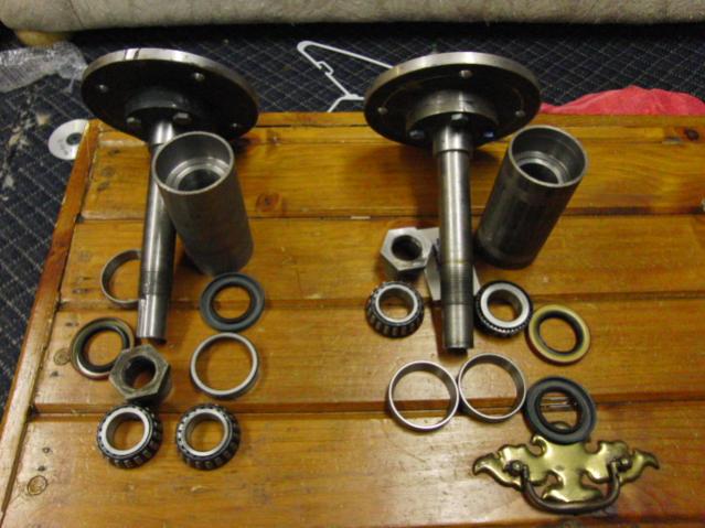

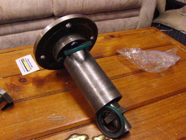

    I have been working on these hubs for over a year. They are for a project that I started over 3 years ago right after I graduated high school. I got a Suzuki gs550 engine off of ebay and started building a go-kart frame around. 3 years later, I have learned so much that I realised that using hot rolled square tubing wasn't going to cut it. Currently, its all in limbo. Im trying to decide what I'm going to do with the mess I created over 3 years.
    Hub. The main shaft is made form 8620 alloy steel. I want to have them case hardened so the seal doesn't wear out the shaft. the outer housing is a piece of unknown alloy steel that was about 2.25'' in diameter. I know from welding in a mis-drilled hole in another project that this alloy is hardenable. It cuts kind of like a grade 8 bolt. I made a custom boring bar to cut out the center to size. The bearing are just trailer bearings. The hub fits a standard metric ATV tire. I believe its a 115 mm bolt pattern. The driven side of the shaft has an adapter that goes form the 7/8'' shaft to the 1.25'' universal joints i have.

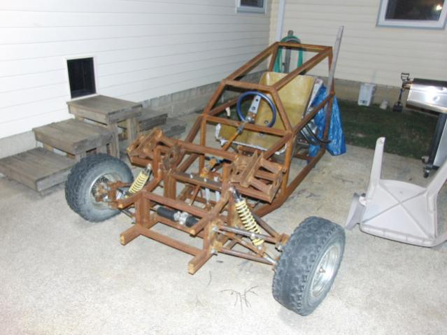

    I wouldn't call it a mess... looks like you've got some time invested there.. good job!

    Wow, look at that double a-arm front suspension! I'll bet you have learned a lot working on this.
    Have you looked at formula SAE racecars? They have some very cutting-edge designs, for a similar size vehicle and powerplant. They run on paved surfaces, not off-road.
    A rear independent suspension, combined with adding triangulation to the frame, will open the door to tuning the suspension and making it handle more predictably, whether you intend to use this on paved or off-road application.
    I checked out the formula SAE cars. That is pretty much what I had in mind when I started this project. I liked the idea of being able to run on concrete and then change springs and run on rough dirt. Now that I have thought things over, I think I'm going to try and finish what I have started.

    I happened across this today and I'm asking myself "why haven't I started my project like this yet? You will have one hell of a fun toy when finished, no matter where you run it. As far as the heat treating for seal wear, ask yourself:"will I put enough miles on this thing to actually wear it out?" The reason I say is that typically in a situation such as this, you got a lot of more important things to worry about than whether a seal is going to wear a groove in 5,000 miles or 50,000 miles. If you see yourself getting 20,000 miles or more out of it, go for it. If not, don't sweat it, unless you just want to do it for a learning exercise. Either way, nice job!! Keep us posted.
    ESAB MigMaster 250-borrowed
    Purox OXY/ACETYLENE
    Thanks hooda! I've decided that unless I acquire the proper heat treating equipment, I'll most likely end up screwing them up. They should be plenty strong the way they are now. If it ever becomes an issue, I'll redesign them and make it better.

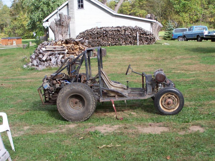

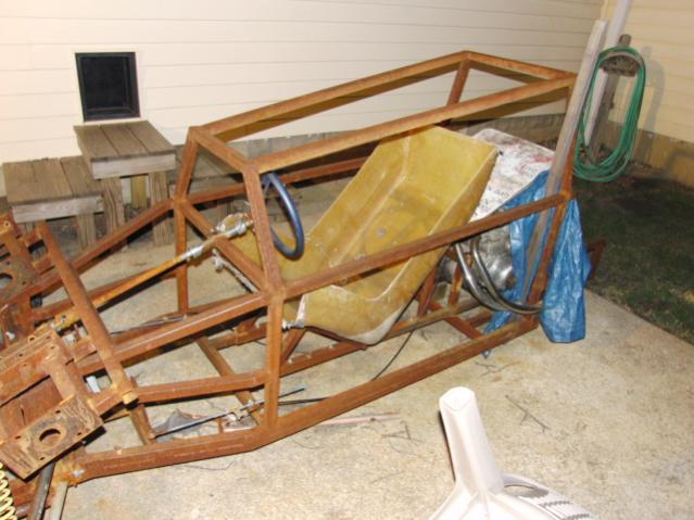

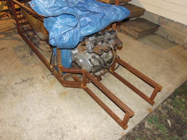

    Any thoughts for a roll cage? Or is it wide and low enough that it doesn't need one?
    It has most of one now. Here are some fresh pictures of it. Its finally warm enough for me to start on it again.

    The motor is mounted to the frame. I had a solid axle before and was able to drive around my dad's yard. It was pretty quick for how heavy it is. I am really tempted to scrap the current frame and get some real DOM tubing and follow the same design. I really like the flow of the frame. It has a mean stance. I will keep the same Indy/F1 style independent dual suspension.
    Whats amazing is how I realised just how little I knew when I started this project over 3 years ago. I'm waiting until I have a garage I can keep it in. Having to work on it outside just kills my motivation and plus you never know what the weather will do here in illinois. If you dont like it, just wait a few hours, cause it will change

    You made a good decision designing in the front suspension like you did. Every thought about changing the solid axle in the back? Would be more complicated but might make it worth your while.

    Another option if you are concerned about seal wear, is to just use hub savers. They are a very thin hard stainless steel sleeve that presses on to the wear area. They are meant to repair hubs with deep seal grooves worn in them. Since you used standard trailer bearings, I'm sure you can find them. They also use the same type of system to repair harmonic balancers on engines with seal grooves worn in them. They are thin enough that you can use the same size seal, it will just have a little more tension on the slightly larger diameter shaft.
    I would leave the square tube frame rails and cut off everything above the frame rails. Build you a round tube cage and let her eat! There's a lot of race car frames built from mild steel; if you build it right it will be safe. I would look into some type of external reverse transmission, like the ones used on heavy trikes or Honda Gold Wing. It will be a pain in the but getting out to push it backwards. It has a cool factor fo-sho!
