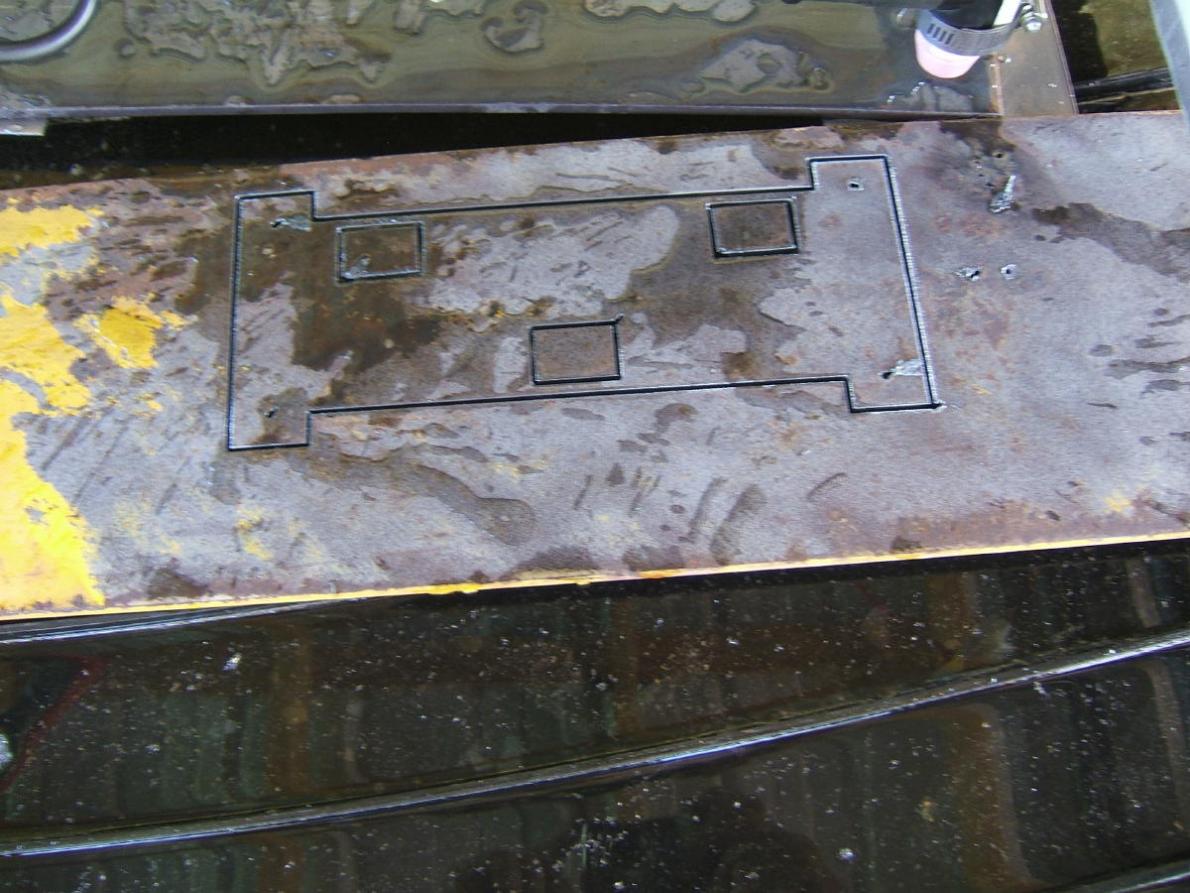

    Here are some pics of some hinges I tried cutting yesterday. I'm not sure what happened if the plate moved, but the holes were suppose to be on the hinges. I'll work out that problem later! I hope to get some time tomorrow and see whats going on with the THC not reading the arc voltage.

    Are you running that off a generator?
    It doesn't look like the torch is doing a touch off, to set the start height at each cut. I can't see if it's even doing the piercing at the larger height. I think it crashed into the metal and lost position at about 0:52. Unless your metal is perfectly aligned to your axis, you are gonna need that THC to make it work right.
  20. #240
    I may not have it set right, but it starts off sitting on top of the material. When it starts it does not touch the metal after it moves from 0,0. I am not running any limit switches.
