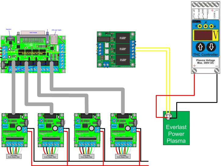

    I'm using the relay only to turn the plasma cutter on and off. The yellow and black wires (top circle) on the breakout board are for my THC. Your diagram makes perfect sense. I was thinking backwards.
    Where do I wire the torch output on my pp60c? I was thinking that pins 1 and 2 being the start and stop took care of firing the torch.
  2. #202
    Pins 1 and 2 on the CNC plug should fire the torch, so they are the two that connect to the relay board. The relay board is for outputs only. The breakout board has both outputs and inputs.
    Where do the two black wires go to that are on the top right of the relay board? (the outputs of relay 3) What do you have wired to the inputs of your relay board?
    Which breakout board do you have? Nevermind, I just figured out from your picture that it must be the PBX-RF.
    Since your THC will provide the arc signal, you won't need those pins in the CNC plug. So the only other thing you need is the torch output from pins 5 and 7 to go to your THC. I'm not sure if you have sorted out the voltage because of the internal resistors. I've been reading too many plasma build logs, so I lost track of where you are with that. Your THC needs full arc voltage, but the PP60 has only divided voltage and full with two dropping resisters in series. You might have to do some internal work to make that work. I guess you could pull full arc voltage right from the front panel connectors, but it would be nice to have that all bundled in the CNC cable.
    I tend to work one piece at a time, so I would get the torch working under software control, then start in on setting up the THC after that.

    OK, got some good news! I called Probotix and Jeremy helped me get going (in theory!). The doctor says I have bronchitus or maybe pneumonia (waiting on the xrays) so I can't do anything outside in the heat. I spent about 15 minutes on the phone and he should have me going. I've learned to ask people for help over the years, and in doing so I learned I made a simple but funny mistake!
    The front of my control box there is a 110v plug and I plugged the walwart from the relay into the plug. It turns out that is why the first two relays came pre-wired. The plug is for a spindle so the relay can turn it on. I plugged the walwart into my power strip and the green LED's lit up! I did have a couple of things wrong in MACH3. After I plugged up the relay the right way he took me to the diagnostic screen and had me click the spindle control tabs and only the mist relay would turn on and off.
    We went back to ports and pins I had the enable 1,2,3 boxes enabled (green checks). I should have had the outputs 1,2,3 boxes enabled (green checked). We cleared that up and now all three relays are clicking and in theory the plasma cutter should turn off and on.
    I had to get out of this Mississippi heat. If I feel better tomorrow I may try to cut some hinges for my smoker that I desperately need to finish.
    On a side note I asked about the LED's because of the advice from the earlier post, and that help get things going in the right direction. I felt that it was something small. I had to laugh at myself for using the spindle plug for the relay power!
  8. #208
    Yeah the LEDs are really put there for troubleshooting, and are very handy. Much more so for things that don't click like relays. I was thinking about what you could be using the 3rd relay for. That's the problem with stuff that is pre-wired, you don't really learn what is going on. By using 4 axis drivers, you lost the ability to have the ribbon cable from the 4th axis to the relay board. That was a clean setup. I wasn't sure about how you had your inputs and outputs configured on your breakout board. I'm glad to hear you have it all sorted out. Will you have enough inputs left for limit switches? Are you using the Arc Good signal from your THC to an input?
    Because of the inline resisters inside the PP50, you may have an issue with your THC not seeing full arc voltage. As long as it's in the range it can control, it will function fine, but what is displayed might not be the actual voltage.
    I started a sketch of your wiring If you have Visio I can send it to you to finish out.
