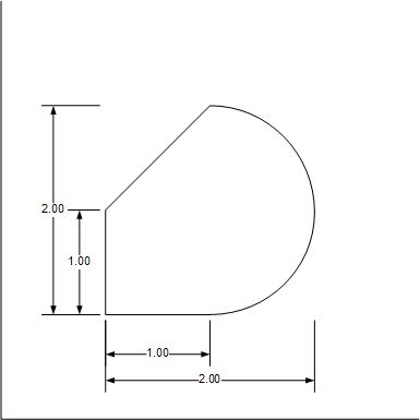

    Here is a simple part that uses the basic moves, so it's easy to follow what is happening. There are no Z or torch commands, this just moves the table around.
    Here is the part:
    And the
    Code:
    (With zero in the lower left:)
    G0X0Y0 (Rapid to zero home position)
    G1X0Y1F20 (First line vertical @ 20 inches per minute)
    G1X1Y2 (Angled line)
    G2X1Y0I1J1 (Curved line)
    G1X0Y0 (Last line horizontal)
    (With zero in the upper left:)
    G0X0Y-2
    G1X0Y-1F20
    G1X1Y0
    G2X1Y-2I1J-1
    G1X0Y-2
    (With zero in the middle:)
    G0X-1Y-1
    G1X-1Y0F20
    G1X0Y1
    G2X0Y-1I0J0
    G1X-1Y-1

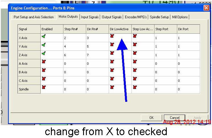

    You may try changing the setting for the motor direction see attached.
    That will change the motor direction for its axis. This is in Mach 3.

    I have a felling that I will probably have to end up changing the motor directions if want the bottom left corner to be 0,0. I did a little playing around this afternoon until it started raining. I was going to make my first real cuts until the rain. I also need to get my slats done, right now its a pain trying to strategically place a piece of metal on the table.
    I have the machine set 0,0 in the far right corner. This allows the cnc to move in a positive direction. The Z axis I have set +0 is the torch dead on the table. Any negative -1.-2,-3, etc has the torch moving up (safe Z).
    I still have some motor tuning to do, it sounds rough because the IPM are pretty low. When I jog the table using the hot keys everything sounds fine.
