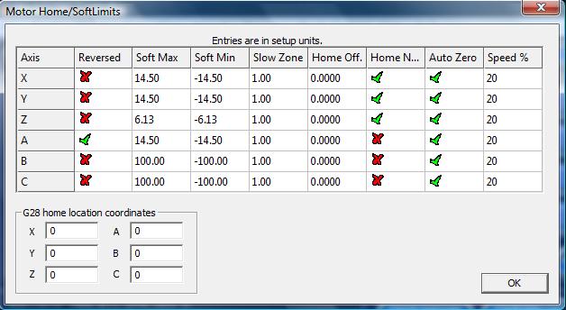

    I got everything together, but I need some help. The Z axis runs up and down like a champ. My X and Y axis are having some trouble moving. When I hold down the hot keys the gantry moves about a 1/4" X and Y. The Y axis is slaved (I have 4 motors) to the A. The gantry moves fine without the motors. When I mount the motors the gantry moves fine without power to the motors. When I power everything up tell it to move it sounds like it's in a bind.
    I tried increasing the acceleration and that did not work, and I am not sure what I need to do.
    I am using this configuration.
    Slave settings
    http://www.needfulthings.net/shopdro...ay;threadid=13
    Motor tuning
    http://www.needfulthings.net/shopdro...ay;threadid=81
    http://www.probotix.com/downloads/ma...creenshots.gif

    First thing I would do is pull the motors off, mark the gear positions, and do some small moves to verify that they are in sync. It sounds like you might have them out of phase. Do you have four motors total or five? What I mean is are you using dual motors for both X and Y? You might want to include what you refer to in the other forum as without joining no one can see any of that. Some better pictures of your setup might help, too.

    OK, all the more reason to pull off the motors and verify rotation and phase. It could be something as simple as reverse rotation.

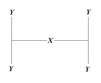

    Stepping motors are not like normal DC motors. There are uni-polar or bipolar designs for two or more phases. This is what gives them there steps. It is possible to get the phases wired wrong so that the motor will not move properly. This is often hard to tell when running the motor at speed, but is obvious when moving a step at a time. That is why you can either mark the gears or what I do is attach a big cardboard wheel to the gear, then you can put marks on it for distance and direction, and easily compare two motors to make sure they are moving the same amount. I have not seen a photo that shows how your motors are mounted, so it's just a guess. I've seen a lot of dual motors for X but only single motors for Y and Z. I would guess that most of your pairs are mounted so that they need to run in opposite directions from eachother. This means that you will need to reverse one motor from the other, this can be done with either hardware or software.

    I may be wrong with this but if you have the software set just like in the probotic screen shot, you do not have 4 motors programed.
    If that is the case you should only have problems with the slaved axis as one motor is holding and the other driving. That shold only cause a problem for the slaved axis the other should work. Have you change the velocity.
    Set them low like 100 velocity and 40 acceleration (acceleration should be 1/2 velocity settings).

    I think there may be a slight communication problem, too. Typically the long axis is the X and the short is the Y. From what I can see your X axis is a dual motor setup and I can't see the Y or Z in that photo. And those two motors do need to run in reverse rotations. Be sure that they do before mounting them.

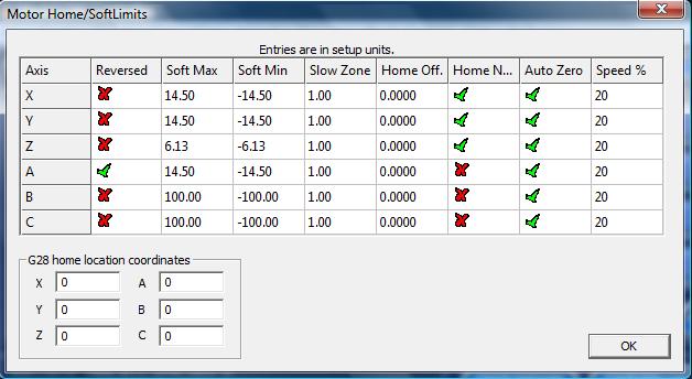

    Here is the diagram I followed.

    I'm wondering if the acceleration is too high. I had read where someone had suggested starting low and then going up until the axis stalls out.
